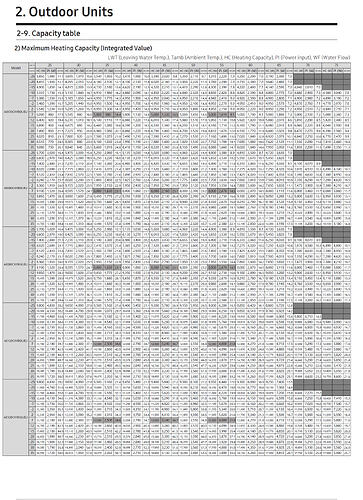

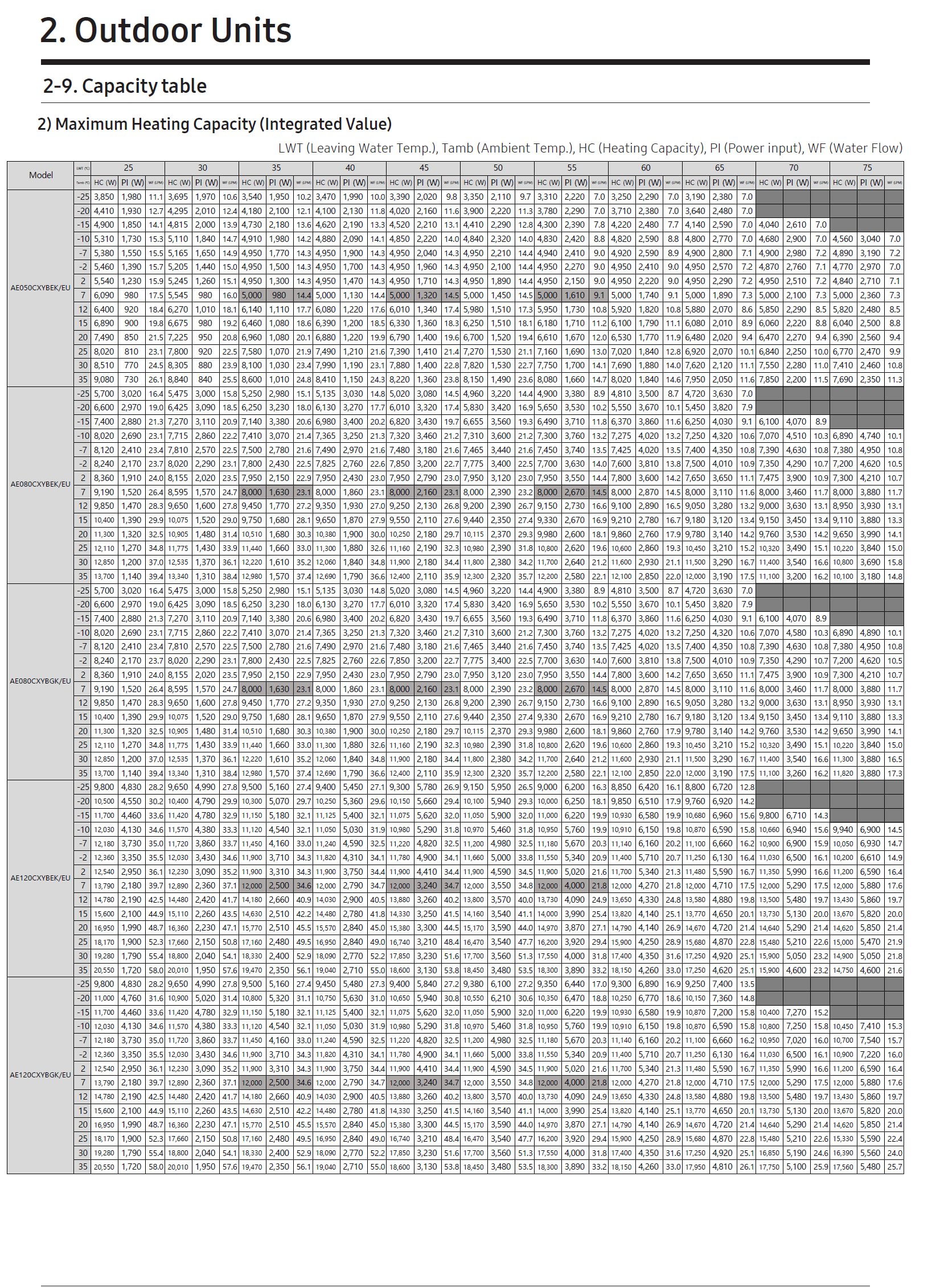

Not from personal experience, @peggleg (I have an 8kW HTQ), but have a look at Table 2-9 in the R290 Technical Data Book. It’s too large to upload here, but here’s a screenshot of part of the Table
You will see that the heat outputs (HC) vary significantly by LWT and OAT, and these numbers apply when the compressor is running at 100% speed (motor inverter frequency 50Hz). But I don’t know the minimum inverter frequency programmed into the R290 series controller. If I did, I could estimate heat output in proportion. For example, if it was 20Hz, I could multiply the above Table figures by 20/50 = 0.4 to get the (approximate!) minimum heat output. By way of reference, the minimum frequency on my HTQ is 20Hz when OAT < 7degC and 14Hz when OAT >7degC.
There are a few Gen7 owners on this forum who monitor their controllers. Maybe one of them can tell you the minimum inverter frequency, or if all else fails you could email the Samsung UK Tech Helpline at [email protected] (contact Nick Kirwan).
