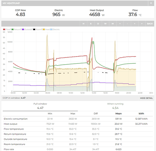

Seems you still don’t understand how it works. I will try to explain it. It’s funny since I’ve realized this as we went through this discussion :slight_smile:
If pump uses thermostat it still tries to follow the heating curve you have set. So you have started at 6 and everything was cold and around 6:30 the pump reached the point on the curve. But you can see it will continue to operate infinitely until it won’t get the command from thermostat to switch it off or you manually turn it off like you did 6h later.
BUT, this does not mean your pump is able to maintain the target flow temperature. In fact it is not and you can see it from the graph. Since 6:30 it is constantly increasing the flow temperature (not sure what is that drop at 7:00) while maintaining the minimal power input (in low power mode the pump is less effective). This way the compressor never turns off!! It will constantly raising the flow temperature slowly until it reach the max. allowed temperature for heating water. This would meat at this point you would have a spa in your house. Look at 12:00 - the air temperature is higher than it was at 6:00 but hey, your flow temperature is higher than it was in the morning while it should be less… Hope you see now that your pump is NOT able to maintain the flow temperature at given outside temperature. Therefore you have to turn it off by thermostat or manually.
This is difference between indoor mode and weather law. In indoor it heats constantly and only limiting factor is max. allowed water temperature. In weather law it simply stops once the temperature is above the target flow temperature. And this is what I was referring to but not that this is not normal, it is for sure, but the problem is that pump stops only for 3 minutes before it resuming operation and this causes heavy cycling. This is the main problem of weather mode of this Samsung unit.
So conclusion is, in mode you use you will hardly see any cycling but this is same for me if I use this mode. For example now it is running for 3 hours and my target flow temperature when I’ve started was around 33C ad 10C outside. But now it is still working but with higher flow temperature (35C). But since this is producing more heat my thermostat sooner or later turn off the pump. So as you can see I also can run for 6h only with less efficiency…

Just for information and from observation. It is really interesting how the pump works in “indoor thermostat” mode during warm weather.
Now it’s 12C outside and the unit is running at 33C of water temperature constantly ! (it’s funny that in weather law mode it cycling like crazy, there must be something wrong in the controlling logic). I’ve simply though it can’t work because it delivers so much heat but seems this is not the truth and obviously it can deliver 2KW constantly!
But way how it is running is interesting. It runs at minimal compressor input of 700W and it can’t go lower. This is the bare minimum for compressor to work. BUT, the fan is barely spinning! It is almost stopped. This means it maintains this very low water temperature but with pretty low efficiency. I’m getting COP like 3.15 only at 12C. I have this COP normally at 0C!
Wow… So radiators are almost cold and the heat losses are spot on. BUT, the price is pretty high for this since at 12C an 35C water I should have normally (when compressor is running at nominal speed) COP of 5.7! So it’s pretty inefficient and would be better to run at 40C water for better efficiency!

Seems it can down much more to 2KW but with lower efficiency. COP3 vs COP5.5. 4KW is probably at fan spining fast :slight_smile:

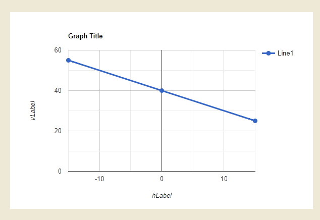

If you really need this @Michal_S can’t you set #2012 to 0degC, #2011 to -15degC, #2022 to 40degC and #2021 to 55degC? Or am I misunderstanding you?

Thanks. I think you misunderstood me because doing so I would have for 0C 40C water, for -15C 55C water but for +15C I would be somewhere around 25C. You can set only 2 point with this Samsug. For some reason I’ve set #1032 to 37C but it’s completely ignored by the pump. It’s still running according water law.
What I need is:
From +15 to 0C … 40C water temperature
At -15C i need 55C water temp.
With your settings it would be like this:
And I need this:
The reason for that that mine radiators are able to deliver 40C water at 0C with pretty good COP of 3+. But if there is 15C outside mine COP remains almost the same because pump is working currently at 33C at minimum compressor and FAN speeds which is very inefficient. I need to be able to deliver more heat in shorter time to get better efficiency.
What is ridiculous and prove that Samsung is stupid to be honest that it shows me eko level 4/5 which indicates it’s running very effectively. But the reality is it checks only if outlet temperature is above or bellow 35C. If it’s above I have 3/5. If bellow I have 4/5. It completely ignores compressor and fan speeds. Funny. Would expect more from Samsung engineers.
UPDATE but when I’m thinking and looking again that curve is also not OK because it’s very steep so with modbus i need to program in a way that until 0C outside it works flat at 40C and if it’s colder it will use -10C/50C and 15/30C. This way I can get what I want… Plus maybe I will program some real weather compensation on sunny days… Seems lot of fun I have.

But for your information, the water law curve is not extrapolated as you showed in your first graph. Look again at the diagram on p22 of the User Manual. Above the #2012 value, the LWT line is horizontal. So in your case if you set #2012 to 0degC and #2022 to 40degC you will get 40degC at any ambient temperature above 0degC.

Oh really ?? Wow, I didn’t realize this! So thank you, I will go and try it immediately. Jesus, how stupid I look like now :face_with_peeking_eye:
@SarahH Oh well, seems I’m not that stupid, I cannot set #2012 to 0C since minimum is 10C :frowning: I knew there is some culprit. Why they even limiting this for god sake ?
Well spotted Michal, I hadn’t noticed that limit in the small print. Sorry :face_with_diagonal_mouth:.
Yeah, at least I’ve realized it’s not extrapolated as I’ve thought. This is pity it’s limited like this because it would resolve all my issues. I really don’t understand these stupid limitations of parameters. What is it good for?? I thought these parameters are for “expert” and no ordinary users who will never figure out how to access them so Samsung should assume we know what we are doing.
So since this won’t help mi as 10C is far high outdoor temperature seems really the only option is modbus with some programming allowing to monitor parameters real-time and change heating curves on demand.
