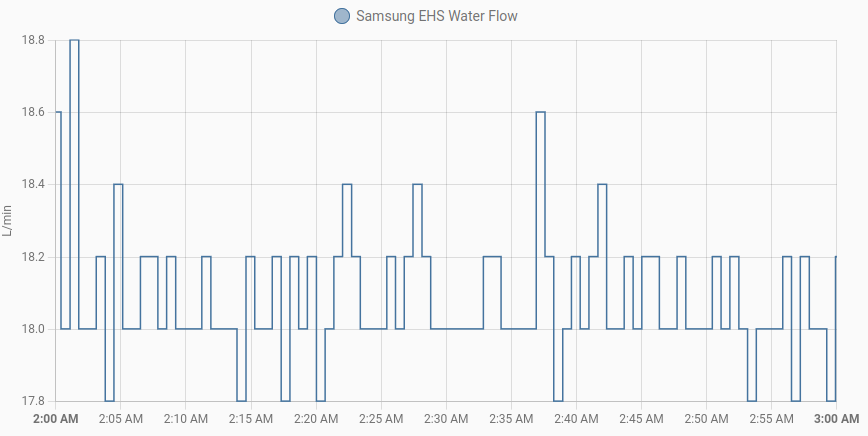

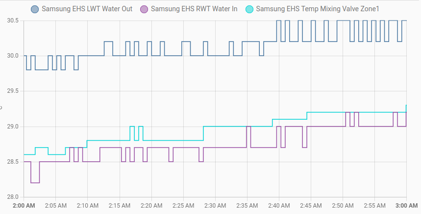

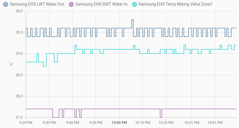

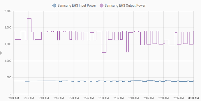

Here are some data, I’m trying to have a compounded graph:
With flow limit set to 100% (18L/min in my setup):

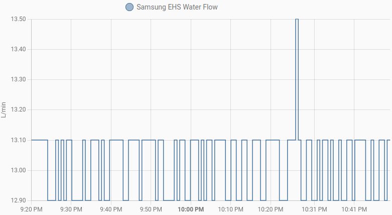

With flow limit set to 70% (13L/min in my setup):

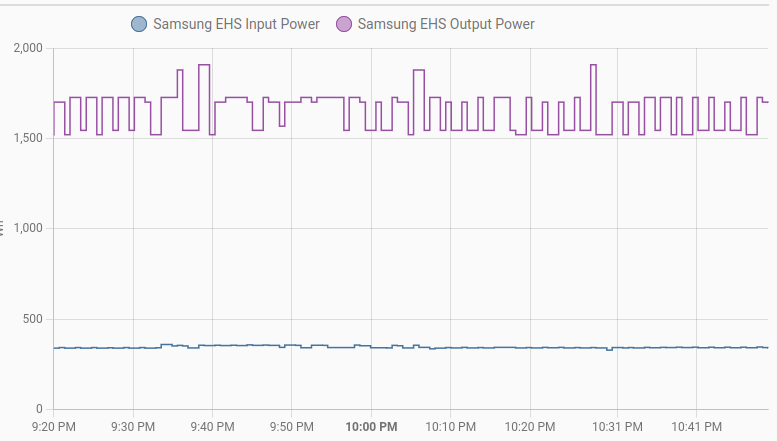

I don’t have a clean CoP display yet, but you have the averaging 1min consumption.
What I observe is that the global CoP raises faster with 13L/min setting than with the 18L/min setting.
Currently I’m trying the 7.2L/min setting too (I also wrongly set the setting to 0L/min, and it ended up in a raising LWT to 55°C (for 5 minutes) before I corrected. Therefore I’m sure the setting is not overriden by the ASHP, even when it’s clearly wrong).
Thanks @Topaz, very helpful outputs.
Your 100% PWM output looks like HP input ~400W, output~1750W (i.e. CoP ~4.4) while at 70% PWM output it looks like HP input ~350W, output ~1625W (i.e. CoP ~4.6, about 5% difference). Where did you get the CoP ~5.5 from?
Edit: I calculate that your (m.Cp.deltaT)s are very similar for the two cases. Assuming you have an ASHP, and that the fan power is included in the HP power, I wonder whether the fan was operating at a higher speed in one case than the other (the fan draws ~100W at full speed, so any reduced speed may account for part of the measured input power difference).

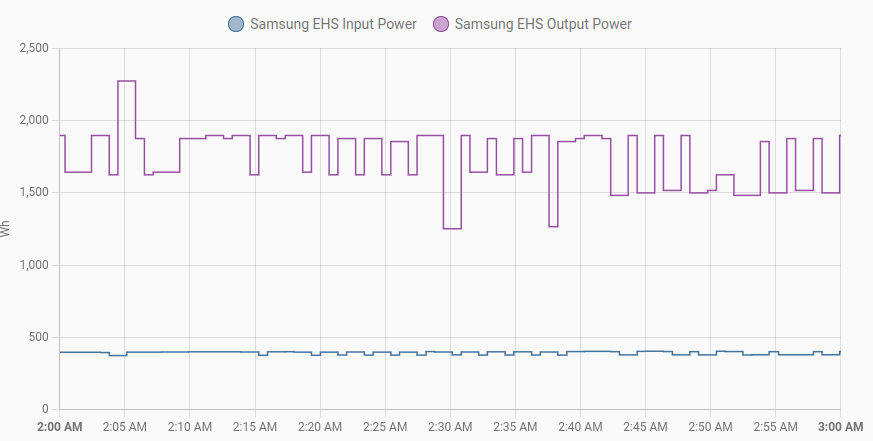

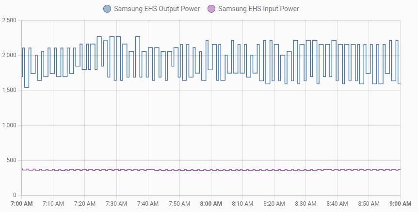

I’ve been collecting new data this morning, and performed an averaging of value
Here is the input/output powers
Flow and temps are the same as yesterday’s graph
The average input is 356W, the average output is 1960W, giving us a CoP of 5.5.
The only problem is that I have yet troubles to explain physically why is the CoP higher with lower flow rate when I consider the system as a whole (I only understand the local computation of output power from flow (LWT-RWT)1.162flow_liter_per_minute*60).

I think that there’s something a bit inconsistent in your data, which perhaps you can clarify. Your output power has risen from about 1650W (your previous graphs) to about 1960W (today’s graphs), yet you say that flows and temperatures are the same. Something must have changed… :thinking:
Also I’m puzzled by your
This should be Heat generated (W) = (LWT - RWT) (degC) x m (litres/min) x density (kg/litre) x Cp (J/kg/K) / 60 (s/min). If your fluid is water, at ~30degC density is 0.996kg/litre and Cp is 4180J/kg/K. Where does the 1.162 come from?

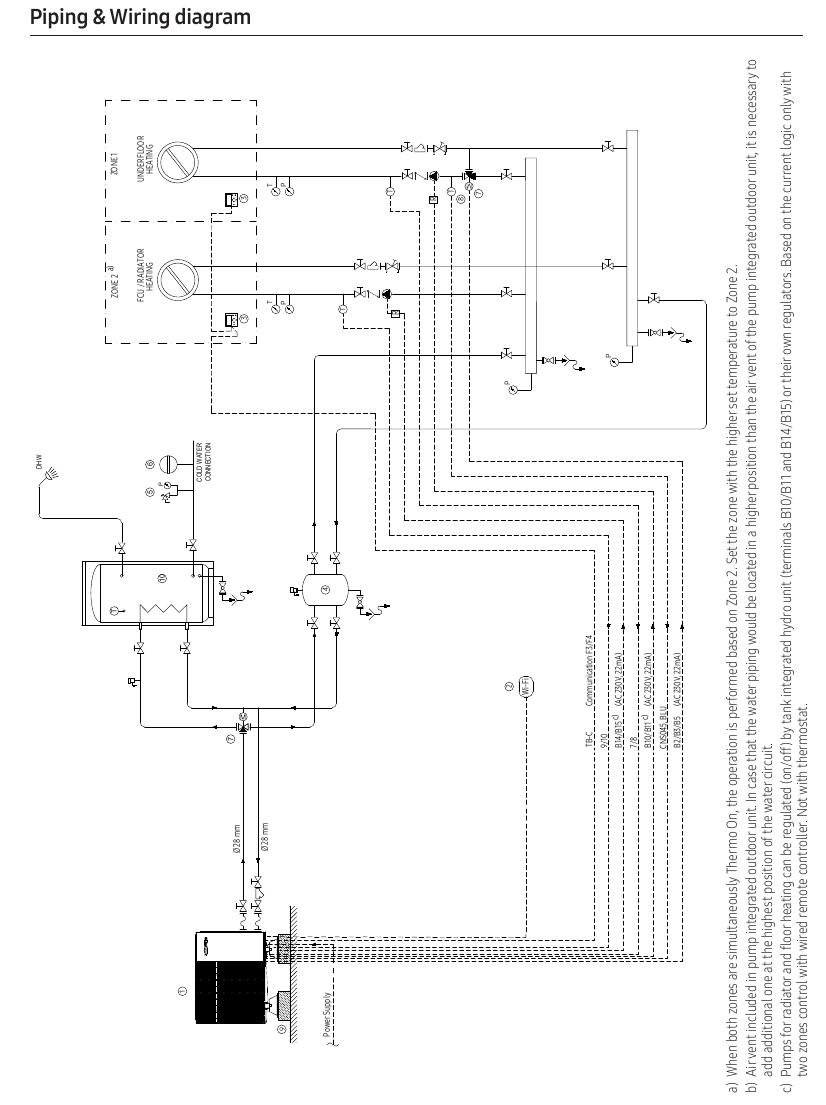

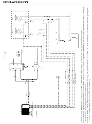

Is your set-up similar to the first sketch in https://midsummerwholesale.co.uk/pdfs/quick-start-guide-samsung-gen-6-kits.pdf (except that there are two secondary pumps - one to and from your radiators and one to and from your UFH)?
If I was you, I would be fairly relaxed about your CoPs - they are very good already, and probably all you can do to improve them more is to keep reducing your LWT (as long as the house remains comfortably warm…).
Sarah
My setup is similar to the first schematic of https://midsummerwholesale.co.uk/pdfs/quick-start-guide-samsung-gen-6-kits.pdf, I do have 2 secondary pumps in my case. I actually used the schematic from the Samsung installation manual which is very handy to avoid loosing track of the wires to be connected.
I’m still quite bothered by the PWM limit and its impact on the CoP, but I guess I start to understand something real simple, like measurement and accuracy, temperatures and with 1 decimal, so is the flow. Therefore, when flow is higher, temperature tend to be lower, amplifying their error in the output power computation formula. Maybe this is where the ā€œmissingā€ heat was hidden. It can represent up to 2 times 0.1K when dT is 2K, this is 10% error!
