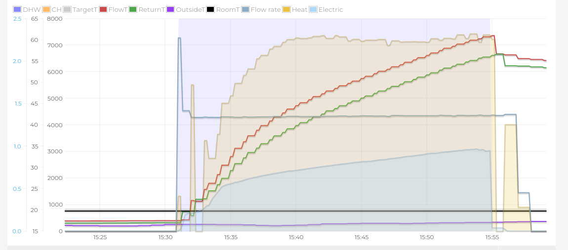

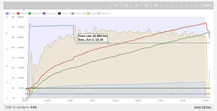

I donāt see how this fits with Ianās comment. I have double checked by looking at Ianās flow rate. On 28th March at 15.28 his flow rate is 28.3 L/min and at 17.08 it is 14.6 and at 21.12 it is 13.1. The flow temperature was never above 36C.

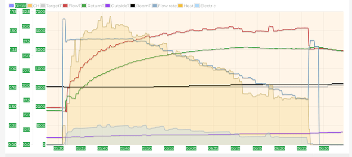

Thatās odd, my 8kW gen 6 is modulating the flow with a maximum temp of 30C.
And somethingās controlling the flow rate during HW heating.

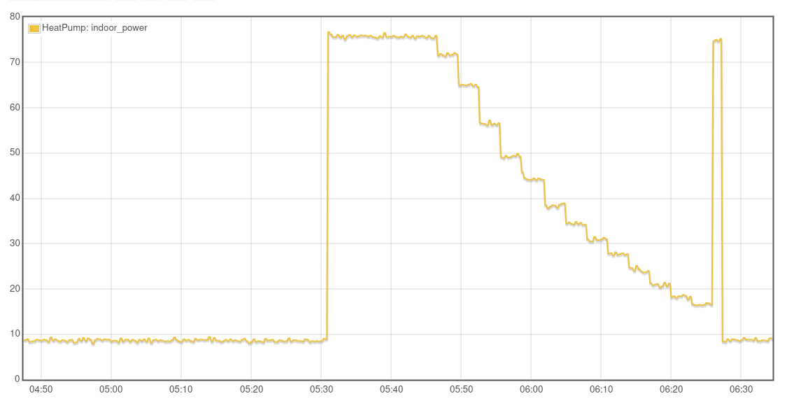

The system is completely open loop, there are no zones or valves to close. The flow rate in the graphs is the actual flow rate resulting from the pump slowing down. (You can hear the water speed reducing as the flow slows.)
And here is the power to the indoor unit showing reducing power input as the pump speed reduces.

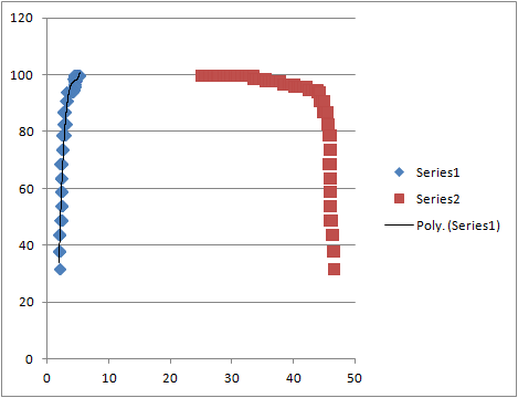

I took a look at the MIM-C02N outputs from a a couple of recent test runs. (I have FSV #4052 at the default 5degC even though my circān pump is fixed speed.)
- Nick K is correct that the controller PWM output stays at 100% on DHW.
- He also (almost) correct in saying that the PWM signal is 100% below an LWT of 45degC. Take a look at this graph (red line):
The x axis is LWT (degC); the y axis is PWM output signal (%).
OK itās not quite as black and white as Nick suggests, but (by calibrated eyeball) Iād say the signal is still 95% at up to 45degC LWT (but drops like a stone above that).
3. The blue line is actually PWM output signal against (LWT-RWT), though the scale Iāve used isnāt very helpful. But you can see that (as you would expect) PWM output drops strongly as deltaT falls (the raw data shows PWM=40% at deltaT of 2.0degC).
4. Iād conclude from this that if you are seeing measurable circulation flow modulation at a lower LWT than ~40degC, then something else is going on.
5. (opinion only) The only factor that I would expect to change circulation flow during a DHW run would be that of physical properties (density, viscosity etc) on pump performance. IMHO the Samsung controller is a pretty blunt instrument (much as I love it) and my search for sophisticated DHW algorithms has to date eluded me.
6. If anyone can explain what FSV #4053 does, Iāll offer a small cash prize. Nick K doesnāt know, and changing it seems to make b* all difference to anything.

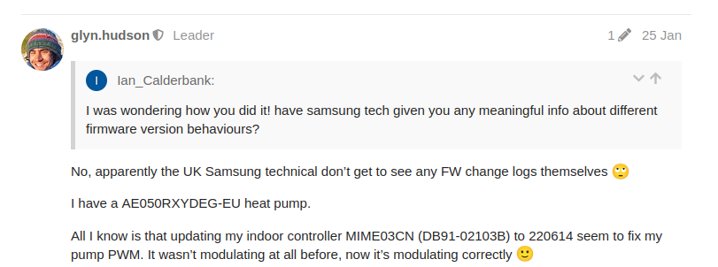

Sorry for the late reply. I got my Grundfos pump from Midsummer Energy. It included the PWM cable. Be sure to check the model carefully, not all Grundfos pumps support PWM.
Thatās not correct, on my Gen6 PWM will modulate the pump to maintain DT at any flow temperature e.g 30C
Hereās a link to view my data: Emoncms - app view dashboard
I donāt think this is true, Iāve observed PWM being active during DHW, it seems to modulate down to 17 L/min, without PWM my pump will run at 22 L/min.
However, I did need to update my firmware to get PWM to work. The dataplate on my HP says it was manufactured in 2021:
