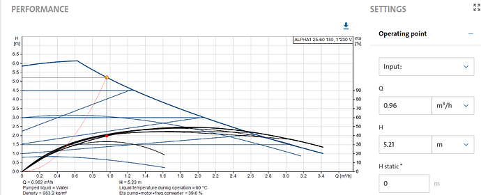

For now I don’t know if it’s the piping limiting the flow or the pump is not strong enough. I have Grundfos Alpha 1 25-60 which works up to 6m. My 1st floor radiators are 5 - 6 meters above heat pump. Is there a way how I could find what is a limiting factor ? I have 3 circuits. The main pipe diameter is 28mm and the circuits are 22m. Do you think it’s limiting factor or I can get more flow with stronger pump ?

One more update maybe you can help with pump power. I did measurements and it gives 10 lpm at level II. And at III. (max. speed) it gives 16 lmp. Do yo think with bigger pump it can get higher ? From These numbers I think it could or?

6m “rated head of pump” is not about height of house. that is a common misconception. Its the maximum resistance to moving water of the circuit, that the pump can overcome at a relatively low flow rate. At 16l/min the head that the pump can deliver will be somewhat less than 6m. the grundfos pump curve will tell you. depending on the current position on the pump curve you may well be able to get more flow with a stronger pump, but its always worth looking at the circuit design first to see if resistance can be reduced. Not just pipe sizes - what are the valves and other components it passes through, all have a resistance.
speed III will be full power so if you need more than that you need to change something.

again, 6m height is irrelevant. water goes in a circle. what goes up comes down, effect of gravity is neutral. but a long pipe can indeed be an issue if its not fat enough, high friction loss causes the low flow rate.
by valves I also mean things like diverter valves or zone valves, through which all the flow passes. if they aren’t big enough they will slow flow down. increasing system pressure will not help.

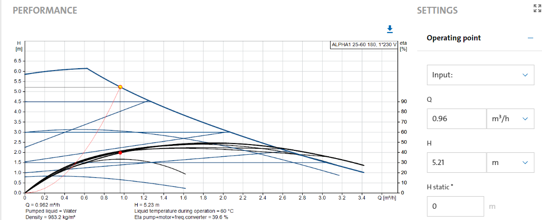

some maths:
here is your pump performance curve. at that 16l/min flow rate, if your pump is flat out, then you’re using 5.23m of head.
using this to do the prediction
head loss is 5.23, q=0.96 (convert between m3/h and l/min) , gives k = 5.67
to get 23l/min, q=1.38, h=k*(q^2) solution is h=10.8
To push 10.8m head at 23l/min is going to need one big bad expensive m*****r of a pump. its not going to be anything domestic size or price.
suggest you take a serious look at your pipework, something must be constraining it. draw it, including every component it passes through. check filters and all that kind of thing.
