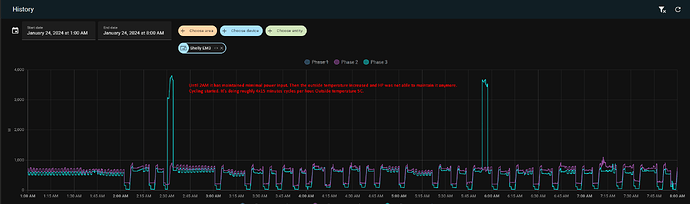

I will get PWM cable today so let’s see if it run better in higher temperatures. I still don’t understand why this pump has so short cycles… Really. I would be ok with 15 minutes or 20 minutes but 7/3 is very short and it’s only 5C here. What it will do when there is 10C or 15C ?
Your pump would be much much better for me and I regret I didn’t investigate more. I could find this forum sooner but it’s very hard at the beginning if you have no idea and you only find out when you buy it. As I can see from graph it can go as low as 500W power input which would solve my problem and that thing would not cycle until +10C! Unfortunately this shit I’ve bought can’t go lower than 1KW :frowning:

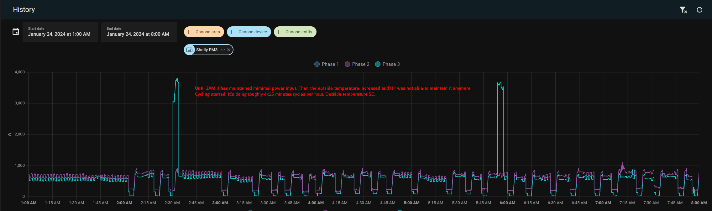

Here is the graph from last night. It wen fro1C to 5C in the morning and cycling nightmare started:
