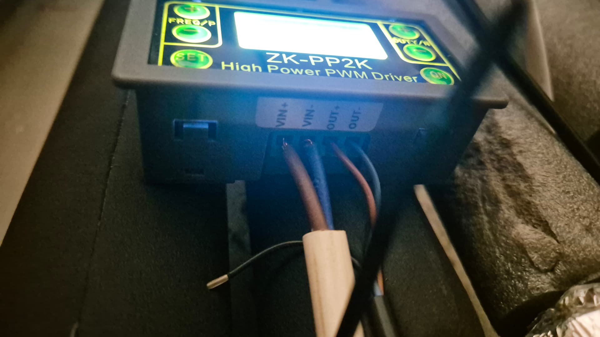

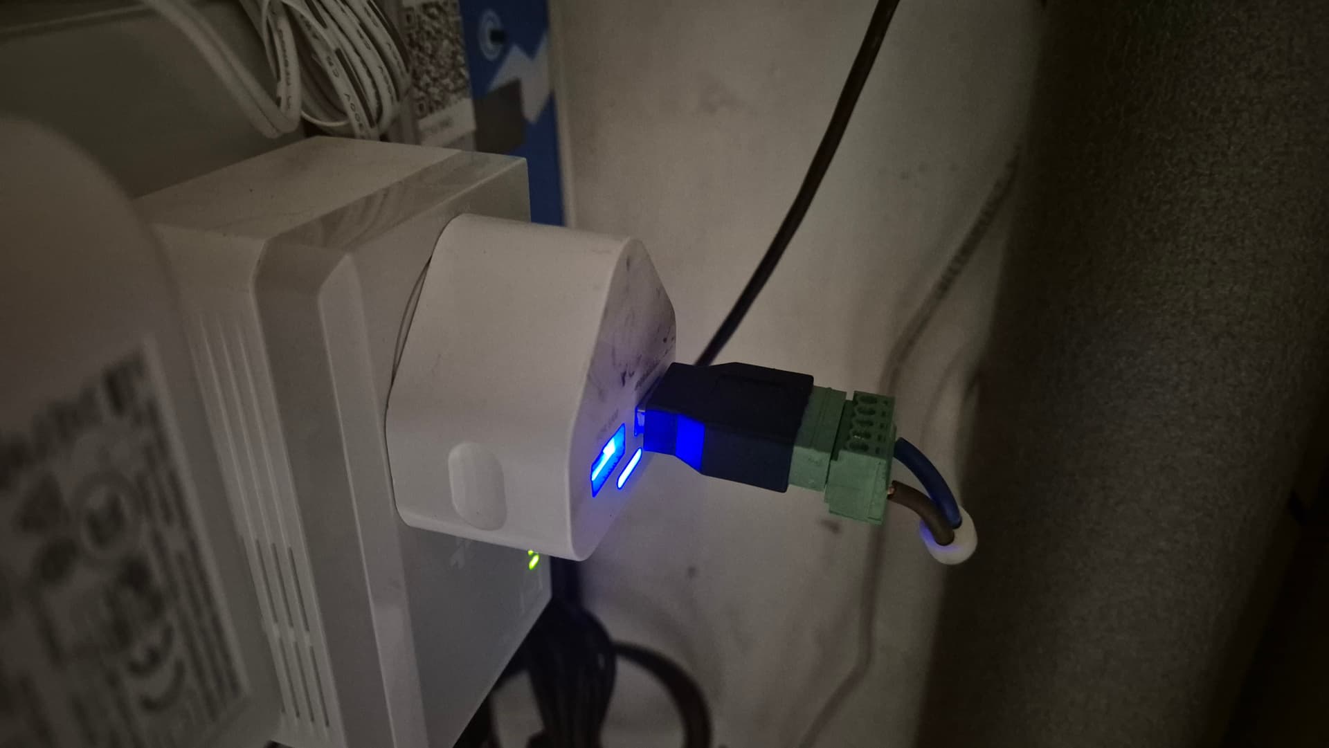

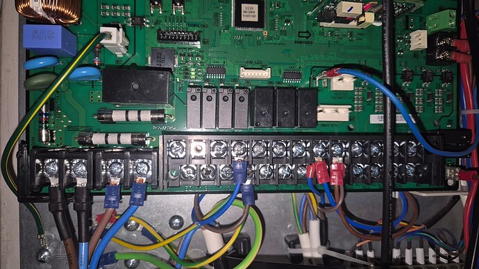

I bought a 3rd party PWM controller to control my Grundfos pump when I was having PWM issues from the Samsung controller. I’m now using it permanently to set a fixed pump speed which I’m happier with than the Samsung PWM controls. You have to wire the primary pump to the secondary pump terminals in the controller so that it can switch it on and off by cutting power, rather than changing the PWM signal to 100% (zero speed).

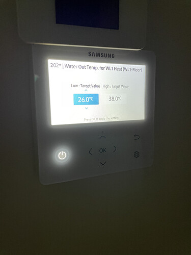

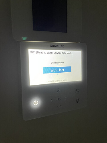

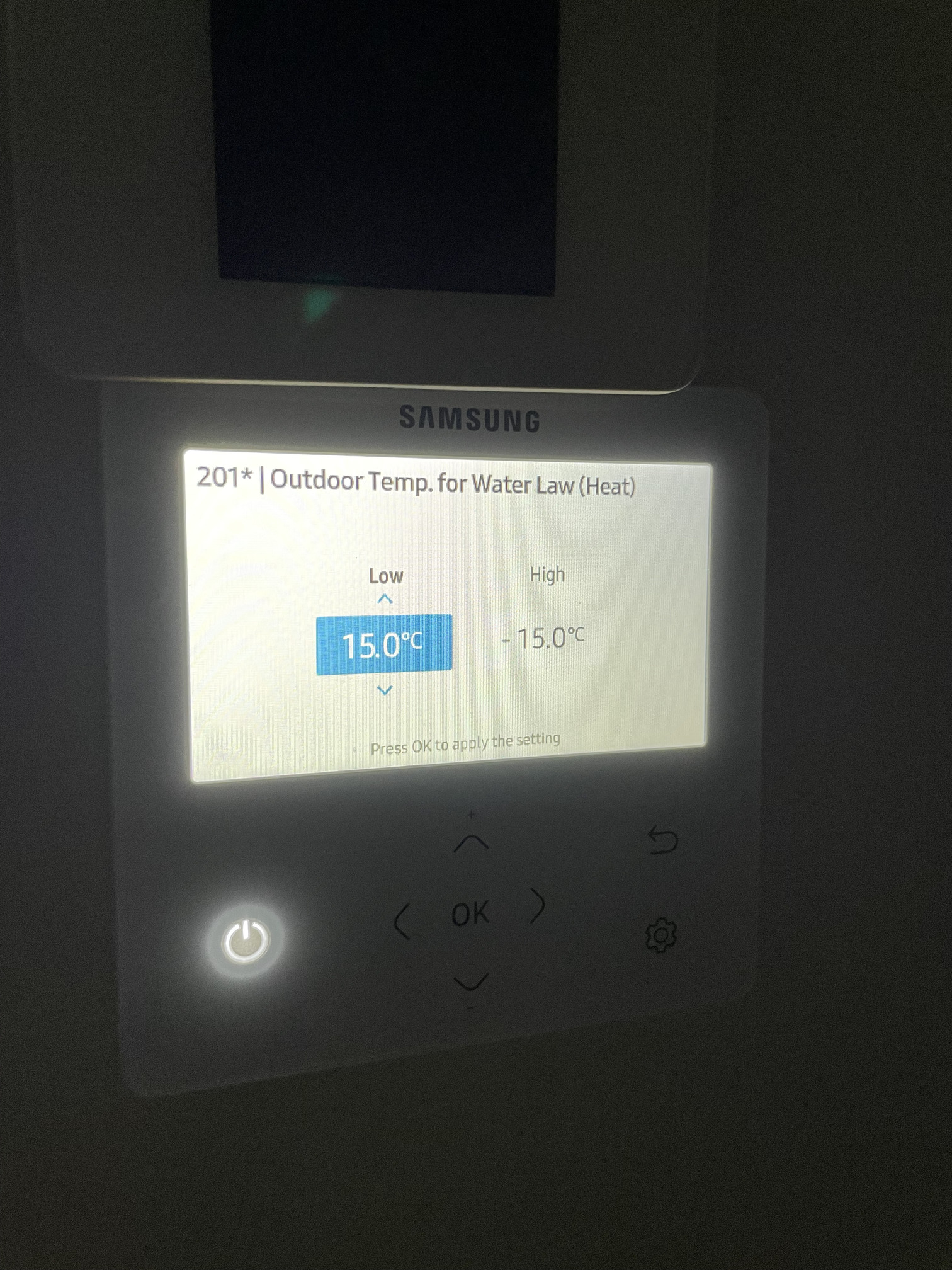

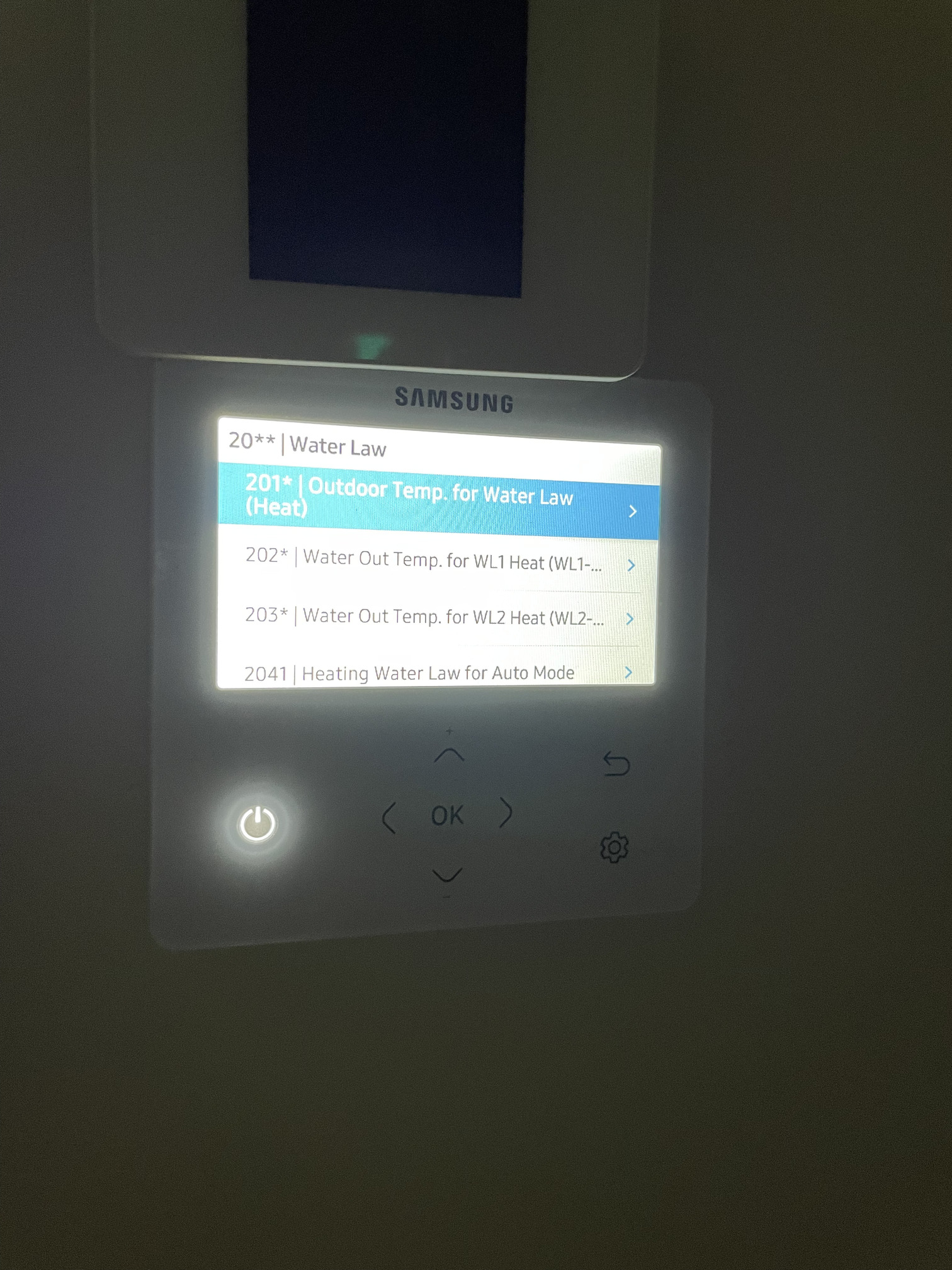

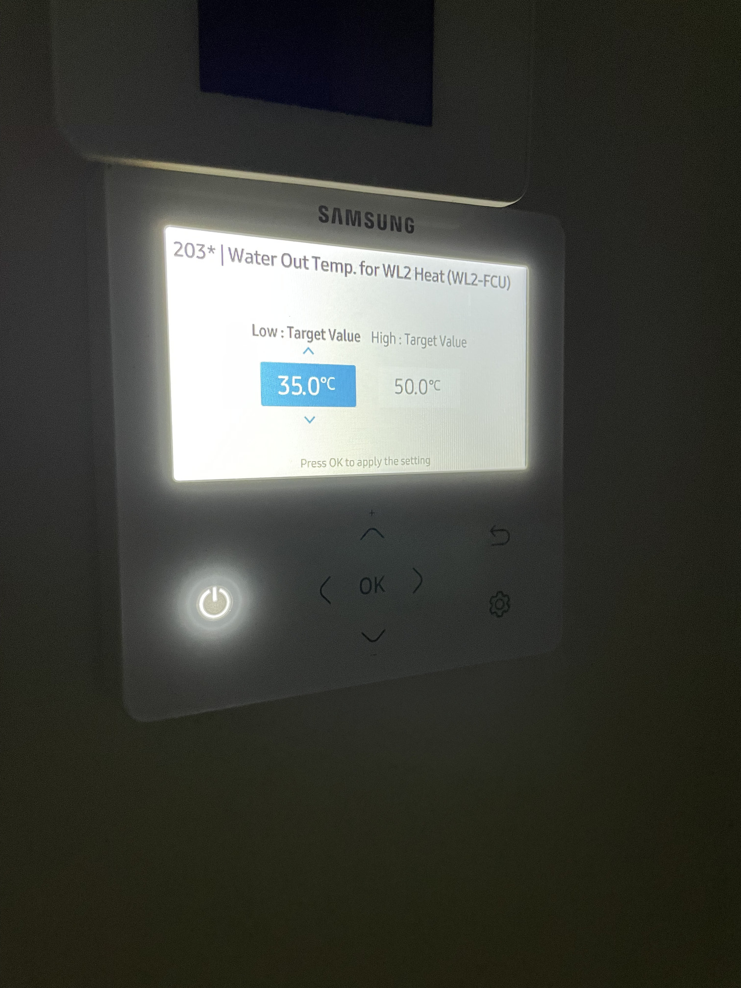

Thank you for the answer. I have no idea what is the heat loss of my property. Property was just recently built and it is holding the heat pretty well. Yes, I do have water law setup, see the pics below. Not sure what should be the ideal setting for it. Any recommendations welcome. Water Law settings

I would recommend that before you play around too much you get a good understanding of your heating requirements. I would ordinarily recommend using Heatpunk to model your own house which will then give you a heatloss figure, but this is mainly designed for the UK housing stock. It is extremely customisable though, so you might make it work for you. All you need is a few hours of your time and a tape measure. You can go as far as putting in the emitters and it will give you recommend flow temperatures.
For my system, I initially had an issue with PWM not working on my controller so Samsung replaced this for me under warranty. Since it got replaced in January to around 1 month ago I was using PWM. Last month I fit FRVs to my radiators to that I’m able to accurately measure and set the flow rate to each radiator to deliver the exact amount of heat required for each room. This only really works optimally with a fixed pump speed though, changing the pump speed affects the balancing, hence the fixed speed. I’m now using the 3rd party PWM controller to get the minimum pump speed I can get away with while still delivering the required flow rate to each radiator (plus a little extra for good measure).
I used a USB adaptor to power it with 5V, then put the PWM wires from the pump into it.

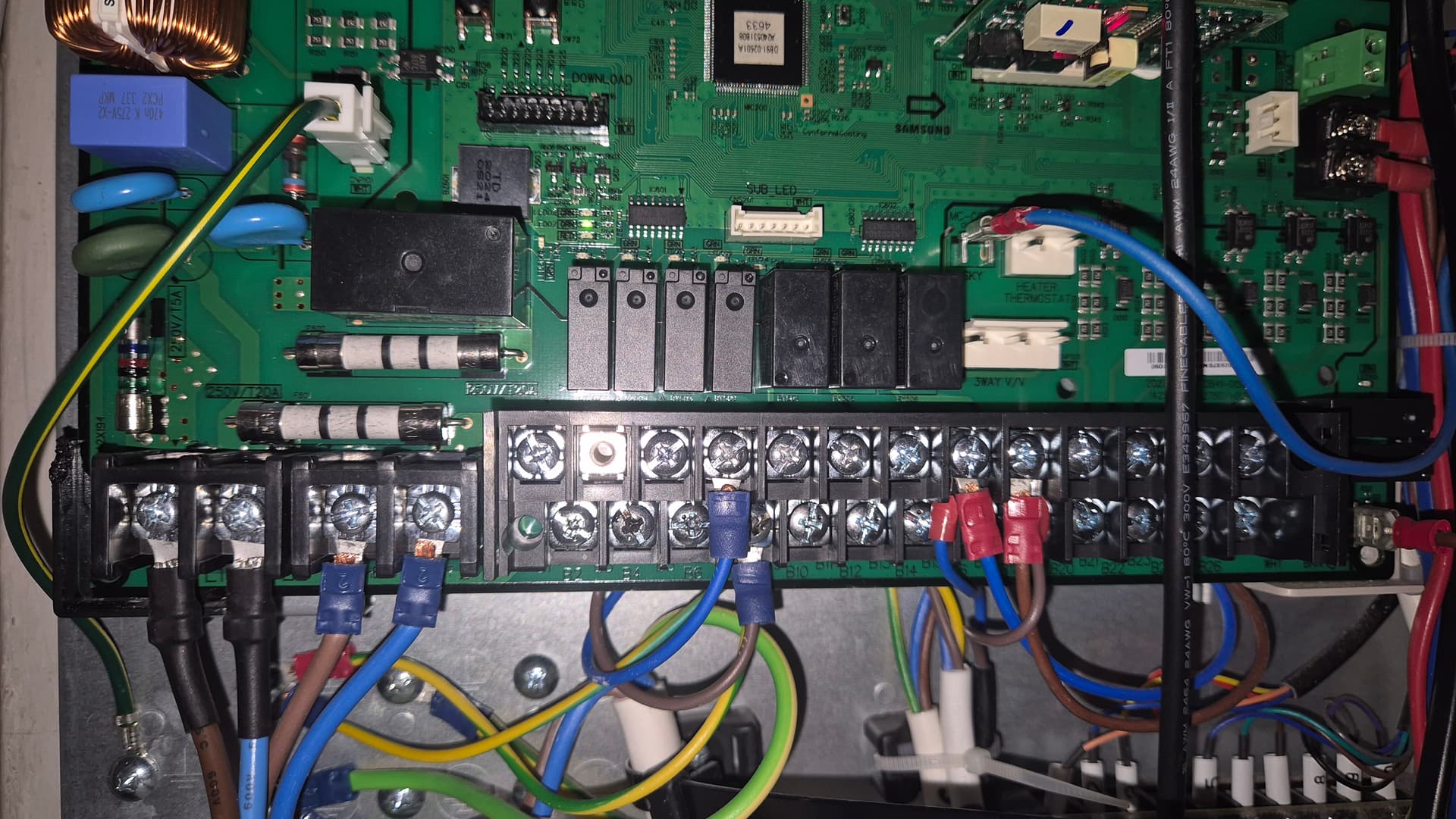

Inside the controller (make sure you power off before doing anything) the primary pump is usually wired up to B1 and B6 which is a permanent live. The secondary pump is usually wired up to B7 & B8 which is a switched live, it switches on when required. So when using a seperate PWM controller, you need to use B7 & B8. (Centre of the image below)
The frequency on the controller is set to 1.000Mhz, and the duty cycle can be changed which will change the pump speed.

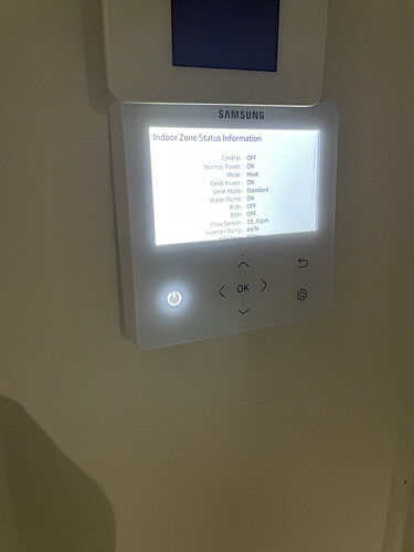

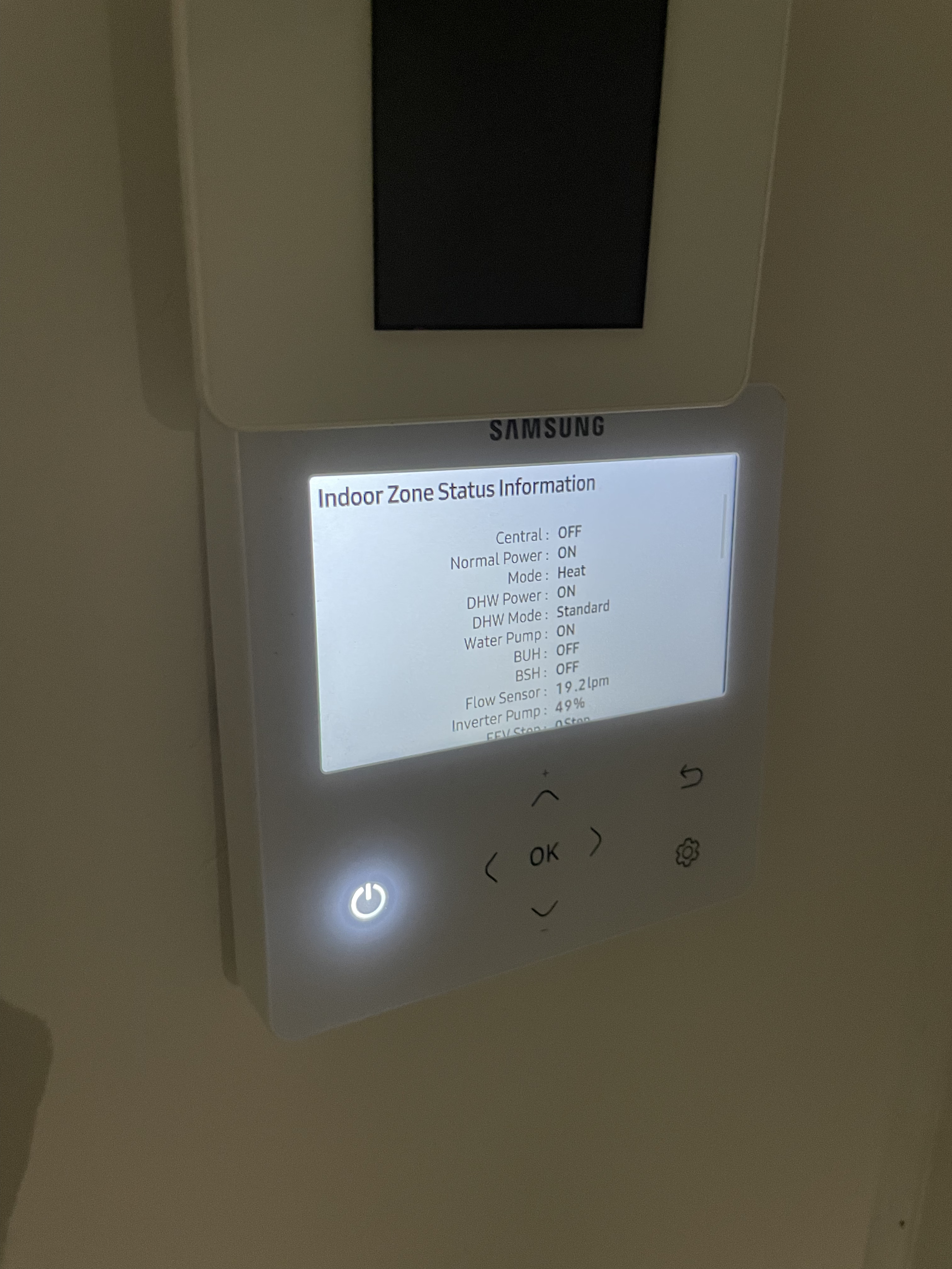

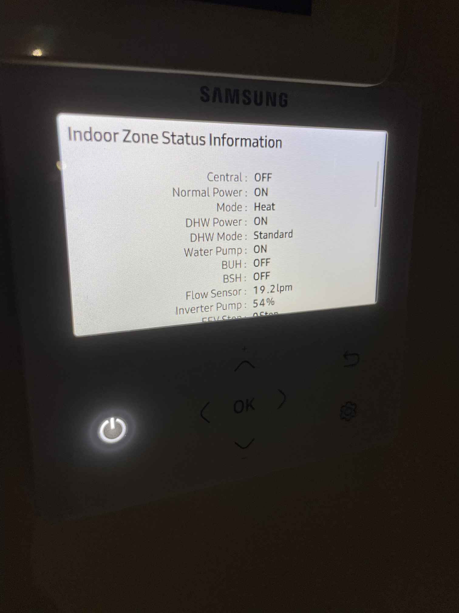

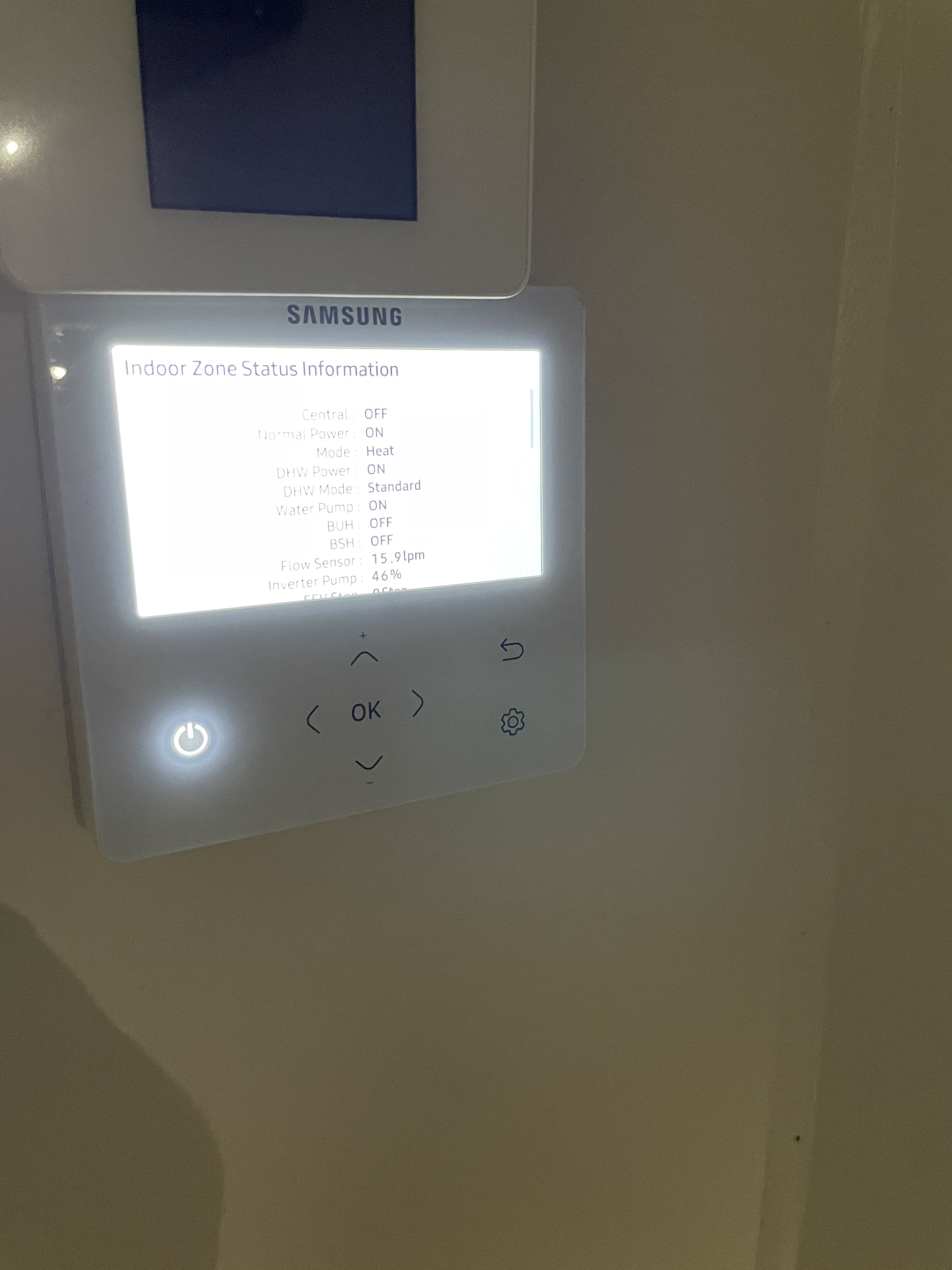

Update - I have enabled heating on multiple other room thermostats and surprisly pump is quite quiet. Buffer tank valve is also completely opened. 1 day before I set it to “Heat” mode with 30c and today enabled heating on 4 more rooms. From Indoor Zone Status Information I see water flow is much smaller than 34lpm and inverter pump working on less than 70% - seems something started regulating it? Note I have set inverted pump MAX to 70% already months ago. I see that compressor and water pump is working, but no annoying noise. One more important environmental change - since 1-2 days ago it is much colder outside (5C), before it was flapping between 13-7C. Any logical explanation for the rookie? Not sure if 30c and Heat mode is ok for such situation. Attached screenshots:
