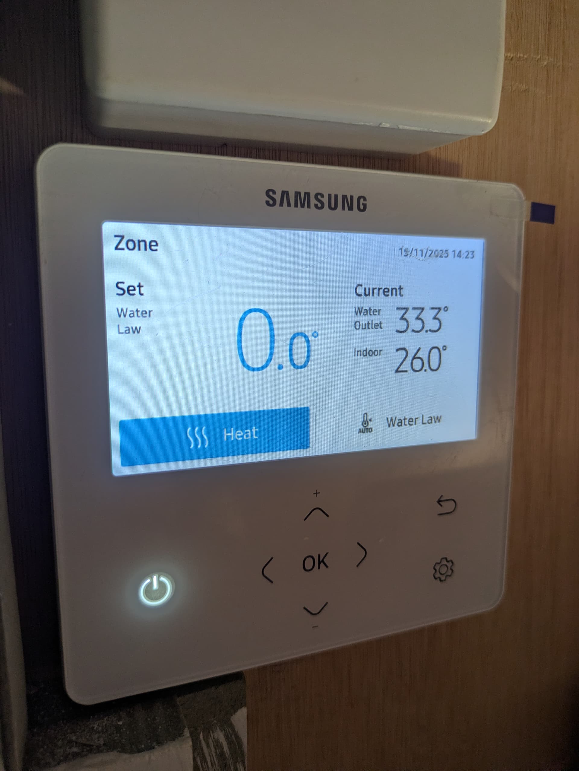

Main screen looks like this:
Whilst our installers did a very neat and tidy job, there was no explanation of the figures used in the design and no handover on how to optimise the thing. As far as I can tell it was just set up with standard settings. The house is always warm, but I feel it could be optimised and I think it’s cycling (see question below).
The system was set up with design room temps that are slightly different to what we would have and I think the heat loss assumptions were probably on the cautious side i.e the house doesn’t lose as much heat as they thought it did.

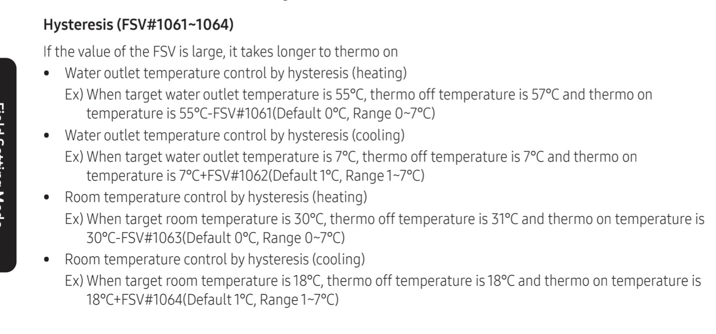

Check on your controller if you have #106* Field setting values. These control the hysteresis of the heat pump and should stop it switch back on immediately after switching off which will reduce cycling. You’ll be looking for #1061 in particular. Older models don’t have these settings, but you can get them with “just” a new PCB. What you set this to will depend on your set up, but I have mine set to 3.5, which keeps the heat pump off for around 1 hour after cycling off. You’ll find a description of how this works here:
Screenshot_20251122_091648_Chrome
I would recommend setting #4013 to 15 or 16. This setting determines when it turns the heat demand off. So it will turn the heat pump off when the outdoor temperature is above this. I tend to find I still need some heating at 15 or 16, depending on other factors (like solar gain) but if you’re happy with it at 13, there’s nothing wrong with leaving it at that.

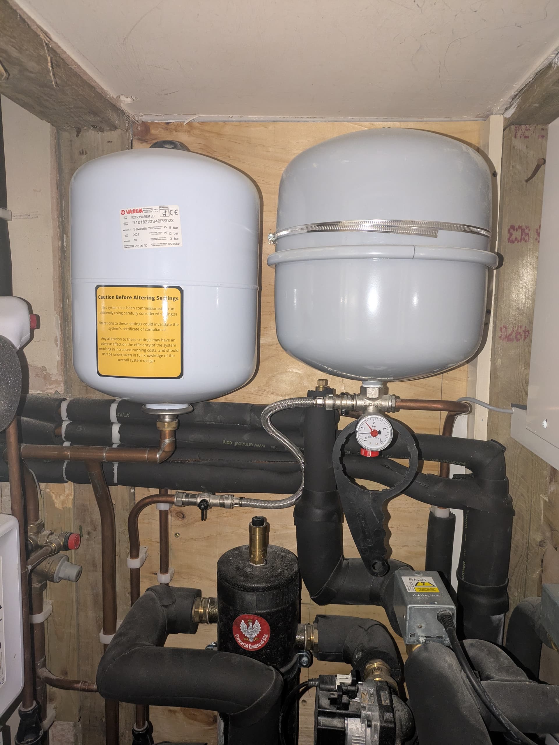

Buffer tanks though….would these be buffer tanks? We were never really told the purpose of them.
They are expansion vessels. You definitely need them!

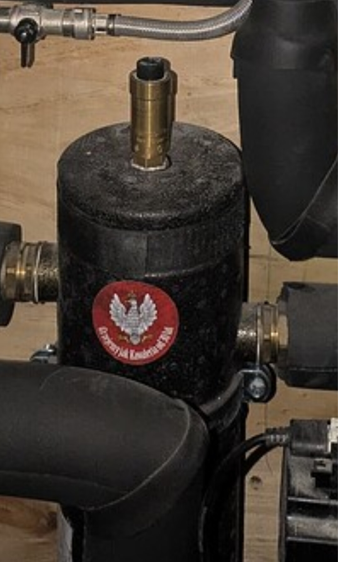

Those two aren’t, but this is a low loss header LLH (buffer)
If you don’t mind, would you mind explaining what they do? Just for my own curiosity and desire to have a basic understanding of the systems in my house.
Ah well spotted, and thank you.
Is that a good or a bad thing that we have one?
When water heats up, it expands in volume. This volume needs somewhere to go. Those metal cylinders have rubber balloons inside (that are counter pressured by air outside them - the air pressure can be changed). As the water heats up it expands into the vessel, so that it doesn’t expand into your system. One will be for heating and the other hot water.
Generally those vessels come at a pressure written on the side on a label, sometimes that pressure needs to be checked and changed and this can by done by a presta valve checker and bike pump.
If you knock them on the side from bottom up. It should sound a bit solid, then hollow. If it ever sounds fully solid all the way up the rubber is broken and it likely needs replacing (full vessel).
And just Google buffer tanks and LLH, there are many decisions on them. Best practice is likely without (likely always better efficiency) but sometimes they are genuinely needed, but then when they are needed there are again best practices.

I don’t know if your installers explained this; but mine didn’t tell me.
Where you have zero on your photo of your display, you can change this value with the +/- buttons to a value between -5 and 5. The value in this will be added to the target value set by water law.
I have used this to:
  1. see how low I can go without having to change FSVs all the time. I was amazed to find that in my 1890s-built home I could go to 27/35 at 15/-2. I have since realised that my HP outputs 30c as a minimum when it’s up to speed.
  2. when elderly family come, I set to +5 so the house is really warm for them.
The above are in conjunction with having an external thermostat set to 25c which is never reached and for the last few months, FSV2093 set to “Room temp ON/OFF or WL Interlink ON/OFF (Water pump3” to prevent cycling.
@jakeymd1 I’ve just managed to check and fortunately I do have FSV 1061, so that’s good. It was set to zero so I’ve set it to 3.5 and will monitor today. It’s quite a mild day today so a useful one to check the cycling.

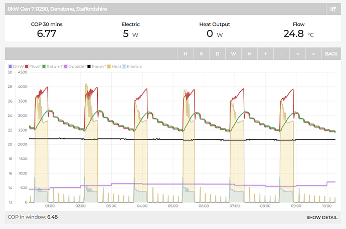

FYI, this it how mine behaves. When the compressor is off due to cycling, the circulating pump runs every 10 minutes for 3 minutes. If I lowered 1061, it would cycle more regularly and my cycles would be shorter. If I raised 1061, it would cycle less regularly and my cycle times would be longer

Interesting observations. I have had the same heat pump as you for over a year now and find that this 27 mins compressor on and 3 mins off seems to be normal for this design of heat pump at low temperature running. It only happens when the flow return temperature from the radiators rises too high and it is unable to reduce the output any further.
I increased the radiator capacity and carefully balance everything but I still get compressor cycling below 35C.
It does not do it at the high flow temperatures when it is cold, so maybe wait until it is well below freezing to make any assessment on compressor cycling. Note that defrost cycles will occur below 5C and is all perfectly normal.
This brief soft start compressor cycling is not the same as room thermostat cycling that occurs because the heat pump has been set too high so the system keeps cooling down and then has to heat up again, something we are supposed to avoid if possible.Soft start compressor cycling twice an hour does no harm and does not seem to reduce COP significantly for me. As long as the heating performance is OK I would not be concerned, just continue to make small downward adjustments to flow temperature until the house temperature is as you want it.
