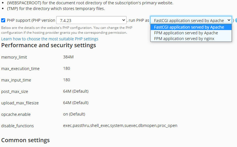

Anyway, yes exec is disabled along with these functions:
Also i have not mention that the Apache server is running nginx, if i say that correctly… Sorry its really not my expertise so i am struggling … (another rabit hole went down as i found that synology used nginx but never found what to do with the settings…)

Which PHP version should be selected on to run on the site?
Once more thank you @TrystanLea for the input and support, it is greatly appreciated!
P.S. These are the apache nginx settings available:
Hello @sententia Nothing stands out on the settings, all looks fine… does it make any difference as FPM served by Apache?
