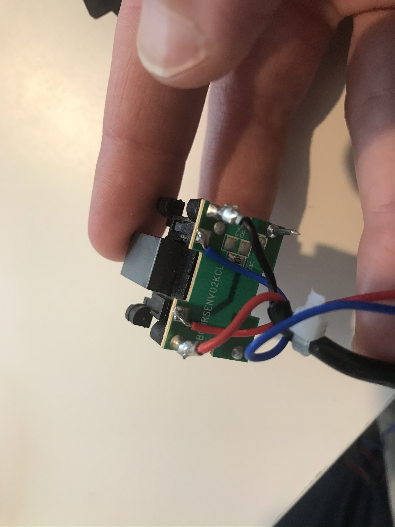

RMS Current not 0 when no load is attached
Hello, I’m trying to use a current transformer that was part of this simple energy meter https://www.amazon.co.uk/geo-Minim-Energy-Monitor-Self-Installed/dp/B00JIMQP6Y/ref=asc_df_B00JIMQP6Y/?tag=googshopuk-21&linkCode=df0&hvadid=232042431268&hvpos=&hvnetw=g&hvrand=8888410158766961590&hvpone=&hvptwo=&hvqmt=&hvdev=c&hvdvcmdl=&hvlocint=&hvlocphy=1007030&hvtargid=pla-422898079851&psc=1
I’ve attached it to my multimeter to measure the current when a load is connected and I’ve worked out a number of turns of about 6500
I’m using an Arduino Nano to try and get the current; I’ve built the circuit with the voltage divider explined here Learn | OpenEnergyMonitor (using 2 10k resistors), 10uF capacitor and a 150 Ohm burden resistor
I’m using a 5V supply
I’m only trying to read the RMS current, I’m not interested in voltage or power factor at the moment hence I’m just using the following code

I’ve used the calibration value 1000 to make things more readable; what happes is that I read a value of arund 3 when no load is attached and 5 when a 42W load is attached.
This tells me that the RMS calculation is not functioning correctly
I have to fudge this by adding an offset
double Irms = emon1.calcIrms(1480)-3; // Calculate Irms only
This way the value becomes proportional to the load through the CT, but I don’t think I should be doing this, what is wrong?

Unfortunately there is no indication of the current ratio on the CT
I see there is a small resistor inside (see pictures in first post), could this be a built in burden resistor?
I read 84 Ohm at the leads with nothing attached (not sure if this would be the value of that resistor or/and the windings)
I’ve tried attaching the CT directly to the Arduino (one lead to ground and one to the PIN 7) and running the code; now I do get 0 with no load attached and a higher value with the load ON… not sure if this is expected
Almost certainly. If you can read the value, that would help to confirm it. From the numbers you’ve given, I think 84 Ω is reasonable for the secondary winding and that resistor in parallel. That also explains why I am suspicious of your 6500 and the 11.5 mA that I calculated.
What you need to know now is the voltage that you get when 75 A is flowing. There’s an easy way to get 75 A - what you want is 75 ampere-turns, so a 1 kW heater is about 4.2 A, so if you wind a coil with 17 turns and clip your c.t. onto that, you’ll have in effect 71.4 A, which should make measuring the voltage easier. One possibility is about 0.333 V.
Of course, it might also be a zener diode [even though it’s labelled ‘R1’] to protect against over-voltage. Until the c.t. is tested properly, or we find some data, we won’t know.

On the small resistor I think I read 100 or 1000, but it’s too small to be sure
I have that problem these days with those components. A pair of pharmacy reading spectacles of about 3.5 dioptres is my solution.
Definitely a resistor then, so you should not have your 150 Ω as well - that only reduces the sensitivity and makes any noise worse, because the calibration constant must increase to to restore the calibration but at the same time it has the effect of amplifying the noise.
Ok, so I just did a test with a toaster; when connected to a meter plug it draws 6.8A
I’ve wound a wire 11 times around my CT so that gives me 11x6.8A=74.8A
The voltage measured is 2.23V
By the way, the burden resistor is definitely 1000 Ohm (It can be read in the picture above)
EDIT: maybe 1000 actually means 100 Ohm (100 x 10^0)
Yes, it does. So the secondary winding is about 525 Ω, which is believable, and a secondary current of 22.5 mA, also believable.
So, with a 5 V Arduino Nano, your maximum input voltage is 1.6 V rms (allowing for a little headroom, which makes the maximum current you can measure about 54 A. So I think that without the 150 Ω (which would put the max. current up to 90 A), you’re good to go.
The calibration without the 150 Ω will be 33.5 approximately (55.6 with). So the calibration you tried - 1000 - was in effect giving you an amplification (of the noise) of around twenty times.
