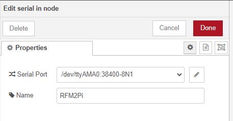

I’m not using emonHub, I have used node-RED to format the data, store it in Influx, and display it in Grafana.
Node-RED has a serial in node to monitor specific serial ports, and nothing is being picked up (also nothing is being detected in minicom)

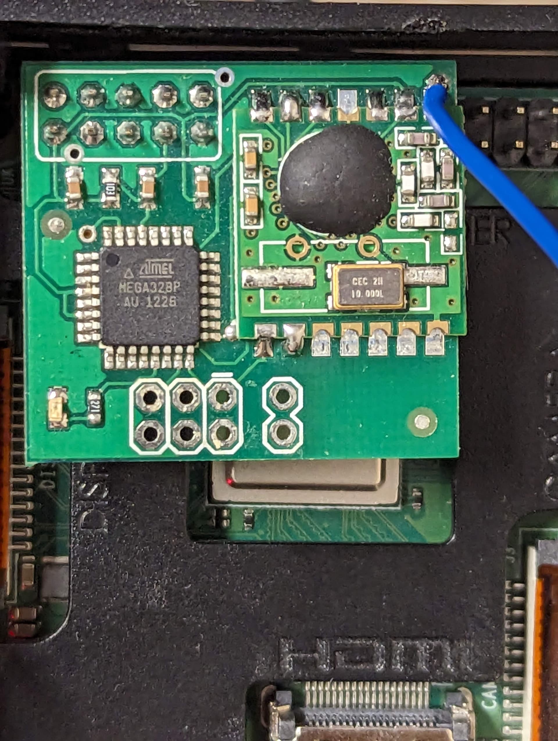

Thanks Brian, I was thinking the same, as the new RFM2Pi is displaying the same symptoms as the original RFM2Pi - just a blink of the onboard LED, and no output on /dev/ttyAMA0, so yesterday I rooted in my junk drawer (we all have one :wink:) and found an old RFM12B module (that I didn’t know I had).
Although it works on a different baud rate, and the output format is slightly different, it worked OK, and I began receiving data on /dev/ttyAMA0 from two of my sensors (channels 10 & 18), but did not deliver data from EmonTH’s & EmonTX’s whose channels were in the 20’s ??
There is some dropout however, despite being in the same room as one of the sensors, and not getting consistent 5 second updates.

Even placing an EmonTH next to the RFM12B makes no difference, yet a temperature sensor 10mts away and through 2 walls using channel 18 reports reliably.
It just won’t handle signals from channels 20+
