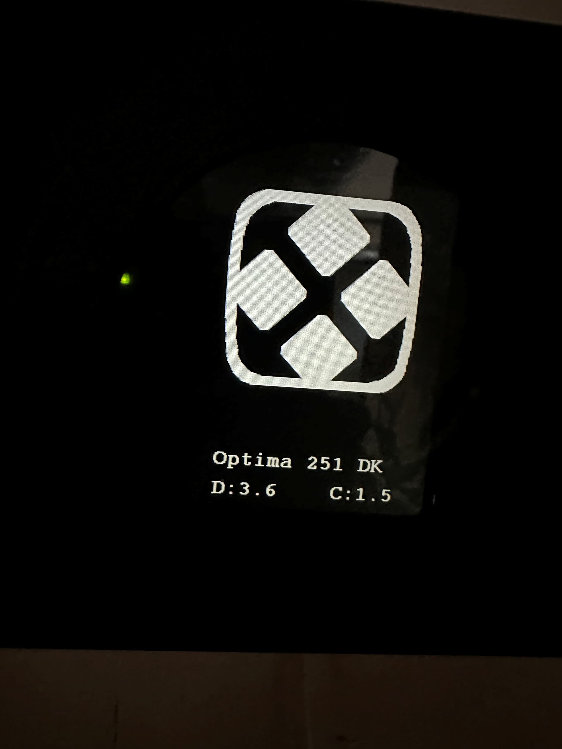

how did you get this spreadsheet? - that info is gold!
I have an Optima 251 art. 022112. You wrote “Only from art. 022113 on the hardware is present” - do you think that I have the required hardware when it is a 251? What software do you have? is the software on the SD-card?
