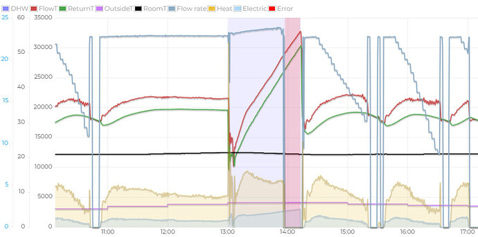

I just completed a DHW cycle and sure enough data error appeared. Both the flow in the HP and heat meter (using emoncms local) dropped to zero near the end of the cycle and by 2 pm all back to normal.
There is no data error when normal heating the rads.
I think I may have to tweak the pump flow rate via the controller…
That’s exactly what I had for weeks until I did the low pressure cook off.
It was very consistent getting the error at almost the exact same temperature each day. But never during normal heating.
This was a typical example from last year.
Hi Martin,
This is typical behaviour when you have an air problem. The air stays dissolved in the water until the water temp exceeds a threshold and then the air comes out of solution and forms micro bubbles.
It is these micro bubbles that defeat the operation of an ultrasonic flow meter like the Axioma.
CH flow temps are typically below the threshold, DHW cycle ends above the temp threshold.
I hazard a guess this has little to do with flow settings in your heat pump.
