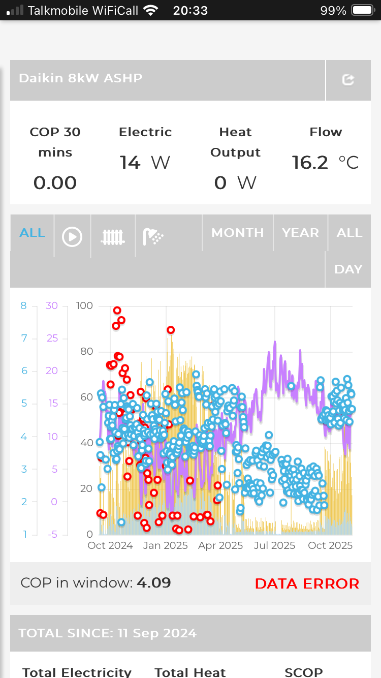

I’ve been wrestling with ‘Heat meter air issue’ since my install and would welcome some advice - HeatpumpMonitor.org
I’d like to think this is residual air that is slowly being removed but as you can see the temperature that the issue rears its head when doing a DHW cycle is getting progressively lower over the past few days.
I ran a CH cycle up to 45c on the 27th as a test, no ‘air issue’ error and this resolved the DHW issue for a couple of days, it started again on the 30th and looks to be getting worse.
  • No visible leaks in system and pressure seems to be holding - currently 1.8bar when pump is off.
  • This was a retrofit from a gravity fed system so there is the possibility that there could be a small leak under a suspended floor due to the increased pressure. I’ve lifted a good chunk of the floor and found nothing to suggest leaks.
  • There were some leaks earlier on new pipework and radiators - all now resolved.
  • Spirovent installed on primary flow
  • No air at all in any radiators when I bleed them.
  • AAV on DHW circuit, periodically opened.
  • Air issue only seems to appear during DHW cycles, even if I ran CH at same temperature (45c) it would not trigger the error.
I’d welcome any suggestions on what I can try next. Does the data point more towards an active leak/ingress of air or is this residual air that I need to be more aggressive on purging?

It obviously knew I was talking about it so decided to behave today! HeatpumpMonitor.org
You can see the the flow was starting to fluctuate at the flow temp hit about 48C so perhaps its slowly getting there. I managed to get a fair amount of air out of the magnetic filter which may have helped.

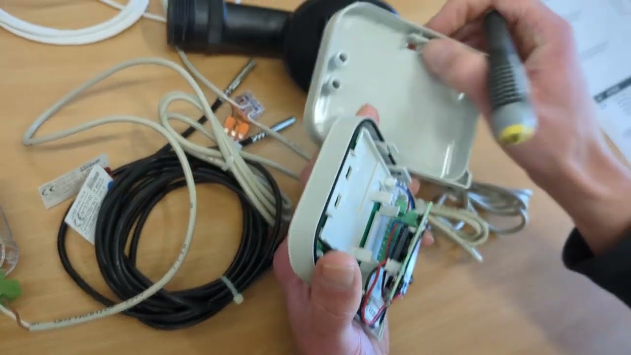

Hi Matt, In case you weren’t aware and would find it convenient, the Axoma display can be dismounted from the pipework sensor part.
My heat meter came with a plastic clip for the display that can be screwed to a surface that’s more in your eyeline.
I didn’t know that. I probably won’t touch it for now as to not temp fate but thanks for letting me know as mounting it higher would make it easier to read.
Here’s an OEM video showing the display separated from the flow sensor part.

My problems are still occurring a month later during DHW cycles. Pressure holding steady and no water added. I’ve no idea what could be causing it at this point - corrosion? I went as far as to run the CH house up to 45c to see if I could trigger it to no effect, zero air in any radiator. I also did a legionella cycle as a nuclear option which went about as well as expected HeatpumpMonitor.org
I’m getting a significant amount of air out of the magnetic filter after every DHW but I’ve no idea where it could be coming from.
