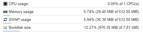

I bridge both brokers both ways for all topics (actually 3 brokers, PVE, HomeAssistant & EmonPi). It doesn’t appear to really use any resources to do so and is just simple.
Running in a dedicated LXC Ubuntu container on PVE (which really is the best way to run stuff IMHO).
