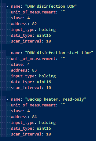

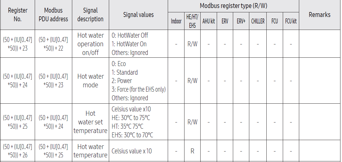

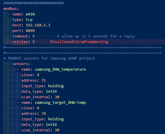

The address of the item you’re interested in, is calculated from:
(50 + (IU address [0, in my case] *50)) + a number - taken from the manual. IU stands for ‘Indoor Unit.’
If we look at the table above (an excerpt from the ‘Modbus Register Table’ in the MIM-B19 installation manual) - for ‘Hot Water Temperature’ we see that the ‘number’ to add in the formula can be taken from the ‘Modbus PDU address’ column, and in this case, is 25.so 50 +(0X50) + 25 evaluates to 75, and this is the address to use to pluck this data from your machine.
I found that this yaml worked for me - incorporated into my HA ‘configuration.yaml’ section:
modbus:
The top section is the configuration for the W610 converter - 192.168.1.3 is the static IP address I chose to set (previously mentioned). Replace this with whatever IP your router has assigned, and the port number with whatever you chose when you configured the W610. I’m showing the creation of just two, of many sensors I’m using in my project. Note the ‘address 75’ which is used for my ‘samsung_DHW_temperature’ sensor. As per my earlier post in this thread, I set my MIM-B19 address (using the dip switches & rotary selector) to ‘4’, hence ‘slave: 4’ in the code. Please ignore the ‘Disallowedextrapropwarning’ message - this is generated by Studio Code Server (the software I installed with which to edit my yaml). Having read data from the HP, I now wanted to send data to it…

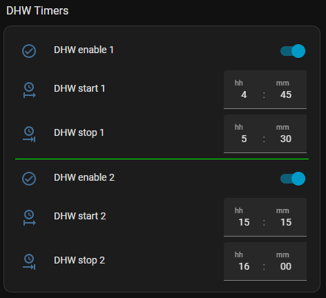

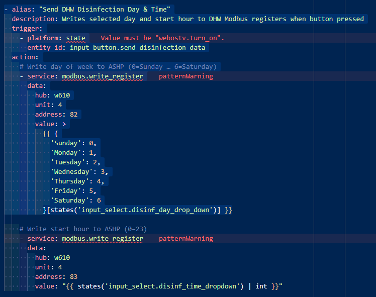

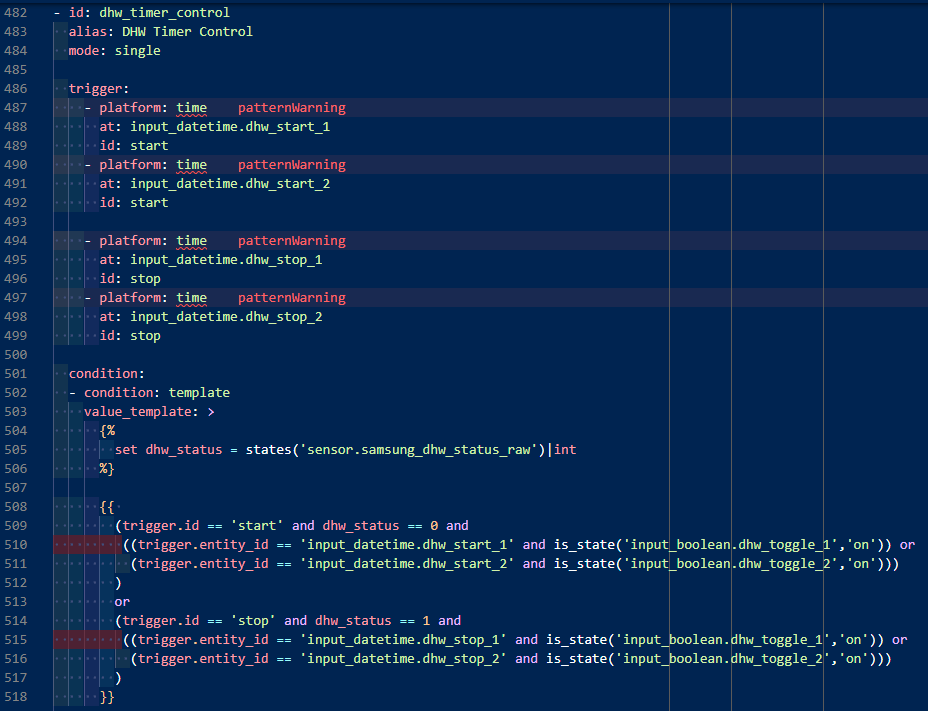

I particularly wanted to control DHW cycles, and finding no easy way to remotely pre-program the time schedules in the ‘Remote Controller’ I at least found access to the DHW on/off register, and being read/Write (R/W) meant I could change it remotely. I opted for two sets of time-only HA ‘Date/Time Helpers’ for setting my schedules (I didn’t want to be messing around with having to set dates, too - as the times align broadly with our cheap energy slots, and as such I generally want the DHW to fire each day at the same time, but in order to have an easy way of disabling the slots, I also incorporated an ‘enable/disable’ switch:
This is the control code I ended up with, in ‘templates.yaml’ (I had to do two screenshots, but it’s all the same codeblock):
Note that we’re sending to ‘address: 72’ calculated from the top line of the above table snippet in the ‘Modbus PDU address’ column 50 + ([0] X 50) + 22 = 72 … where, once again, 0 is the address of my indoor unit (IU).
I’m no software engineer, so I’m positive that others can make a better job of it than me, but this does, at least, work.
Once again, ignore the red ‘patternwarning’ messages.
This, then, got me fairly straightforwardly to reading the data THAT SAMSUNG HAVE MADE AVAILABLE, but there’s a lot that isn’t ‘pre-programmed’ so-to-speak, and we have to add these ‘functions’ to Modbus ourselves if we wish to access them. You’ll need to wade through the previously-mentioned docs that Folk have published, in order to find which of these you want, and whether or not you need to self-add. P.17 of the Samsung MIM-B-19 manual contains some fairly crucial info on this:
Samsung aren’t known for their clarity-of-explanations, and this took me quite a while to decode, and take in.

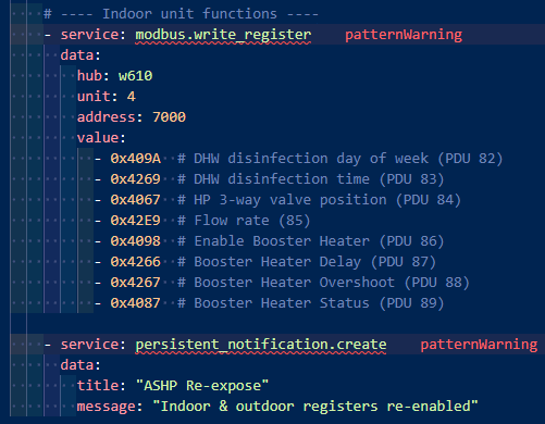

It can be seen that if wishing to add functionality associated with the ‘outdoor unit’ (ASHP) then they should be written to addresses starting 6000, but adding those associated with the ‘indoor unit’ (the ‘White box’ MIM) then they need to be written to addresses starting 7000. I discovered that those in which I was particularly interested to control (DHW disinfection start time, and start day), were associated with the indoor unit.
In order to add these functions, one needs to ‘…write the corresponding MessageSet IDs starting from 7000.’ Turns out that ‘MessageSet IDs’ are the aforementioned hex codes, and you’ll need to trawl through the aforementioned docs, to find the published codes. An example would be Sarah Hanson’s very useful Excel workbook ‘NASA_Interpreter.xlsx’.(see earlier posts for link) sheet name ‘NASA Database’ where down in row 245 you’ll see in col A, a ‘Mess #’ of 4269. To get the hex, we need to precede this with ‘0x’ thus the MessageSet ID becomes: 0x4269. Now, referencing the Para 2 notes in the P.17 snippet above, we now write this to 7000…, in order to enable it for use. NB the notes also instruct us that if we need more than one, we need to write them all at once. You can add more in the future - but my understanding is that you can’t append the ones you’ve already created - you need to append your ‘writing’ code with the new ones, and write the whole lot again. I also found that to be successful, one needs to write more than just one MessageSet ID - two will do, I think. The notes suggested that one writes the first MessageSet ID to 7000, the second to 7001 etc, but my friend ‘CHAT’ who was helping me from (ahem!) time to time, suggested code which [successfully] wrote the three I needed, all to the same address of 7000.

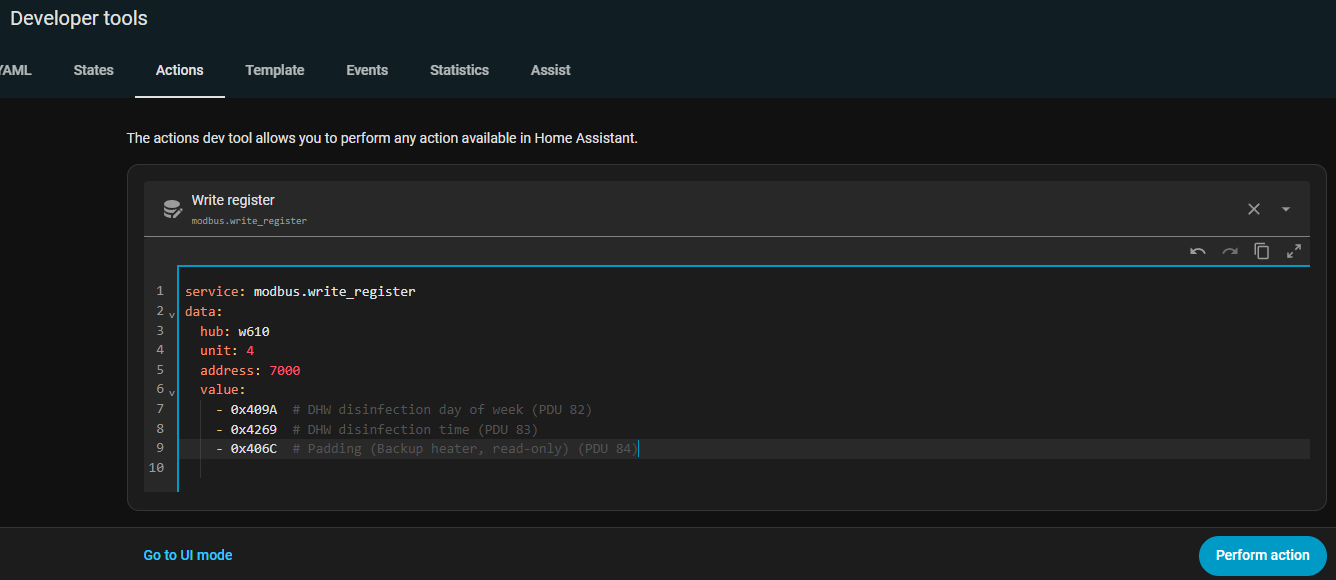

I used the ‘Actions’ section of HA Developer Tools, to fire off the code for testing, but fully intended to write a proper script to easily fire from a button, as I believe that if the HP’s powered down for any reason (power cut etc) the registers will need re-programming, and it would make it a whole lot simpler to just be able to press one button for this purpose; note to self - must get ‘round to doing that…
Now, referring to para 2, note 2 above, we finally use the formula 50 + ([IU of 0, in my case] X 50) + 32 = 82, in order to reference the first item in the list (Disinfect DOW), 83 for the second (Disinf time) etc etc.
I appended the earlier ‘sensors list (see photo) with the appropriate additions (note the aforementioned addresses):
I use these sensors in my HA system to display the data - and for confirmation that the HP has the new data, if sent.

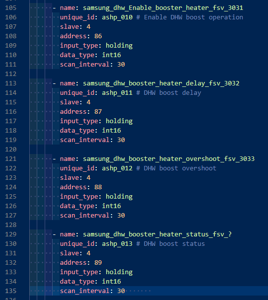

Little bit of head scratching; I’m using this to access the DHW heating element functions (ignore red ‘patternwarning’ messages):
What I’m seeing for the ‘Booster Heater’ ‘States’ (values) in HA doesn’t match what I’m seeing on the Samsung Remote Control display…
Function Remote Control value HA ‘State’ (value) Samsung FSV # Hexadecimal
Enable booster heater ‘Use’ 0 3031 0x4098
Booster Heater delay (mins) 20 0 3032 0x4266
Booster Heater Overshoot 1.0 0 3033 0x4267
Booster Heater Status Not displayed ‘Unavailable’ Unknown 0x4087
Before I even dare try to write to it, I need to reliably read from it, but there appears to be a disconnect.
Any ideas?
Not all messages are 4 bytes long, I’m not 100% sure how the modbus interface exposes the needed information but ON/OFF values are usually 2 bytes long and their raw values are either 01 or a 00.
For 3032, I believe this is an unsigned 2 byte payload too.
3033 I would imagine will be the same story.
For the booster heater status, that will be an on/off value.
Mind sharing the config you are using to parse the values?

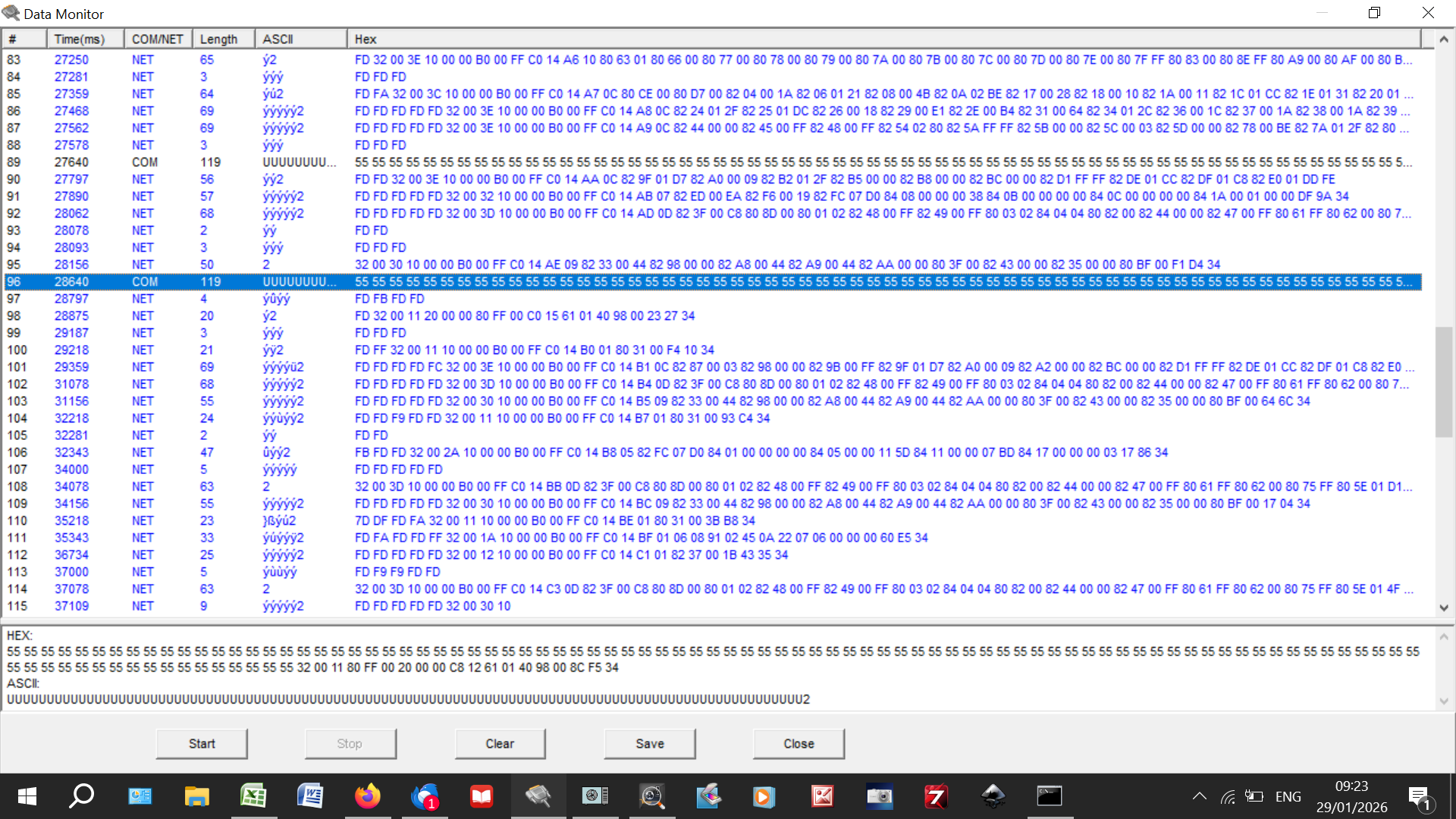

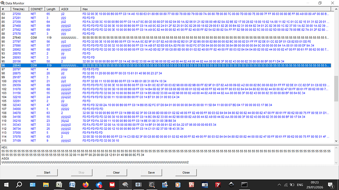

FWIW, @Sykes, none of 0x4098, 0x4266 or 0x4267 routinely appear at F1-F2 according to my little Python sniffer. 0x4087 appears every ~160s.
But don’t despair. I just set and reset #4098 using SNET (as a test) and here’s what my VCOM saw:
You can see that (for the reset to 0 for example) packet #96 is the incoming SNET command (the 40 98 appears in the bottom window after all the 0x55 preamble bytes), followed by the MIM response in packet #98.
My conclusion is that you’ll only see certain NASA messages when the value/payload is changed, not in the normal course of events. This doesn’t, however, explain what happened with 0x4087. Did you give it long enough to appear?
First some background on the MIM-B19. I don`t know this for sure, just what I have observed while debugging. The B19 caches values from the NASA bus, it decodes all packets it sees and if they correspond to Modbus registers in the fixed table, or registers that have been added via hidden registers, it stores the values locally. Then when you make a request on the Modbus side it looks to see if it can return the value from its` cache. If it can, job done. If not it has to send a read out on the NASA bus to fetch the value. It has to wait until the bus is quiet before it can send the request, and this may take longer than the Modbus timeout, so @SarahH may well be on the right track with asking did you wait long enough.
Once such a request is made it will add this register to its` cache and subsequent reads should be fine. It seems to have a concept of staleness, so if a particular register in its` cache has not been updated by the regular NASA traffic after some time it will send a read out to refresh it.

I’m creating HA sensors for each piece of data I retrieve from the HP, thus:
These functions - like disinfection etc - have had to be ‘added’ but I’ve done the same as I have in the other registers (Disinfection etc) and they’ve all played nicely…
As they’re all 0x4xxx I’m assuming that they need exposing in the indoor unit address 7000.

Correct, try uint16 rather than int16 for the data_type.
