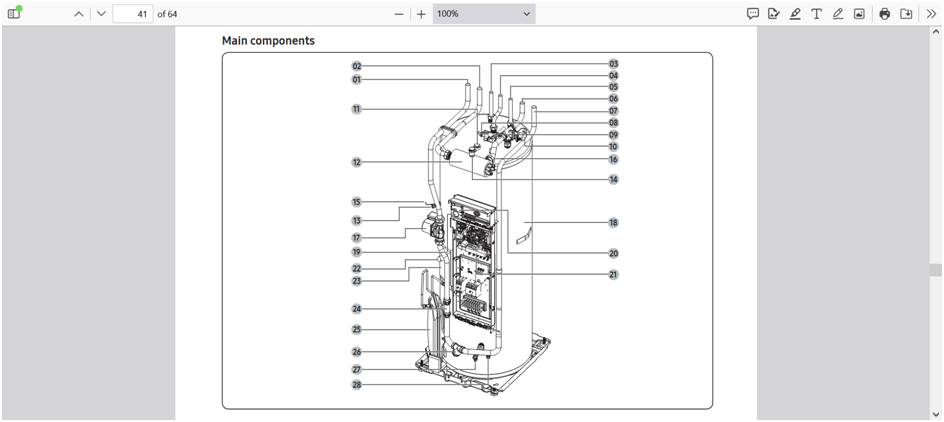

For removal of doubt, @Sykes, the “Indoor Unit” (aka Tank Integrated Hydro Unit) looks like this:
The MIM PCB can be seen about half way up. Judging by your earlier photo, you have the standalone version, not the integrated version.
Ah haaa! @SarahH @toadhall thanks both. I now understand that I have a non-Samsung set up, in so far as my DHW tank is from a different stable - with the MIM-E03 (‘Indoor unit’) separate to the cylinder, and separate to the Wired remote controller, whereas the ‘Standard’ Samsung design has the MIM-E03 attached to the side of the tank, AND (in some cases) has the wired remote controller bolted to the MIM-E03**.

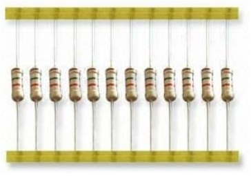

The other 2 things you need to get are a length of cable - to run from your MIM-B19 in the HP, to wherever you decide to locate this ‘converter,’ and a couple of 120 Ohm resistors. I didn’t want to be messing about with electronic components to begin with, but to be honest they’re easy to come by, and cheap-as-chips (as we say in England.) They’re also easy to fit. They effectively help to reduce noise generated in the cable, which can ruin the modbus messages, so it’s quite important to do all you can to suppress unwanted garbage from giving you an issue. I have read that the resistors aren’t necessary for short cable lengths, but as I was running my cable through about 2m of ducting which also carries the mains for the HP (which can draw upward of 7-8 kW when doing a DHW cycle) I decided to put a resistor at each end.
I got a strip of 100 for £3.79 at Amazon here, so I’ve got a few going spare…!

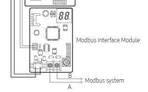

The comms cable you buy, connects between the two terminals on the MIM-B19, and the W-610.
The MIM-B19 left-hand one connects to the W-610 ‘A’ terminal…
The MIM-B19 manual can be found here.
