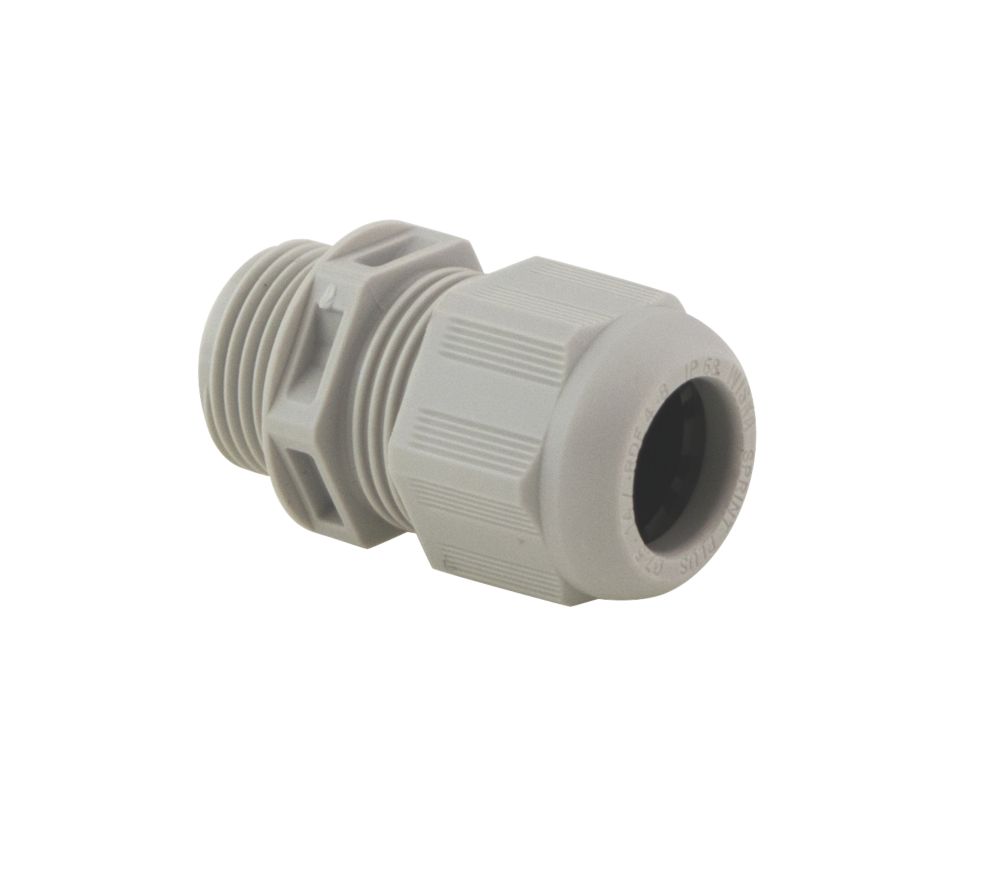

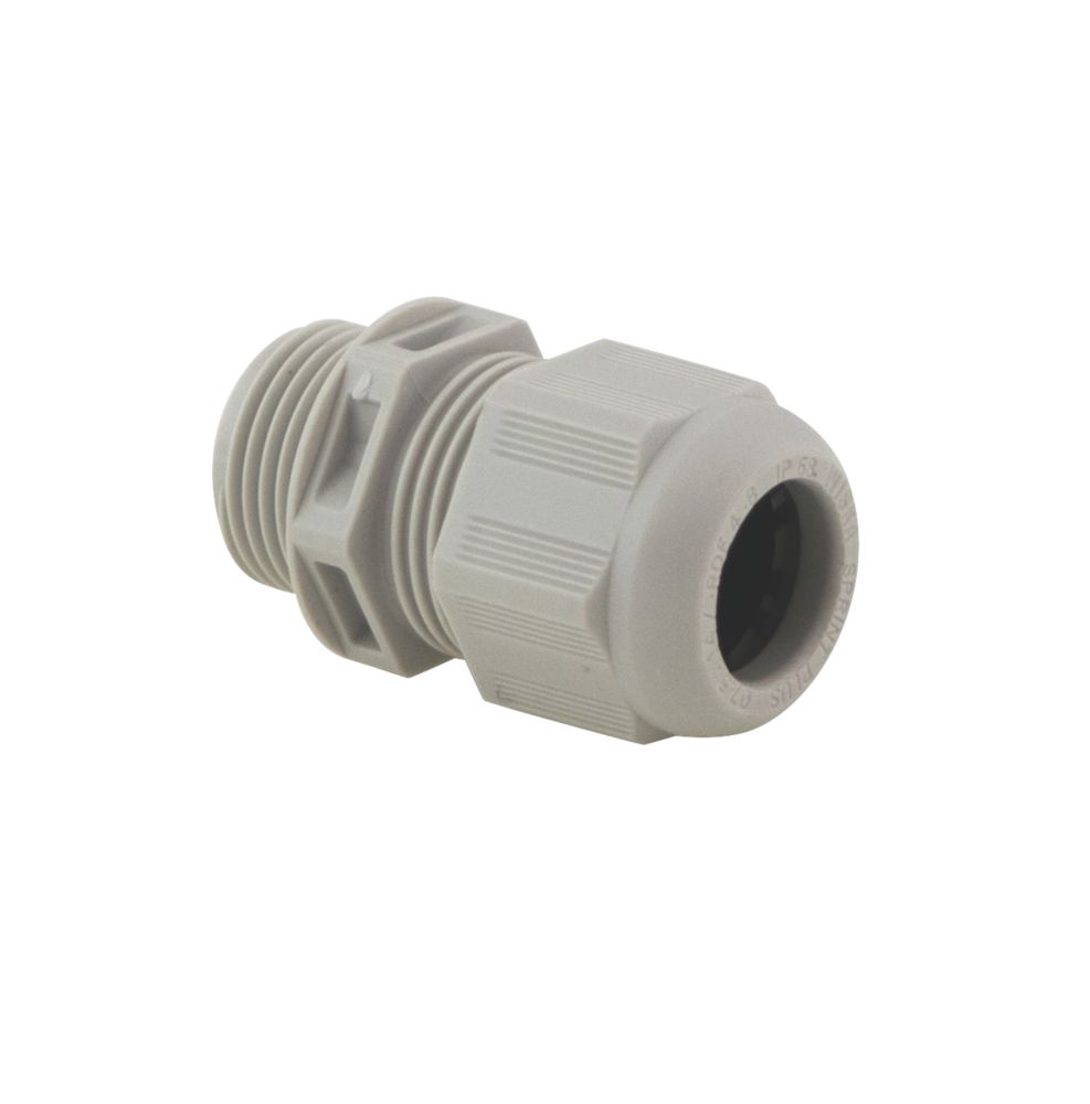

Glands for flat 6242Y cable are available, sealing to IP68:
Suitable for 1-1.5mm² Flat Single Cable:
Suitable for 2.5-4mm² Flat Single Cable:
As far as I can tell, 4 mm² is the largest available. I recently looked for, and failed to find, one for 6 mm².
