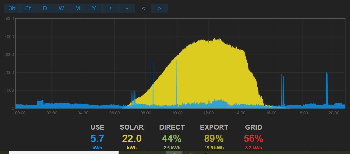

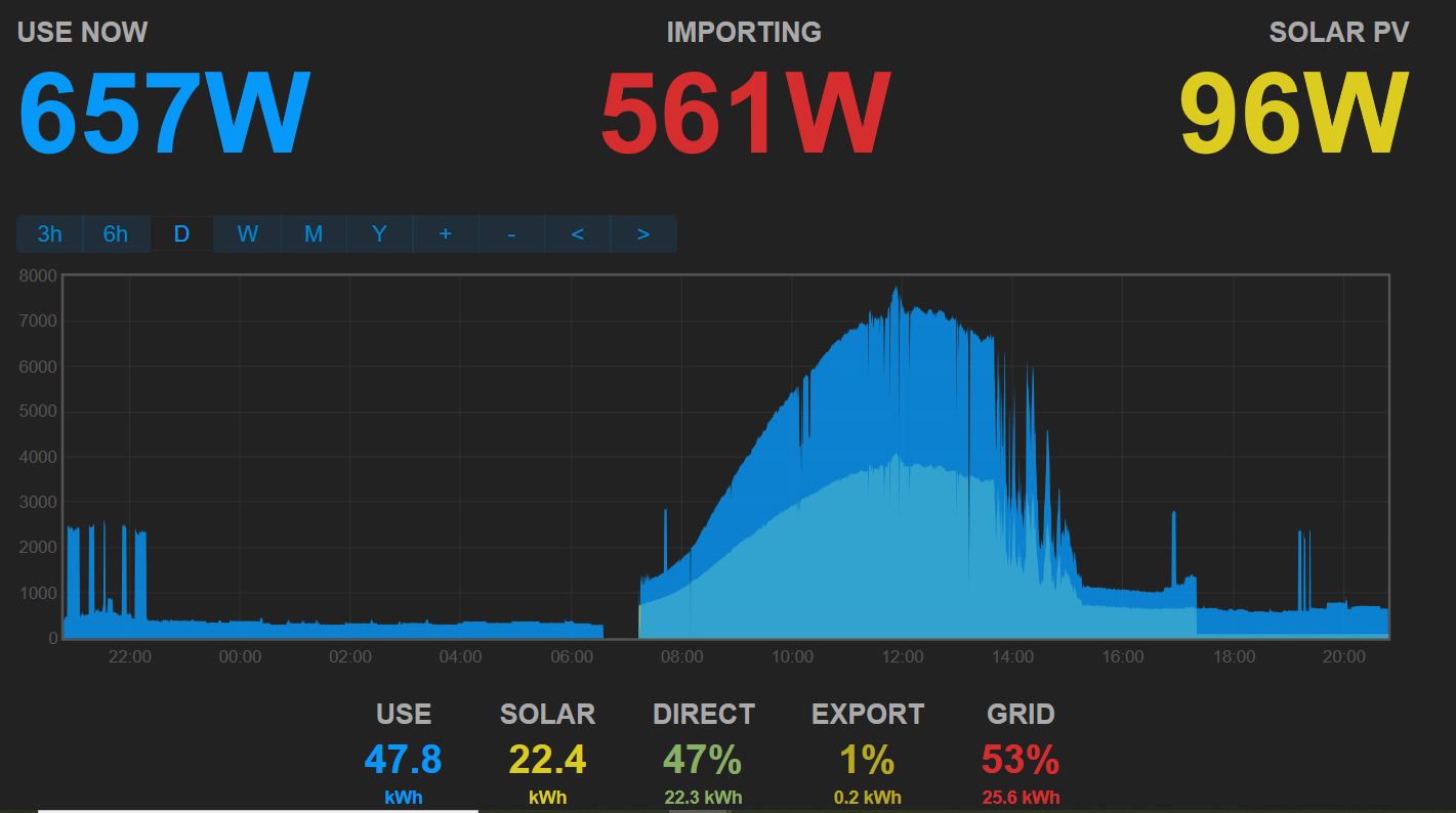

Here are what my consumption looks like on a normal day (before the problem), what it looks like today, and the solar reading from my inverter for the same period. Notice the solar in the haywire result is a completely different shape at the end of the day.
What a normal day looks like:
What today looked like:
The graph from my inverter from today. Notice that the shape of the graph is different at the end of the day.

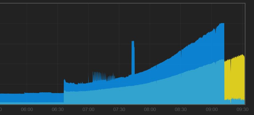

I’m surprised it yielded such crazy results. Here’s another screenshot of overnight/this morning, then I fixed it about 30 minutes ago.
Notice that the power usage jumps inexplicably about 6:40am. I can confirm there is no actual power draw like that, I think it’s the solar panels kicking in but getting multiplied massively. I’ve checked to see if I have a threshold set (if <x, assume 0) which might explain that, but I don’t.
Then when I fixed it around 9:15am, you can see how the usage has dropped dramatically. I would imagine a difference of apparent vs real power wouldn’t be so marked. We’re just a regular house, and haven’t been using our AC, so we’ve only been using fridge, lights, PC/TV, etc.

As I explained above, it only makes the decision about whether to use the assumed voltage or the measured voltage at power-up, so after it had decided, it stayed with it. If, in the meantime, it saw spikes etc generated from the energy stored in the transformer core as the primary arced, it’s anyone’s guess what would have been recorded as the voltage - hence the power.
You screenshot means nothing to me as there is no scale and I don’t know what the two colours represent.

Oh, sorry, blue is usage and yellow is solar generation. But it doesn’t really matter.
It would make sense if there was some sort of arcing resulting in an initial spike in voltage, meaning that it used a spurious voltage (e.g. 400V or something), but the vrms measurement graph was showing a flatline at 230V.
