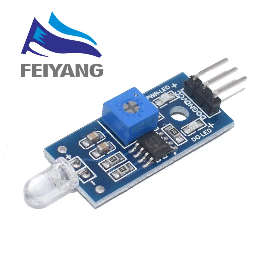

I’m trying to read Import kWh from an Elster A100C. I’m using the following sensor
I’m using a simple to sketch to get the information but I’m receiving garbage instead.

This is the module I have. It’s a receptor led with an LM393 comparator.
Sorry, really need the actual module as the data sheet should specify the interface.

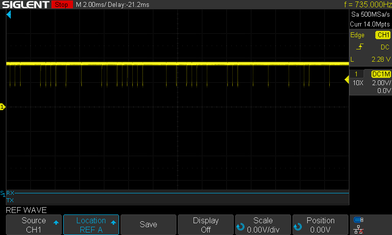

I have been experimenting with this, same problem I cant get it to work with an IR receiver that I have. I have managed to get a look at the signal though using a photodiode and it looks like the attached. I think that puts the fewquency of the pulses at something like 2.4kHz?
Maybe somebody who knows more about IR comms than me can point me in the right direction on what kind of signal this is?
