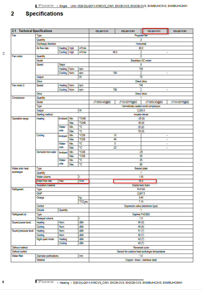

Here are the relevant pump/pressure/flow rates for your model - note it states capable of 46l/m (!) (which is 15.98kW @ ΔT5) at just under 30kPa
Newer Daikin Altherma 3M seem to have a significant upgrade on pump power I think comparing to the older “2” model:
Below, red is where you’re at from your reported numbers, green is max flow rate given low enough pressure drop, and blue is (the minimum) where you need to aim for at ΔT5 to get 11kW out of your unit.
At 62.3kPa, you should expect ~31L/m - I assume the “62.3kPa” figure has been given as the max pressure to get that flow rate for ~11kW - so you still need to get to 31L/m @ΔT5 to get ~11kW output (or increase ΔT)
Data book reference:
EB-DLQ011-016CV3_CW1-EKCB-CV3-EK2CB-CV3-EKMBUHC3V3-EKMBUHC9W1_EEDEN18_Data-books_English.pdf (7.9 MB)

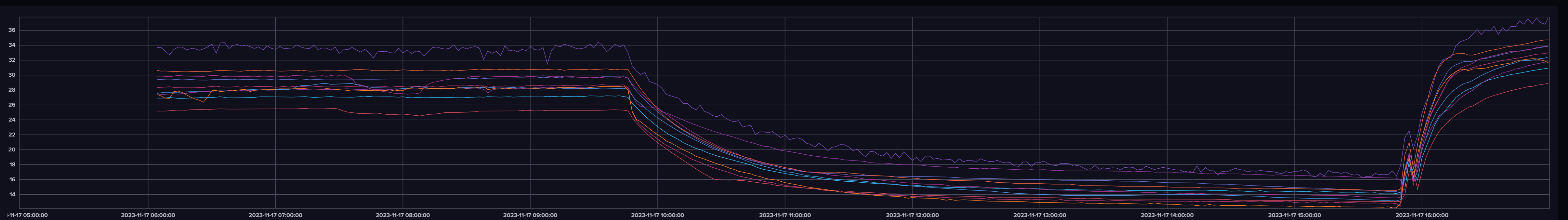

I’m about to embark on balancing my system. I’ve a gas boiler, but my dT is very tight as my flow is down at 40 at the moment. Boiler can’t go any lower than 43 (it’s a 35kW beast) and the return is 37, so it’s pretty tight.
Lock shields - I think they are Danfoss, for the most part, but haven’t a clue if they are any good. The rads weren’t sized - they were eyeballed by the plumber.
System is currently all open and I’ve instrumented each radiator, so I can track the flow, return and
mean temperature. (https://youtu.be/YUV8U6BC5oQ)
Here is a timeseries from Influx for today. As you can see, the warmer radiators are those at the top and they are closest to the boiler. I’m doing to start experimenting and actually tracking how the system behaves when I start to close down each lock shield.

I think the lesson here is to not be chasing dT of 5 across the rads? Is the happy medium for them to be the same as each other?
The one radiator I have fiddled with is the one in the bathroom, which is small, old and closest to the heat pump. On 1/4 turn of the lock shield, the dT is higher than average, but the mean temperature is lower than the rest. This suggests that I’ve throttled it down too much? Maybe give it another 1/4?
