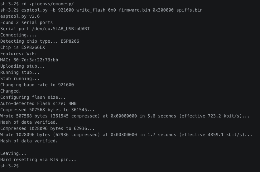

Next, I’ll show the simplest way I can find to make use of esptool.py, which uploads significantly faster than PIO’s standard, even with ‘fast’ settings, very useful if flashing multiple devices with the same image(s).
To use esptool.py a version of python must installed on your system, Windows users will have to make sure to do an install of Python.
Keeping within pio:
  1. Open a terminal using pio’s toolbar button here:
    34
  2. Type ‘pip install esptool.py’ and enter to install esptool.py!
  3. Type ‘cd .pioenvs/emonesp/’ to navigate Terminal to the compilation directory (.pioenvs/ is a hidden folder within the project folder).
  4. Type ‘esptool.py -b 921600 write_flash 0x0 firmware.bin 0x300000 spiffs.bin’ to upload at baud of 921600 bits per second, the serial port is automatically detected.
Sometimes 921600bps is too fast. See GitHub - espressif/esptool: Espressif SoC serial bootloader utility for alternative baud rates and other options, as well as the remaining documentation for esptool!
An example script to run the above commands would be like this:
esptool.zip (668 Bytes)
Put in the project folder, along-side platformio.ini, and run with terminal command:
‘sh esptool’
