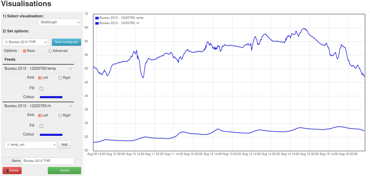

@Mike_Henderson : psychrographic diagrams are a way to appreciate the thermal comfort of a house. All you need is a simple sensor of temperature and relative humidity. The principle is to represent the absolute humidity as a function of temperature.
The graph is initially populated by 10 curves of relative humidity, represented in light gray. The lower curve corresponds to a relative humidity of 10%, the upper one to a relative humidity of 100%.
We then materialize the zones where it’s not good to be:
  • the too dry part (green) is the one below the curve of iso humidity 40%.
  • the parts that are too humid (red/orange) are between the saturation curve (100%) and the iso humidity curve (80%), in which the risks of development of moisture and fungi are high
    The graph is ready to receive the measured values. The calculation of absolute humidity for a pressure of 101325 pa (the atmospheric pressure at sea level) is relatively simple. You can find the formula in the code on github.
from a practical point of view, you just have to build multigraphs in emoncms and use them in this pshychrographic visualization to appreciate the comfort level of your home

@alexandrecuer: Many thanks for the explanation.
I already understood the purpose of the diagram and how to read it, what I struggled with was the configuration of the Multitrends.
With that bit of information I’ve set up a graph and I’ll look to adding this into my home dashboards.
