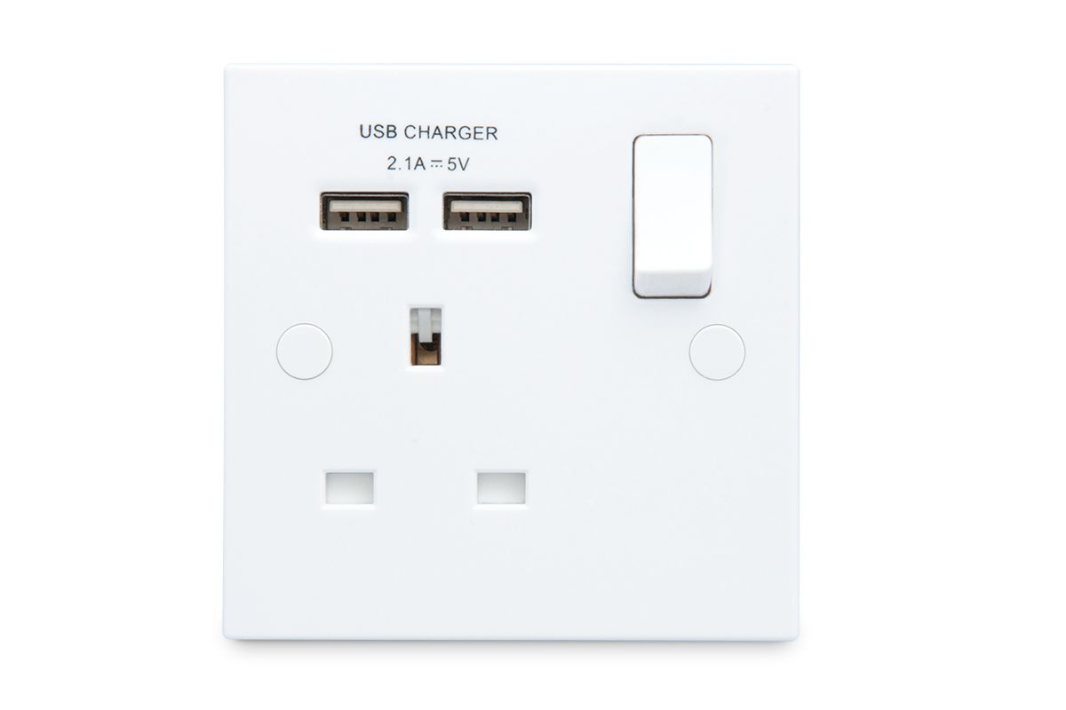

I have a double socket with USB ports next to the CU. At the moment it’s a legacy ethernet-over-powerline one, but I am going to swap this out for a generic MK one soon, not that everything is on wireless :slight_smile:
Ah yes, USB ports with the sockets seems like the way to go.
Does anyone know if they do a single socket with 2 USB ports?
Meanwhile I’ll check with Google.

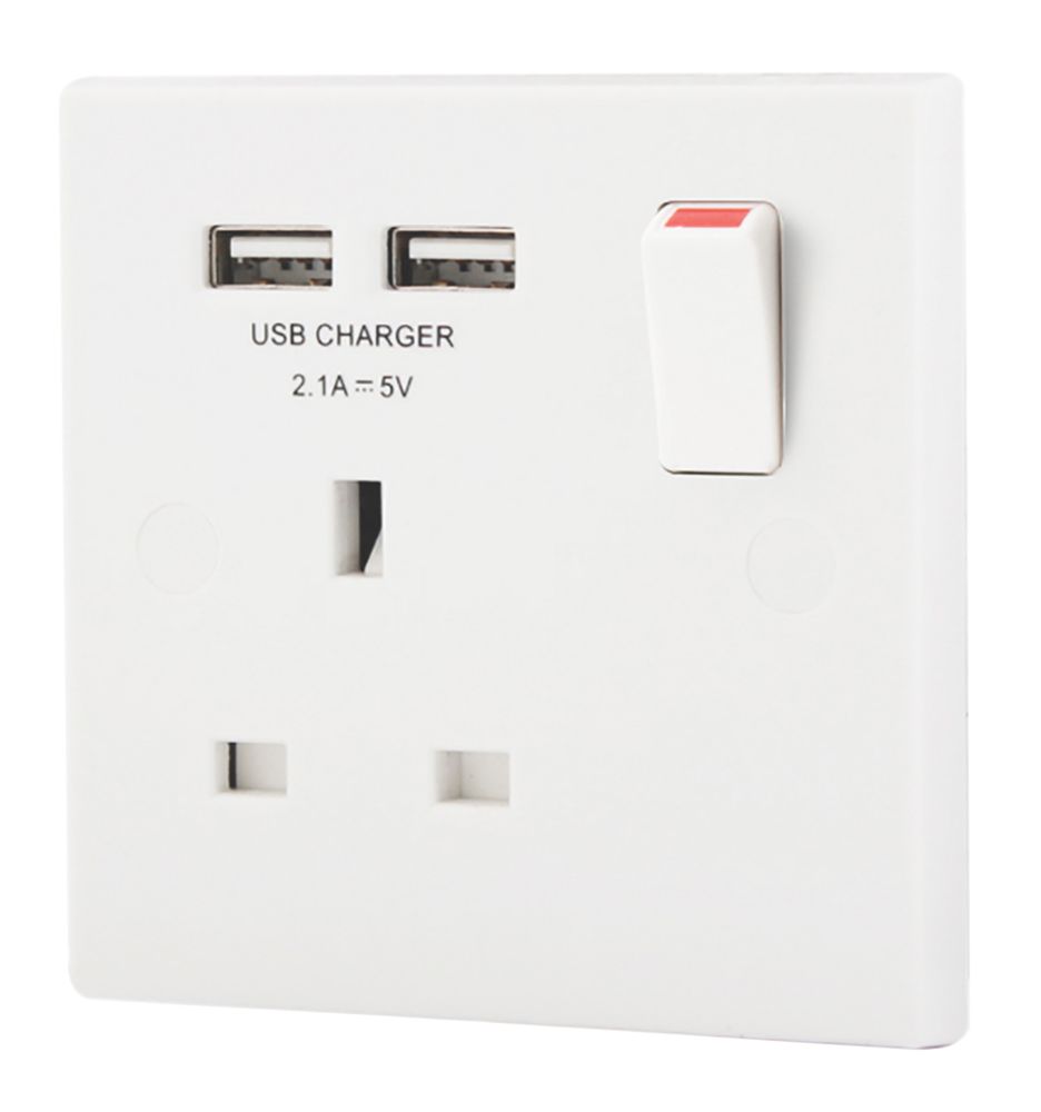

BG 13A Low Profile SP USB Switched Socket 1 Gang 2.1A maybe?
The above is total 2.1a output only though.
That whole section is useful: https://www.toolstation.com/shop/Electrical/d190/USB+Sockets/sd3240
If using a single socket with USB power, just double check there is enough clearance to use the USB ports when using a chunky wall wart, you might just be ok with the OEM shop sold AC:AC I’d think.
But these sockets appear to have the USB ports slightly higher than the LAP one.
and the’re available at B&Q’s too so you could measure one up before you buy.

Picked up the socket with twin USB ports this morning. Certainly a tight fit but looks ideal.
Socket with twin USB ports
