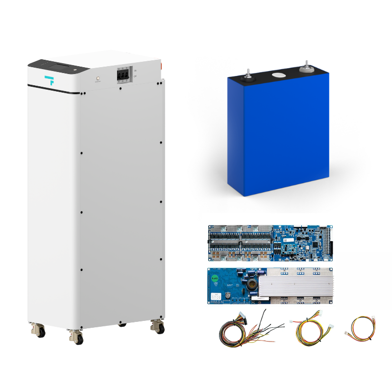

What KWh cost do you/would you assume for using the battery ? Very approximately a battery costs c £800 per KWh installed? So with 10,000 cycles before it declines significantly thats roughly 8-10p per KWh. That’s the bit I struggle with as buying electricity at say 12p cheap rate to store in a battery means a true cost of 20-22p? Which is not such an attractive saving. Clearly with Solar charging the cost is only 8-10ppKWh. (ignoring the cost of the Solar install/investment). Its a good feeling to see the bills come down and buys out a fair bit of uncertainty but I dont think that people I read here are evaluating this properly - please tell me I’m wrong!
15kw for £1.6k, let assume 10kw usable , so gives £160 per kwh. Install cost will be low if the inverter is needed for EV panels.
But totally cost very different of both the inverter and all electricity work is seen as a cost of the battery not PV installation.
