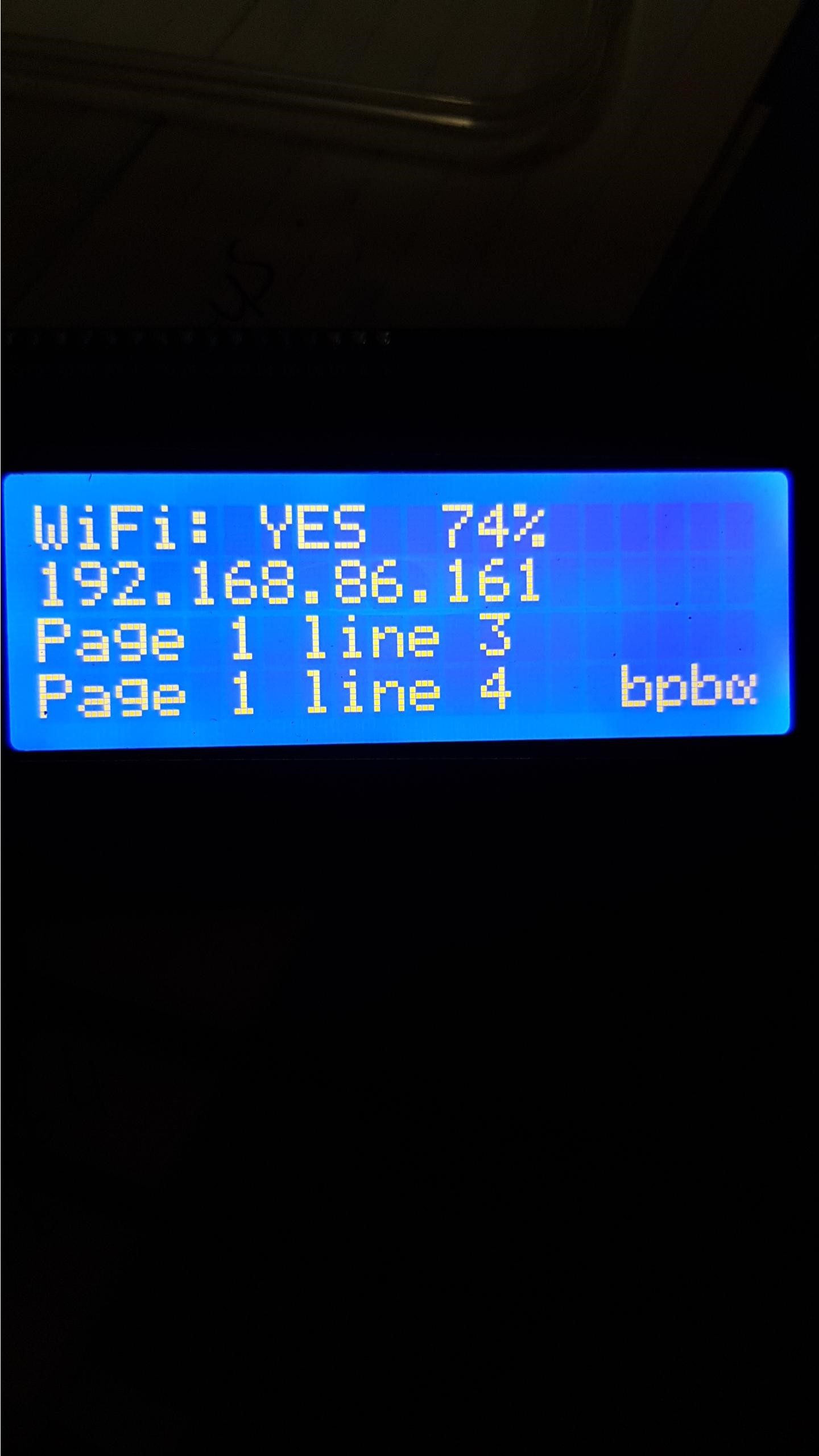

# Define display sizes
charCount = 16        # set to 16 or 20 chars per line depending on display used
lineCount = 4         # set to 2 or 4 lines depending on display used.
Aha!!!
Sussed it! (I think!)
It’s the comment that is wrong! It led me to change it to 20 for your display!
The “16” IS NOT the number of chars! It is the base for the int() function. We need to change that back to 16 and NOT use charCount eg
        # Init LCD using detected hex I2C address cast to an int
        self.lcd = lcddriver.lcd(int(current_lcd_i2c, 16))
[edit] That explains the int() concerns and arrives at a single address integer to be passed to the driver.

And it changes page 4,5,6,7,8,9…11

Made those changes. Did notice that changing it from 1 to 4 then the 4 lines work, reverting back to original only 2 lines work

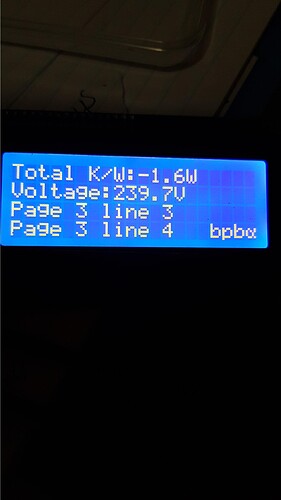

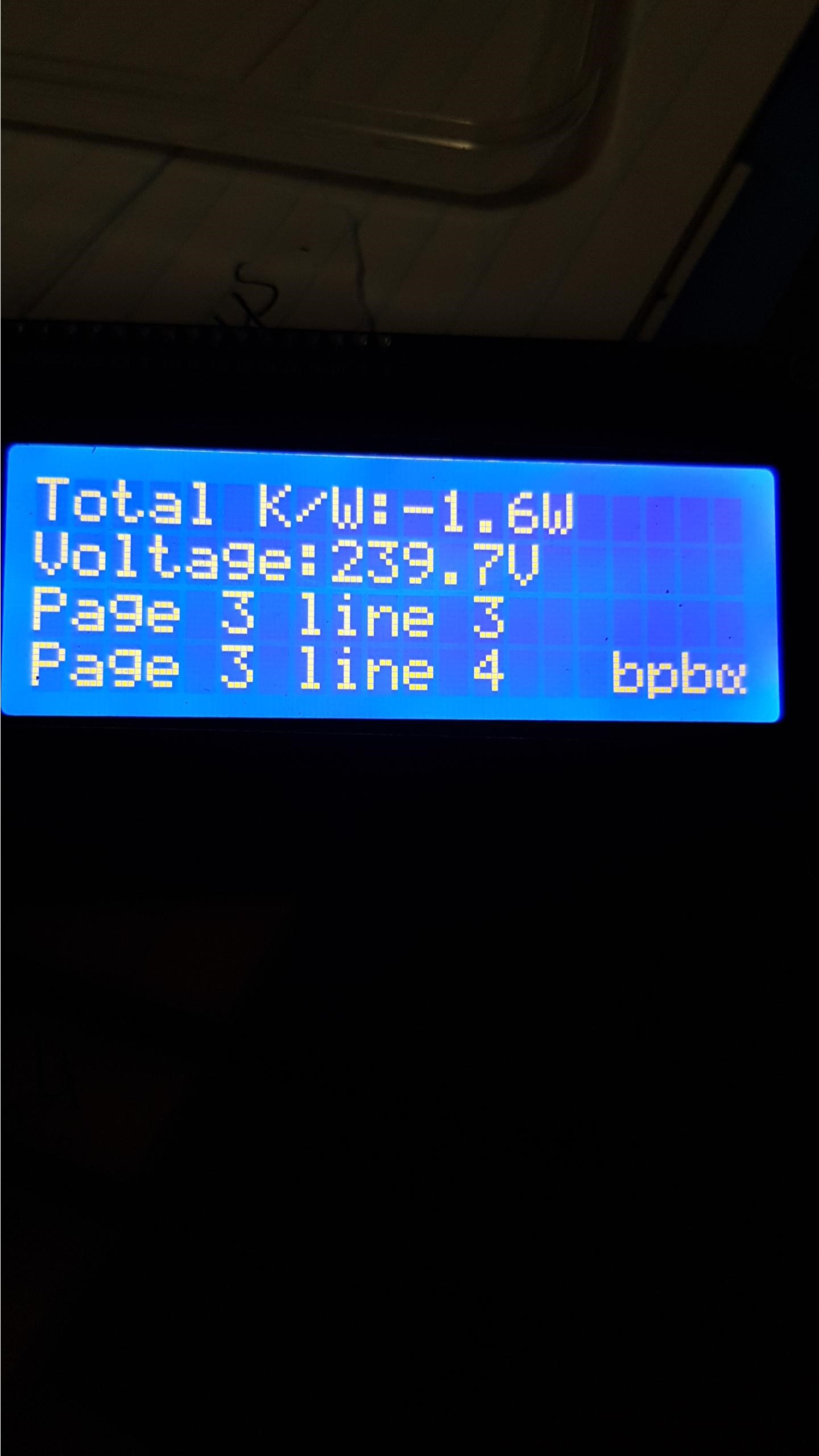

Pushing the button too quickly messes up the display,pushing it a few more times fixes it.
That is actually 5 lines! (on account of the ‘less than or equal to’: 0, 1, 2, 3 & 4).

@pb66 So if i understand all this, ill have to wright to all 4 lines on each page,or the info wont be cleared,when using the push button to a new page?
is there a possibility off adding this to the beginning or end of each page, it will clear all then display what is there?
 self.lcd.lcd_clear()

It looks as if that would cause the display to flicker, because updateLCD( ) is called from the main loop.
I’d suggest you write [space] characters to the empty lines instead. According to the tutorial I’ve been reading:
lcd[2] = " " * charCount
lcd[3] = " " * charCount
(Assuming you have charCount as Paul suggested.)
Or make it even more universal:
for i in range(2, lineCount):
    lcd[i] = ' ' * charCount
I don’t think it would be a good idea to use clear either. Presumably you do want to populate most lines most of the time and using clear then writing to many of the lines is possibly doubling the workload needlessly.
I would also recommend writing a empty line when you want it cleared, although I would do it slightly differently and just use
lcd[2] = ""
lcd[3] = ""
as each line would then get padded out to charCount later in the code
        # Format string to exactly the width of LCD.
        string = '{0!s:<{1}.{1}}'.format(string, charCount)
However, I would only expect you to have blank lines on one or 2 function specific pages, there is no point in having multiple 2 line pages if they can be displayed on one page and reduce the page count, which translates to fewer button presses.
