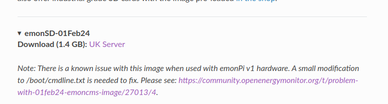

I’ve added a note to the download page for now:
