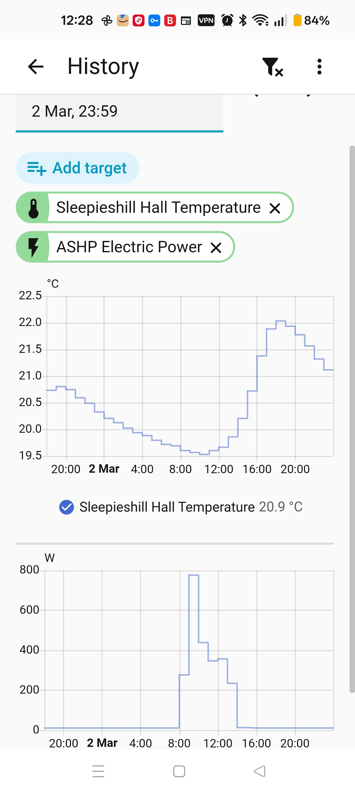

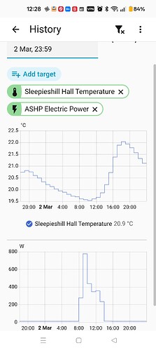

An image showing house temp and heat pump running. As house starts to cool it continues, starts to cool at 8pm and ASHP starts around 8am. House temperature continues to fall for a further 3 hrs, before recovering. At around 2pm the heat pump stops. But house continues to be heated, some of that maybe solar gain, but most is overshoot. The changes should start the heat pump 4 hrs early, but also stop when predictions thinks the house will be hot enough in 4 hrs time. This can be manipulated via the start and stop setting within the generic thermostat.

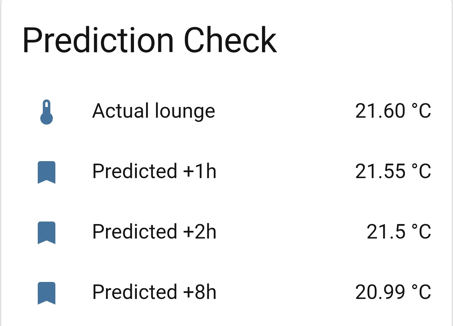

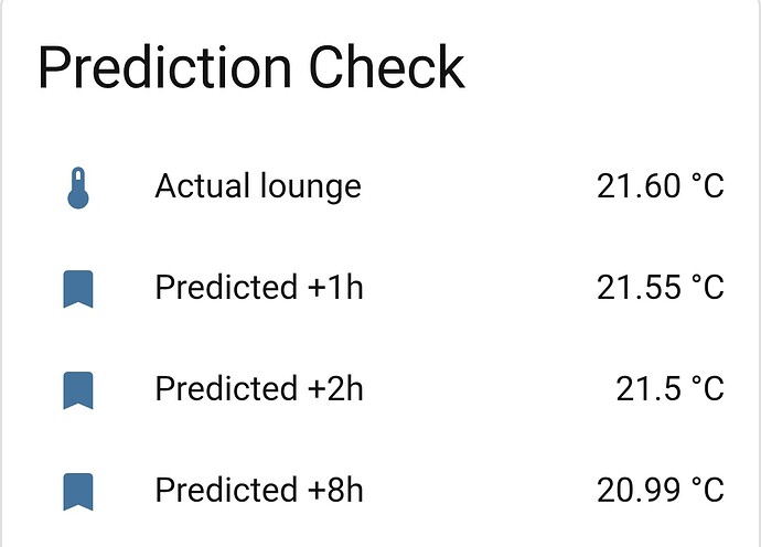

Snap shot of the predictions
After going down a bit of a rabbit hole have settled on a pretty simple system. Settled on heating only for now predictions.
Predheat does the indoor predictions at 1h, 2h and 8h. Some analysis shows it doesn’t model solar gains, which is ok. Most of our current heating was done at night, so costs the most as CoP is likely worse than day time as temperatures are colder. Got AI to look at previous history from home assistant and it seems the afternoon 8h prediction are pretty accurate, the morning prediction not very accurate if you get any solar gains it can be miles out.

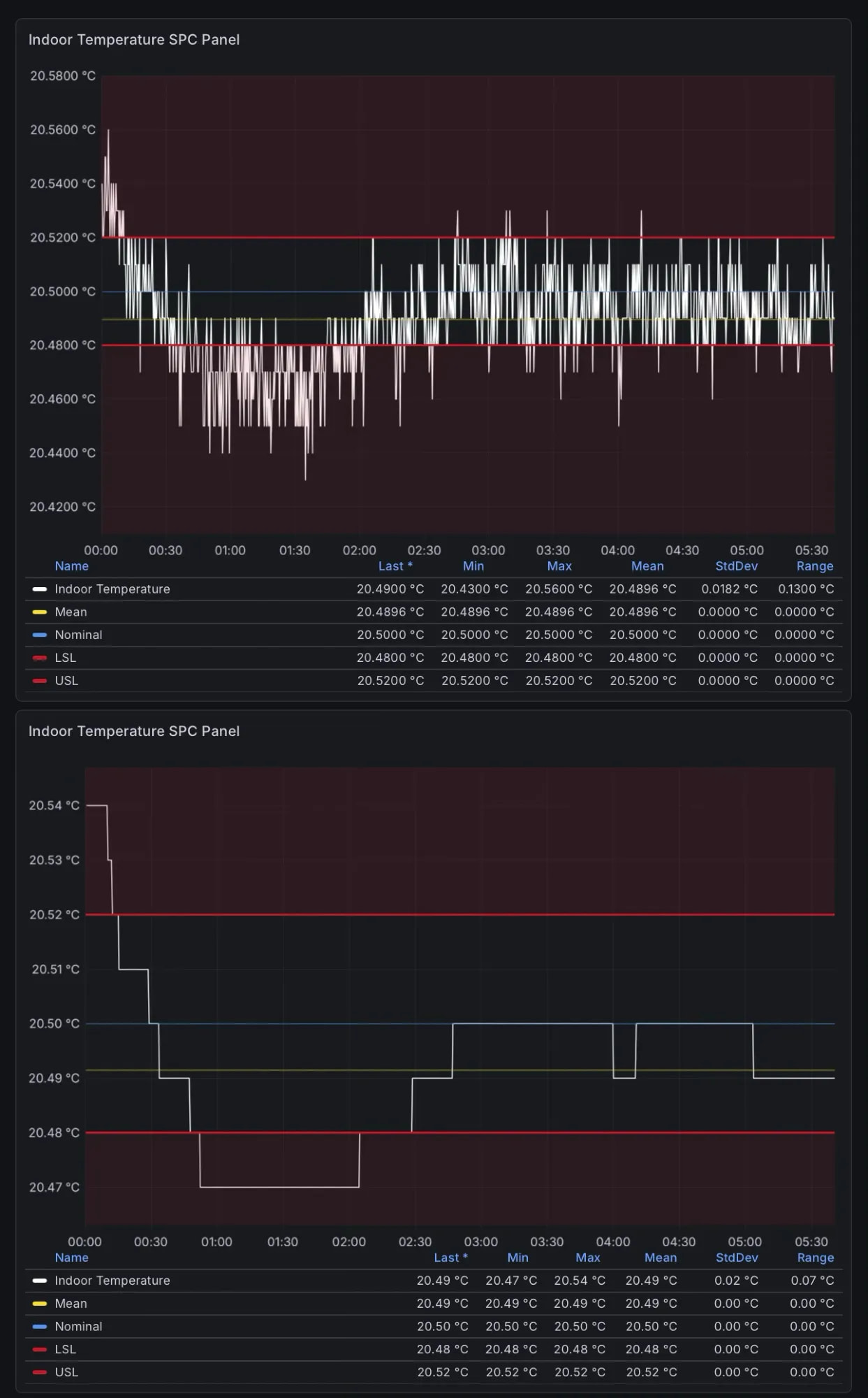

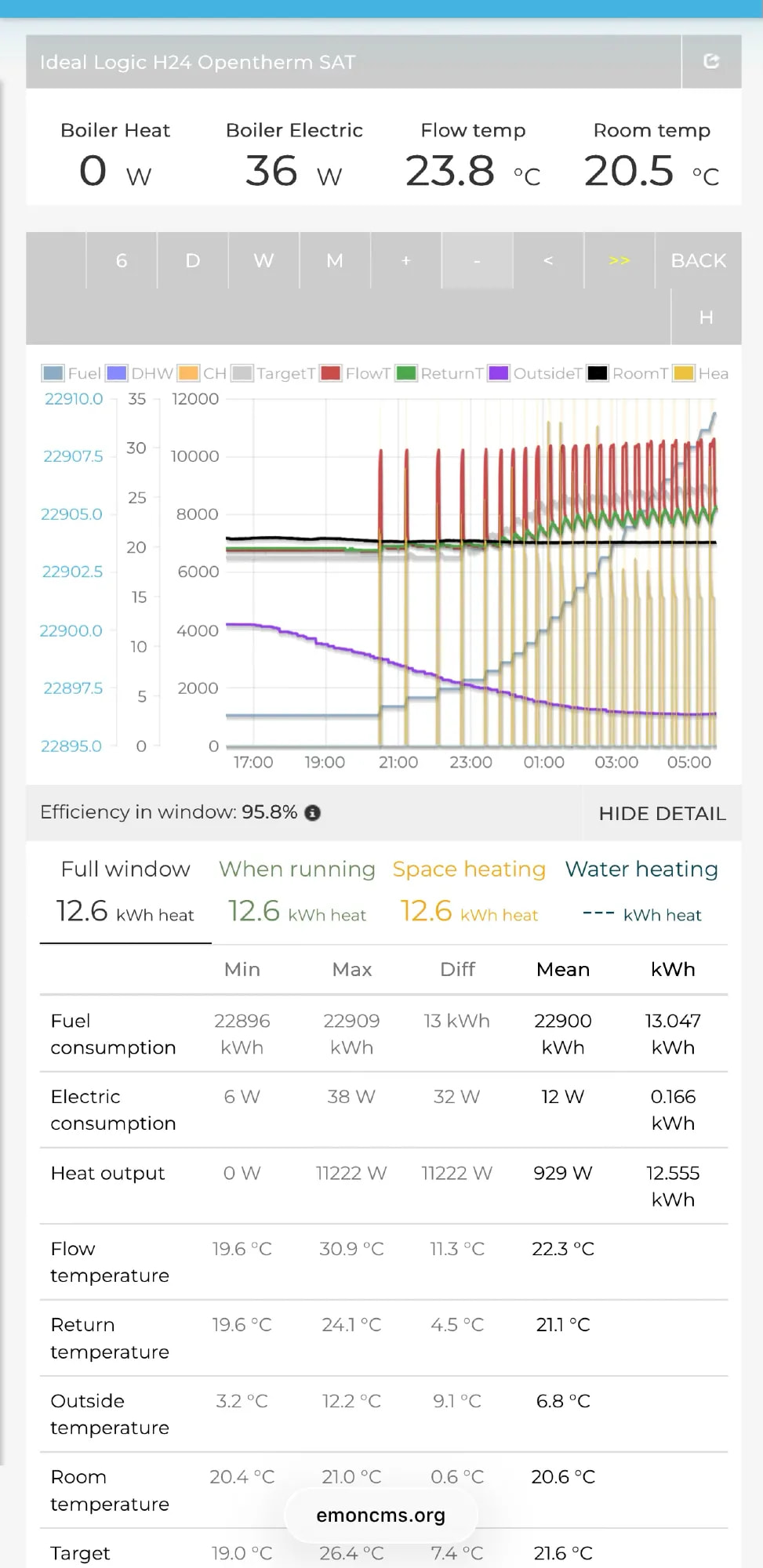

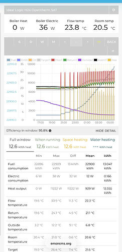

How about 0.02°C precision? :smiling_face_with_sunglasses:

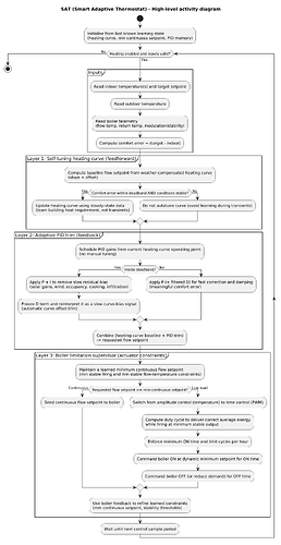

Pretty good - UFH/radiators? Are you using anything special or something else?

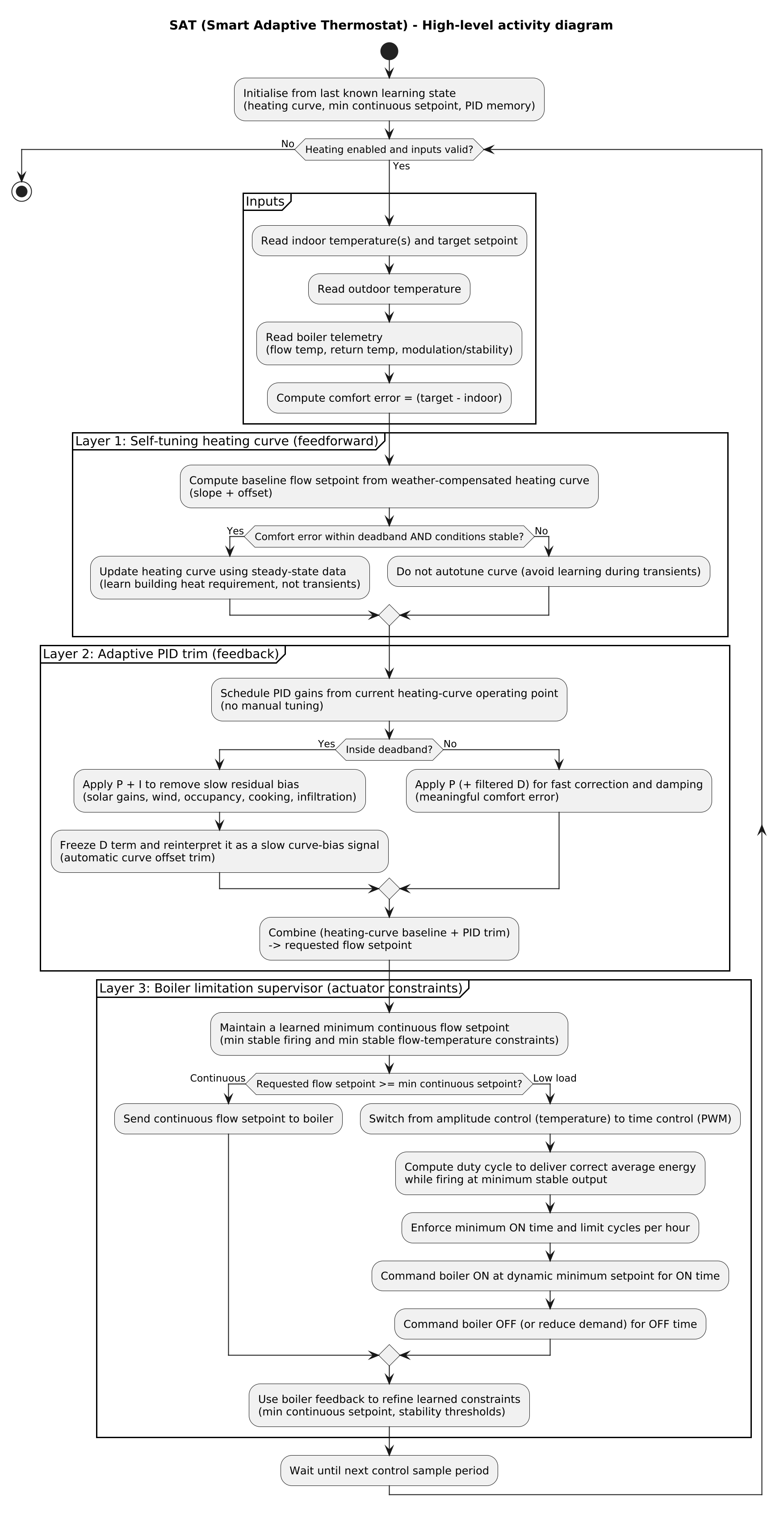

First guess, gas boiler, PID thermostat with radiators?
Yes, gas boiler + k3 radiators + open source thermostat (SAT - smart autotune thermsotat)
Looks good, unfortunately no use with low temperature thick screed floor, as response time is glacial. Tried similar when I had a gas boiler and had about 5 degs house temp variation with massive under and overshoot.

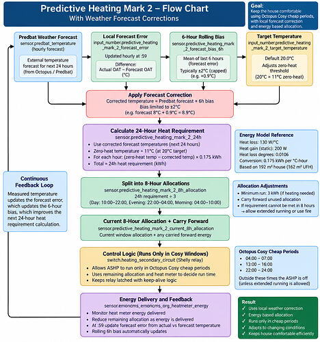

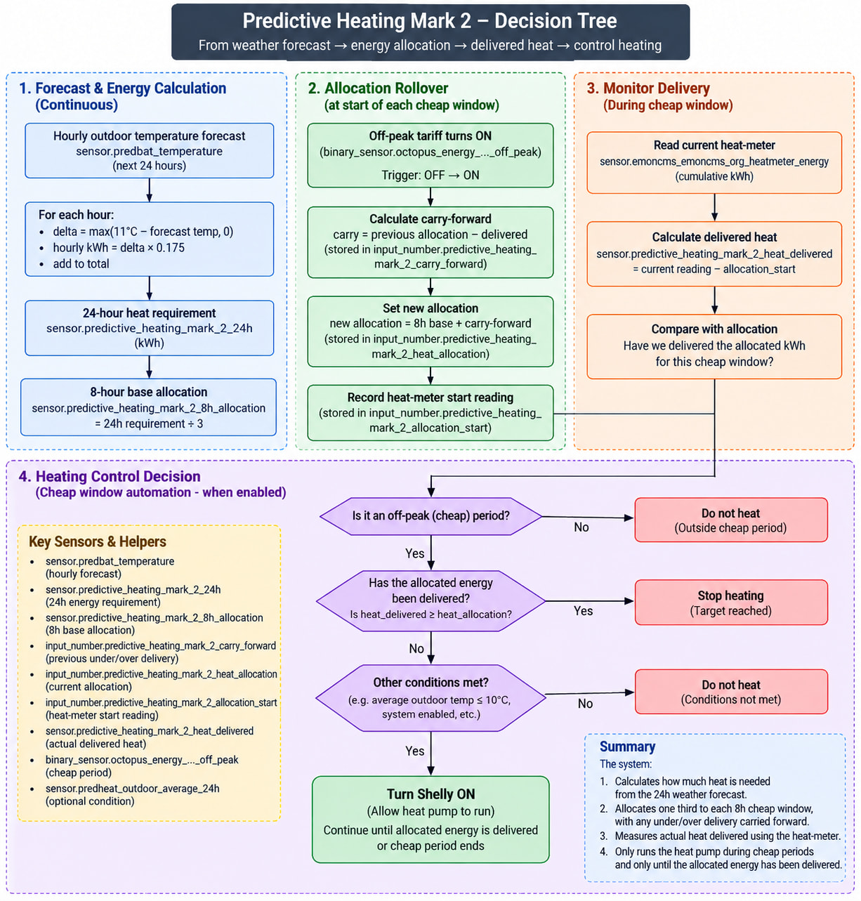

Did a couple of versions predictive heating and wasn’t really happy with either. So started from scratch and did an energy based model will allow me to make best use of Cosy or any other Octopus tariff I am on via the Octopus integration in Home Assistance. Using the Octopus cheap rate binary switch. Confining the majority of heating in Cosy cheap periods opens more opportunities to export energy.

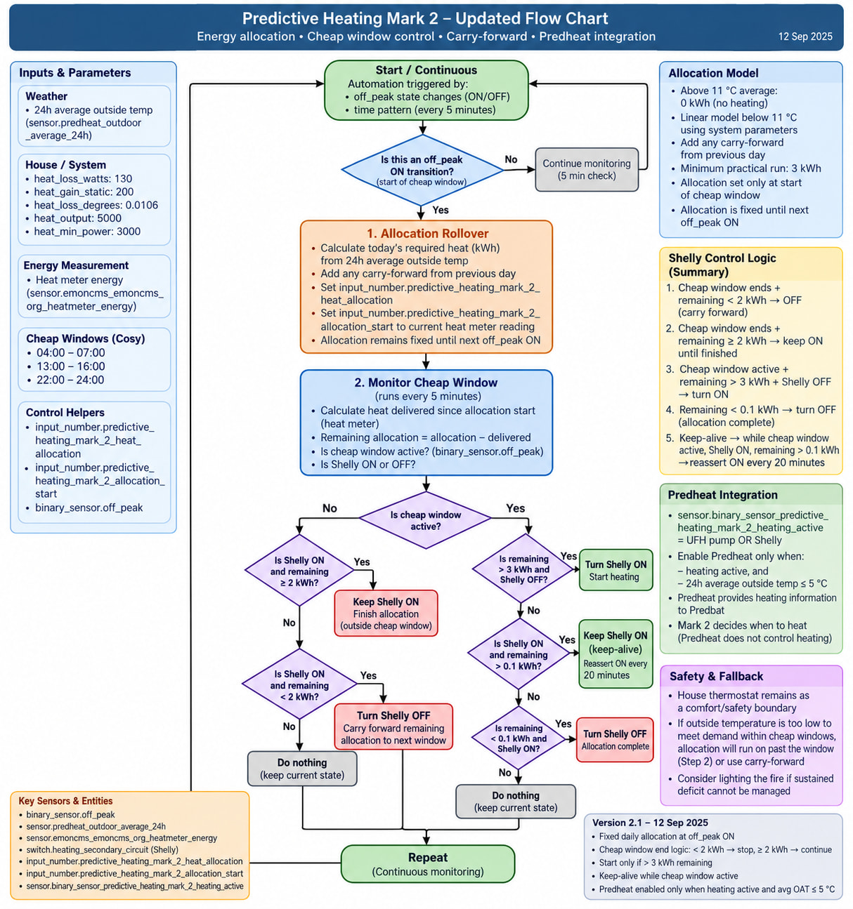

So although I use a 4kW heat pump, even down to around 2 degs we should be able to transfer the required energy to the floor in only the 3 cheap cosy slots. After this a normal thermostat and WC takes over. The flow chart looks like this. Currently in testing mode to ensure logic works and allocation rollover works as expected.
Thought about what the model looked like over night and made some upgrades, to make it a fully energy based system and doesn’t rely on room temperatures, but uses room temp and nothing smart as a fallback.
If we cannot sustain adding energy only during the cheap tariff window we extend the window and run on the battery. Below 5 degs we switch on predheat, it then tells Predbat to allocate energy for heating and charges battery stops export etc. see flow chart and text.

Running some tests I found an issue and issue was related to weather forecasting. Our forecast location is around 40 miles from us, and the other night, looking back at the the forecast it said we had a 2 degree cooler night time temp than actual. So we built a correction mechanism and this feeds into the start of the process to hopefully limit getting miss calculations of heat input data. We also added an adjustable internal target temperature to some variation in house temperature if needed.
