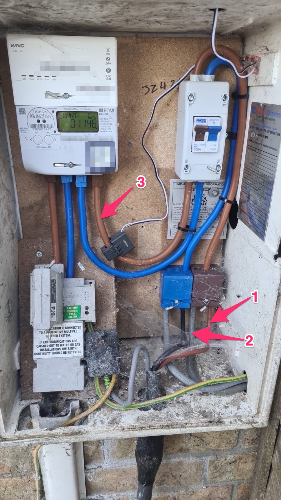

I’m planning to order an emonPi2 and just wanted to ask the community to help fact-check my understanding of what I will need in order to achieve my goal.
I’m an avid Home Assistant user and already have sensor data available showing total energy consumed (via Glow Zigbee CAD connection to smart meter) as well as Solis PV related import/export data.
My incoming mains connection splits into 2 via henley blocks. 1 cable feeds the main house consumer unit and the other feeds a remote consumer unit located within a campsite business which is 200m+ away. You can see the cabling in this photo:
My goal is to measure how much energy the campsite business is using, as at the moment it’s difficult to know considering the main energy consumer is a 12kW heat pump system in the main house.
I plan to order an emonPi2: 6-Channel Energy Monitor, Raspberry Pi 4B (so I have option of using wired ethernet), emonVS voltage sensor and power supply 1-phase (UK plug). But how many CT clamps do I need? Is 1x 100A CT sufficient fitted to cable 1 in the photo, knowing that I can deduct the reading from an already-known total usage figure in Home Assistant to figure out the house/campsite split - or would it be better to get 2x 100A CTs - fitted to cables 1 & 2? Or is there any sense in ordering 3x 100A CTs to fit on cables 1, 2 & 3 - despite an existing CT being on cable 3 for the Solis hybrid inverter?

Welcome, Olie, to the OEM forum.
I presume first of all that you want your emonPi2 with the RPi 4B option - not a separate RPi 4B.
Just a single 100 A c.t. should be sufficient, but there will be a time delay between measurements from the emonPi and those fetched from somewhere else. If all you’re interested in are daily or weekly totals, that is unlikely to be a problem. But if you want the consumption down at the resolution of the emonPi - every 10 seconds - then for peace of mind I’d have a c.t. on cables 1 & 2 out of the Henley blocks. I see absolutely no need for 3 c.t’s. (If there was a difference, which there will be, albeit small, you’d worry about which to believe.)
Thanks for taking the time, Robert. Based on your reputation around these parts, I’m now confident enough to proceed and will order with 2x CTs.

So, if the “campsite” cable runs 200 m underground, I would have put a separate MCB and a 100 mA RCD on there for protection and isolation, and I’d have used a 2-core */SWA/PVC cable and earthed the armour, but the isolator and the Henley blocks are sealed so the installation must have been signed off by somebody.
Do you know what is on the other end of that cable?
