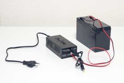

I dont know the power consumption but thought you may be interested in these DC UPS’s, i bought two of these, one for my fiber ONT and modem and the other to keep my IoTaWatt and Pi live in the event of a power cut. i have also got a multi voltage dc to USB converter to drop the power to 5v.
The IoTaWatt power consumption as measured using a plug in AC monitor is 1.2W.

The solution does sound good. However, it adds bulk to the solution. I am trying keep everything within the junction box.
