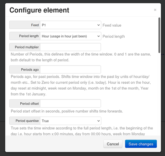

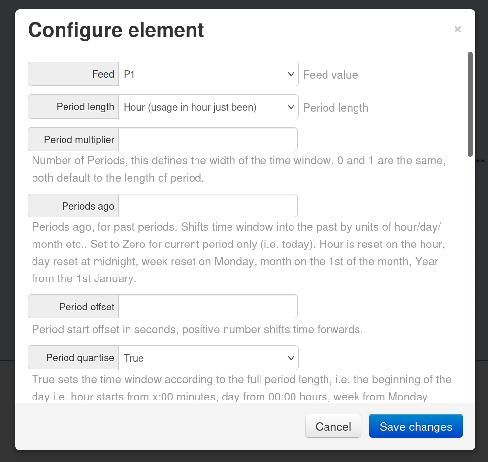

wh, I’m trying to seen if latest hou I have consumed or injected to grid, I have this value in realtiem and accumulated but I don’t know I I can shwo on a dashboard the balance of latest houre since minute 00 of latest hour

no, we have powercosnumption and ñpower injection, and our tariff is that consumption inside same hour is compensated, for this reason I liek to see the differencie between this value but only latest hour

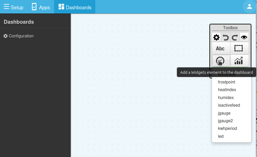

Sorry, where is thsi widget and what is the name, I can’t find…
