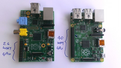

I really hate sounding dull and now realise my knowledge of this subject is so poor so forgive me all. I have purchased the pi hat, do I still need a raspberry pi to connect it to to make it work or is it a complete unit that I can connect my heat meter and electric meter too.Thanks for any replies even if it’s to say give it up.
A Pi “hat” is a daughterboard for a Raspberry Pi. So yes, you need a Raspberry Pi.

Can I use any pi with it model 3b onwards?
I can’t say for certain - @glyn.hudson or @TrystanLea can confirm, but I suspect any Pi will work.
Any Pi from Pi2 onwards should work fine. I would recommend using our emonSD sd-card image so you can start with emonHub and Emoncms pre-loaded:
