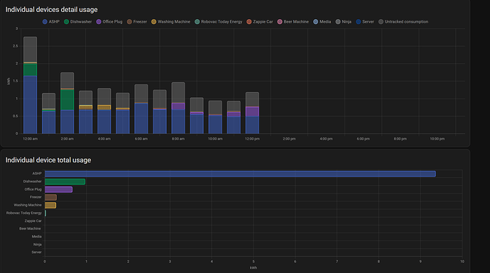

Ok, your graph is showing energy usage, that is kWh, not power consumption, kW. If your HP is cycling, then it won’t be using 900Wh per hour, or 0.9kWh, it will be using 900x(fraction of an hour it’s actually running) eg 30m on, 30m off or 50% duty cycle, so 0.9kW x 0.5hr = 0.45kWh. This could explain this discussion! Be very careful to distinguish kW (instantaneous power) and kWh (power over a period, or energy!).
Really big thank you to the you and the others. good point on the Kwh and the Kw, i did over look this!! the model I have is
Ok, So something is very odd. As per my screenshot I monitor house power via the zappie CT clamp and smart devices. I’ve switched the pump off this morning to get the house base load. The house base load is 371w avg (fridge not running) and there is 66w I can’t account for. Looking at last nights longest cycle the Zappie house load was using an avg 1064w and of that the ASHP is around 643w over the same period. Each way I look at it, my pump doesn’t seem to have a min heating load of 900w. My home assistant has an usage a day since the 1st of Jan as 17Kw a day and 12kw daily avg in December. Matter of interest what would a 8kw pump run at?
Well, nobody else’s 9kW EDLA09DA3V3 runs at less than maybe 850W, and many of those installations are using MID-standard monitoring, so I can’t see that level of conformity and accuracy being wrong. The 8kW Daikin does about 400W minimum I believe, as you might expect from it being an actual 8kW, unlike the 9kW which is a barely concealed 16kW.
Something doesn’t add up somewhere. Could you maybe post a diagram of your electrical circuits and the points they are monitored at? And is your HP a big silver b-st-rd, or is it beige?? Just asking… there has to be a reason for this discrepancy if the instantaneous power consumption is what your meter says it is. How do your meter numbers compare with your actual electricity meter?
