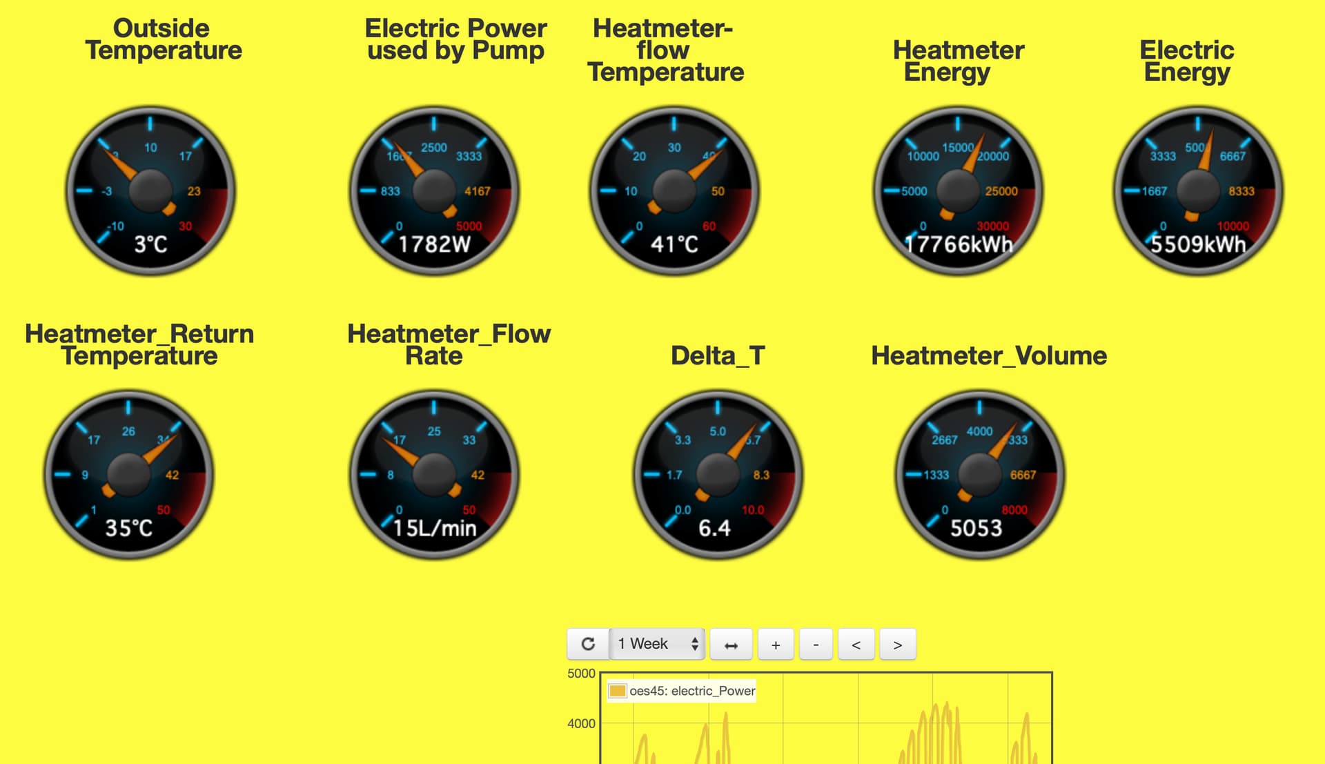

What are you using to collect the data you provide? OEM gear or something like ESPAltherma?

@John I had the Level 3 Heat Pump Monitoring Bundle (emonHP) installed by Octopus.

This example shows my pump in defrost territory but managing to break out of getting into a loop. I think this is because of the modest workload required of it in those conditions. Notice that the flow rate reduces shortly after the start of a cycle - perhaps because the pump is trying to respect meeting the specified wide DT.
This system has a design heat loss of 7.5kW and 50C flow at -2 degrees outside, but I find that my rads can support being driven as cool as shown in my settings. My typical heatpump output (3kW) is enough to keep my house at a steady, comfortable temperature.
