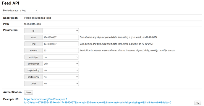

Welcome, @scshih, to the OEM forum.
Have you logged in to emoncms.org and looked at the Feeds page? On this page is a link
Feed API Help
The link leads here:
If you click the drop-down for “average”, the choices are No & Yes. Therefore 0 = No & 1 = Yes, and I think the value returned will be the average of all stored numbers between start time and end time over consecutive intervals of “interval” seconds.
