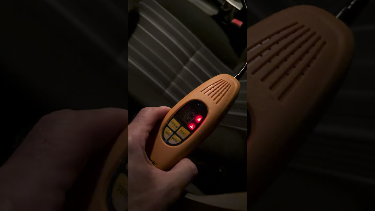

Would you like to borrow an R32/R134a sniffer @kiprasbiel? (heated diode sniffer that detects flourinated gases)
If you’re in Vilnius you can visit and pick it up from Krokuvos g. If you’re elsewhere I can post it. You’ll soon see if a flare is leaking.
I’ve also got a vacuum pump, gauges, and flaring tools if you want to pump down the unit (recover the remaining gas to the outdoor unit, seal it inside, then rework the connections yourself. You still need to refill the system though; so might as well ask any of the AC installers to weigh out the existing gas and add the correct mass again once the leak is fixed.
This is the leak detector looking for a leak in our mini split - it was not my flares but instead a factory braze that was leaking:
That would have passed a nitrogen test.
And here is condemning the evaporator in the car leaking like a sieve:
Sensitivity limit is 3 grams per year in still air from a joint. Hitting 7 inside the car says it’s empty within a month or two. Propane fill incoming for that one. :wink:
