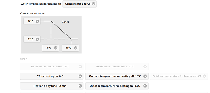

SYSTEM DETAILS:
  • Heat pump: Panasonic Aquarea 12kW R290 (WH-WXG12ME5)
  • Buffer tank: [100 liters]
  • Distribution: DAB Evosta 2 pump to 4-floor distribution circuit
  • Radiators: Aluminum, single-pipe connection per floor
    * Floor 1: 4 radiators
    * Floor 2: 2 radiators
    * Floor 3: 4 radiators
    * Floor 4: 4 radiators
  • Location: Spain, Palafolls (Mediterranean climate)
  • Winter temps: 0-15°C typical, occasional -2°C

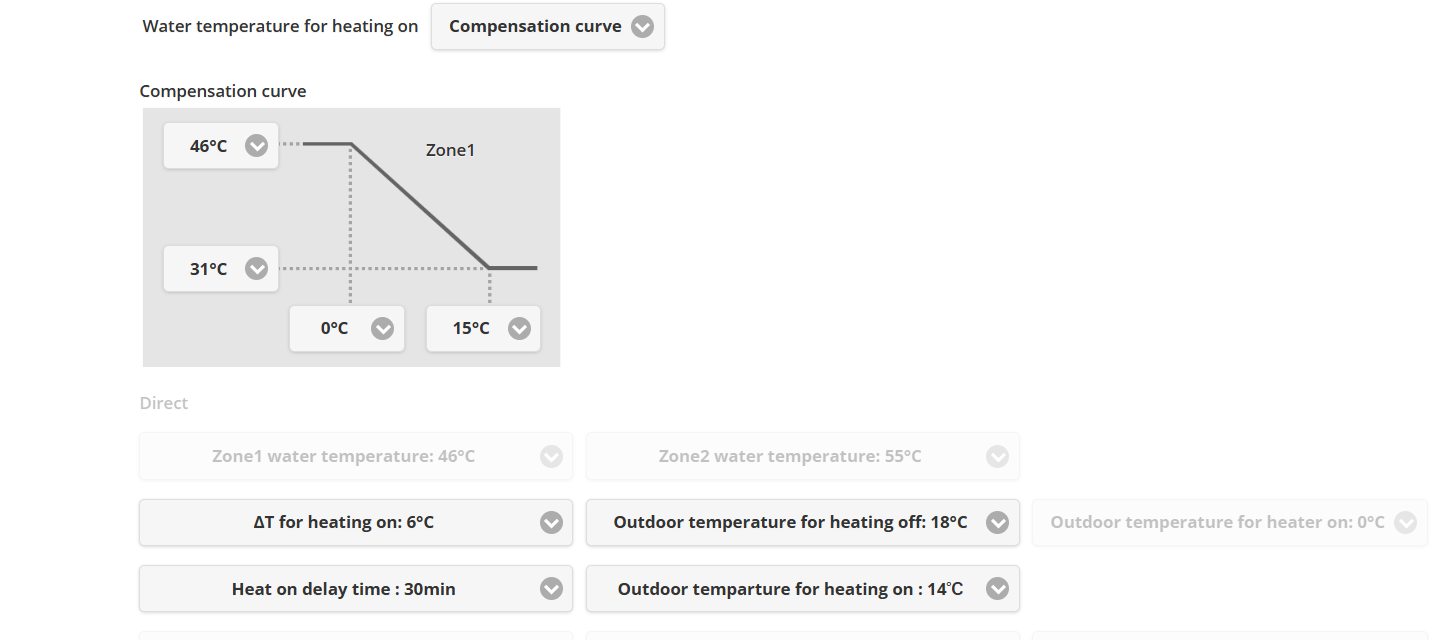

CURRENT SETTINGS:
  • Compensation curve: 46°C @ 0°C outdoor, 31°C @ 15°C outdoor
  • ΔT for heating on: 6°C
  • Heat on delay: 30min
  • Heating OFF outdoor temp: 18°C
  • Heating ON outdoor temp: 14°C
  • Control mode: Weather compensation (internal thermostat set to 24°C)

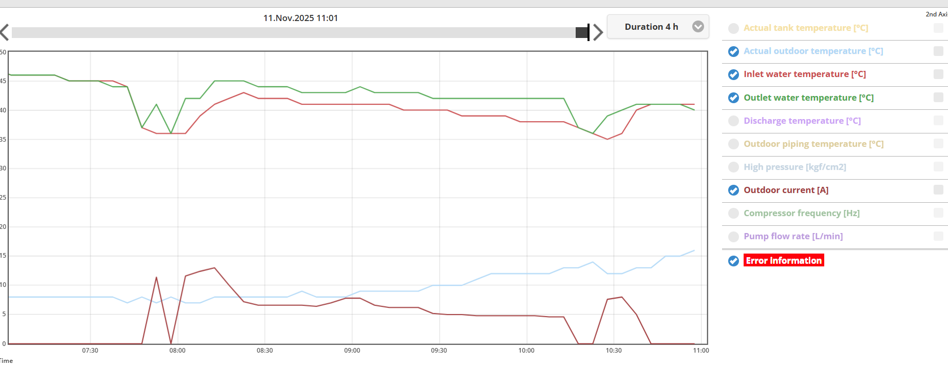

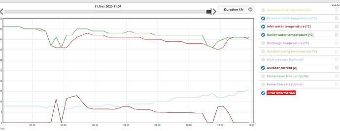

PROBLEM:
Currently outdoor is 9°C at night, indoor is 19°C (target 21-24°C), but
system keeps cycling on/off. Looking at my monitoring graph, I see:
  1. Inlet and outlet temperatures often match (Delta T = 0°C)
  2. Outdoor current drops to zero frequently (compressor stopping)
  3. System stops heating before indoor reaches target temperature
  4. This creates temperature swings and discomfort

im trying to figure out the best setting to prevent the pump to stop cycle all the time, like to maintain the temperature, currently configured to internal thermostat, setting temp to 24, but since the thermostat is in the kitchen and the distribution circuit is also in the kitchen, kitchen heats pump faster, so i turned down the radiator in the kitchen to make it similar temp as other place in the house.
Hello Kunan,
I suggest you remove the buffer tank and secondary pump and run the system open circuit, with the Panasonic internal primary pump suppling the radiators directly - you could repurpose the buffer by repiping it inline (2 pipe connection) on either the flow or return as a volumiser, which may help increase system volume if need be.
I would also suggest you use pure weather compensation rather than any room stats if possible, with maybe TRVs just in bedrooms to allow for cooler temperatures, but it’s important that the bulk of the system is open circuit with no third party controls. You will then just need to dial in the weather compensation curve to suit, which will depend on how the radiators are sized relative to required load (bigger rads need require lower flow temperature). This should give you a simpler, more efficient system with less cycling etc.
Also make sure the system expansion vessel is sized and set correctly.

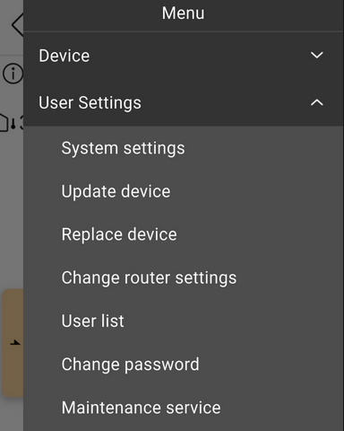

Then you need to go in the Comfort app, select your device, click on the hamburger menu in the top right, select User Settings, select Maintenance service. There you have to Terminate the existing service (the installer’s service) and add your own, based on the account you’ve created in the first link. Make sure to check that you don’t void your warranty if you remove the installer’s access.
Thanks for the fast and thorough reply. But yes, sadly, it would break my warranty… I feel like Panasonic really lacks in “modern” control options. So I guess I would have to go to my cellar and play with all these settings using the main block.
No problem. You might need to put the block in maintenance mode for some of the options. You can find the details in the manuals I posted in the first post.
