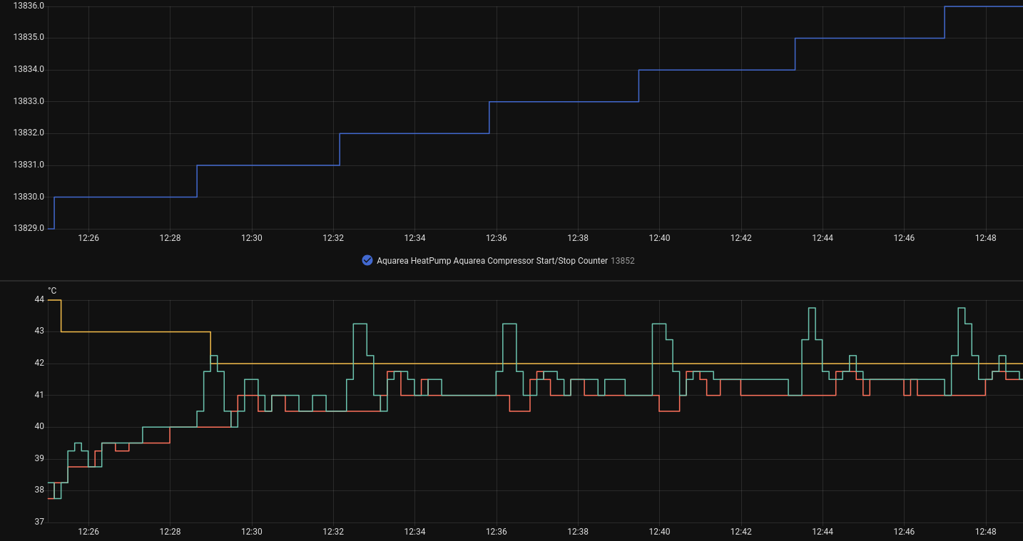

Since installation (by an official panasonic installer), the heatpump is unable to heat DHW above 50C (maybe 52C). The installer basically said that the heatpump will never be able to heat that high and I shouldn’t bother. The manual says otherwise and I have a feeling the guy doesn’t know much because when he was servicing the pump he was constantly on the phone asking how to check stuff from some other guy.
This is the behavior I have observed:
  • When setpoint is 45-50C - DHW will heat up to around 44C, then compressor starts turning off and on as it tries to hit the setpoint and it can be quite a few offs and ons before it does so (if it even reaches).
  • When setpoint is 40-45C - DHW will heat up in one go. Delta is set to 10C. I tried changing the Delta to be more or less, but that doesn’t help. It seems that as soon as the DHW temp reaches 44C - the heatpump is just unable to pump heat into the DHW tank.
I have Homeassistant attached to it via heishamon for monitoring and this is what it looks like https://i.ibb.co/qLxwftnX/image.png The top graph is the Compressor Start/Stop counter and it’s climbing like hell. Bottom is the temperature graph, mostly interested the green (Outlet), red (Inlet) and yellow (DHW) lines. At first it climbs and maintains the the temperatures until around 16:00, when the DHW hits around 44C and then it just stops, the compressor turns off, then after a minute turns back on, then off again and is now stuck in that cycle until DHW time ends or I switch it off.

The coil area may be part of the issue. The link to the graph shows flow temp from the ASHP is only getting to 53ish degs and is then being told to stop heating. It should be going up to around 60, unless, something is triggering it stop heating. Is the trend you linked to, for a set point of 43/44 degs?
It is rare for an R32 to get DHW hotter than about 50 as your installer says, which is what you say you see. The flow temp from the ASHP may hit 60 but then you have distortion caused by the heating coil, so cylinder temperature will never get there. The smaller the coil area the larger the distortion. You have about 10 degs difference in flow temp and cylinder temp so getting to 50 is about your limit.

The trend I linked to is from when the temp was set to 60C. It looks even weirder when it’s already at 44C when it switches to DHW mode: https://i.ibb.co/4nnz2Bkx/image.png It just oscillates around 42C, doesn’t even try to go for that 53ish C it did when the current temp was below 40.

Hmm I think this may be significant. In the output you included in your original post, something stopped the heat pump when LWT hit 53degC, and it may not have been your DHW tank temperature. I couldn’t readily find an Aquareus operating manual on the Interweb, but are you sure there isn’t a factory setting in your controller that is somehow limiting LWT?

I found an installation manual for a split Aquarea [here] (Panasonic WH-SDC0309K3E5 Installationsvejledning (Side 28 af 972) | ManualsLib) - there are possibly others there too. The term used for “LWT” is “circulation water temperature”. Yeah, the link says “Danish” but the manual is multi-lingual!
That manual is also for an R32 HP, and the page I’ve referred to has configuration instructions and a graph for a booster heater usage. That suggests 53C from the HP, with the booster taking it to 60C.
The KIT-WC09K3E5 is indeed a split, the spec sheet is available here.
There’s also this monobloc installation manual here, which again talks about configuration of booster heater for DHW disinfection, which for sure gets you to 60C. It’s somewhat easier to read than the other one. There doesn’t appear to be any means of setting the DHW “circulation water temperature” - I assume the HP does what it has to do i.e. max it!

@Kazunekit p28 of the manual John links to makes it clear that 53degC is the maximum LWT temperature that you can get using the heat pump alone, and that you must have an immersion heater to go any higher. This appears to be a hard constraint for this particular model of heat pump. So your options are to fit an immersion heater, or to replace the heat pump with one that can produce a hotter LWT. (If you can only get your LWT to 53degC, needless to say your DHW will be even lower, because the heat pump switches off as soon as LWT = 53. It doesn’t sit there maintaining 53 - if it did your tank would eventually heat up to that temperature.)
@John @SarahH
Thank you for finding this. I will turn on the internal heater on (the one inside HP, not DHW) and see if that helps.
I didn’t think that diagram was that indicative - just thought it was showing what happens if there is a heater, not that it won’t go beyond that 53C.
