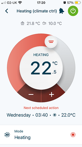

Outdoor sensor reading differently on ONECTA and heatpumpmonitor
I’ve noticed that most of the time my ONECTA reported outdoor temperature is lower than that shown on the heat pump monitor. Is this a feature ?

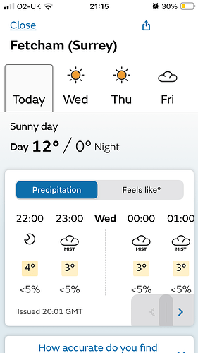

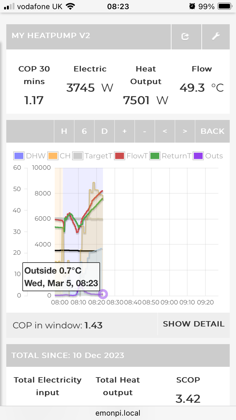

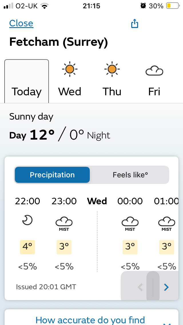

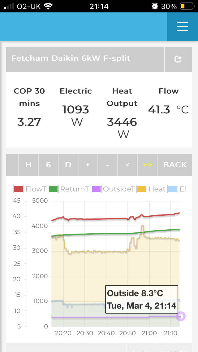

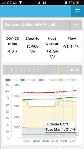

Met office figure for this area shows 4 degrees right now, I have a thermometer on top of outdoor unit reading 2.9 degrees. Heatpumpmonitor shows 8.3 !!

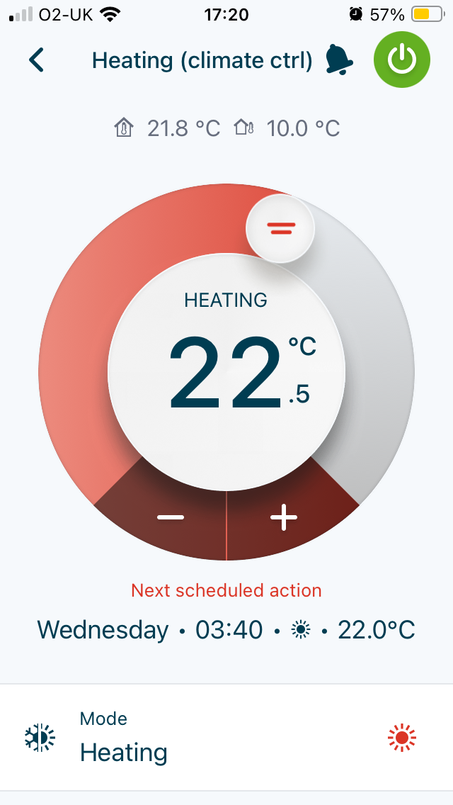

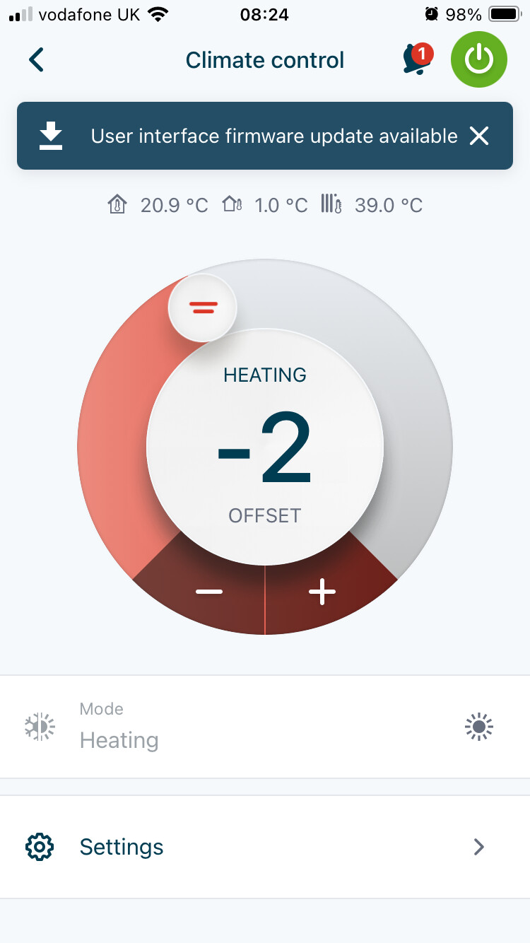

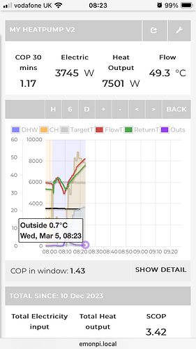

That is weird, my numbers are always close on Onecta and HPM, but that’s probably because I use ESPAltherma to collect outside temp from the HP, and send it to HPM! But they are always within rounding error - see photos.
I don’t know what HPM does if you don’t give it a number - as suggested, could be local weather station.

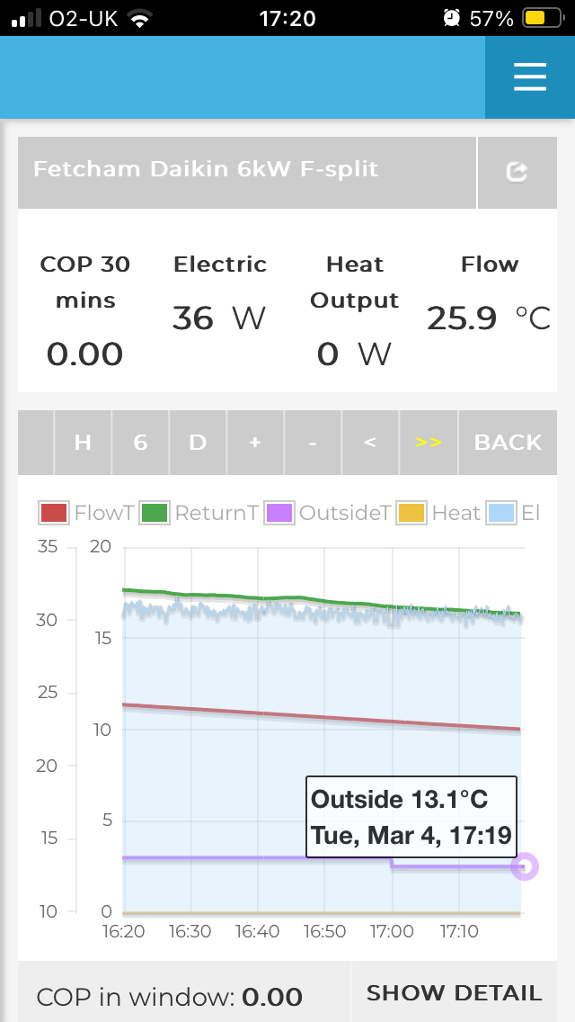

Right now the outdoor temperature is 16 according to ONECTA, 17 according to HPM and 16 according to the Met Office. That’s a whole lot better than when temperatures were much cooler. Something is not right.

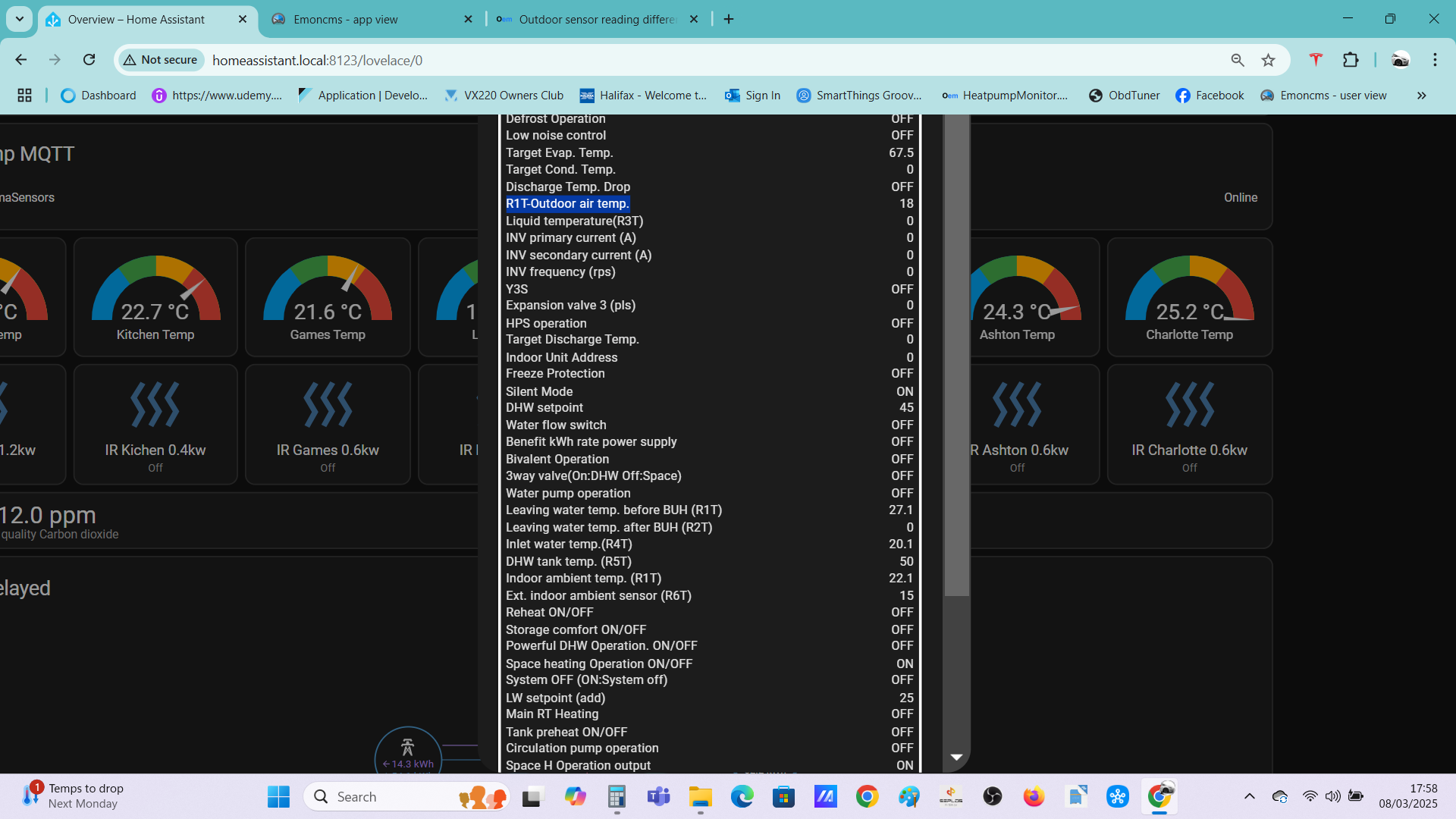

If you have the extra outside temp there are two which can be reported
R1T = which is the temp sensor on the HP
R6T = which is the sensor for the extra sensor for WC normally on north side of house , you need to switch this on in the MMI if it has not already
the names are a bit confusing
the sensor on the HP can swing very quickly with fan speed and build up of frost
I’m definitely on R6T (external sensor) in the MMI.
