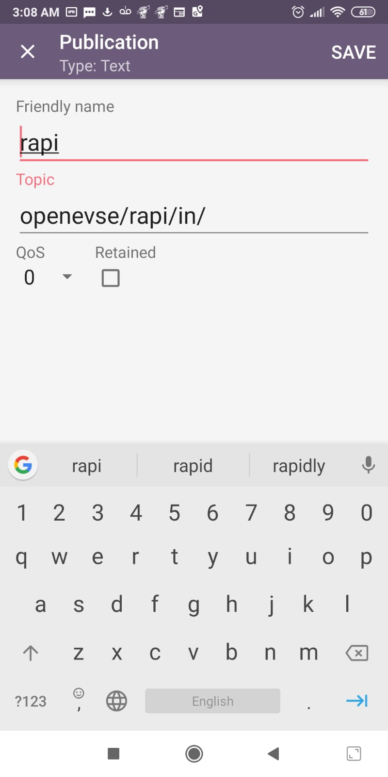

However when i send a RAPI command over mqtt such as reset, changed lcd color,
or set chargre rate, I do not see the charger performing those commands. I do see the command show up in my openevse/rapi/in suscription though.

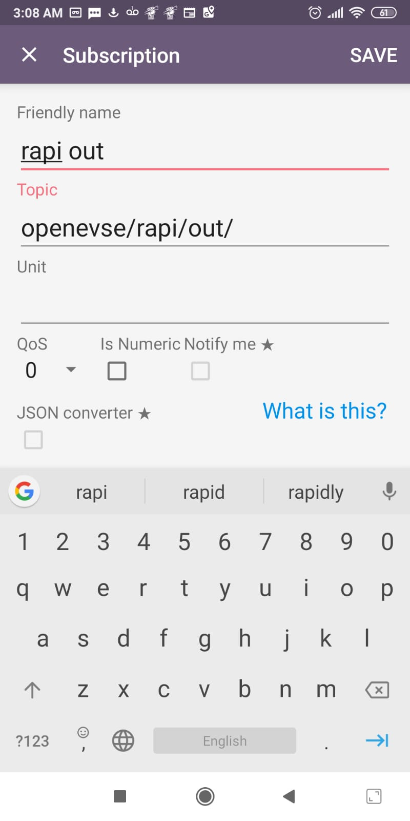

Here is the messages my mqtt client get from the suscription

“If the power is removed from the OpenEVSE I would expect it to disconnect from MQTT since the WiFi module in the OpenEVSE would not have any power and therefore not able to maintain the WiFi & MQTT connection. Is this what you mean?”
Blizzard the only mqtt msg are connect and disconected …

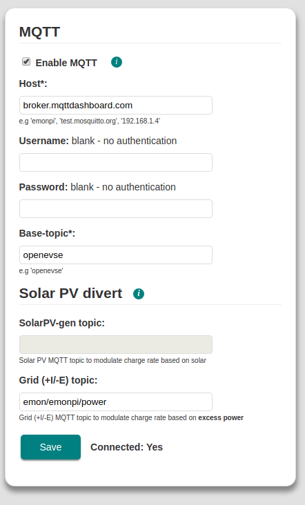

Thanks, that looks correct. Do you see “MQTT Connected: Yes” on the Services page?
Does MQTT dashboard not require a username / password?
What is the reason for using MQTT dashboard? I would recommend using local MQTT broker if possible since it’s not very secure to us an unencrypted cloud server. Do you have an emonPi? If so it has an integrated MQTT server. If not a MQTT server could be setup on a RasPi.
What is your goal with this setup? Do you want to get the data into Emoncms or do you have other uses for MQTT data?
