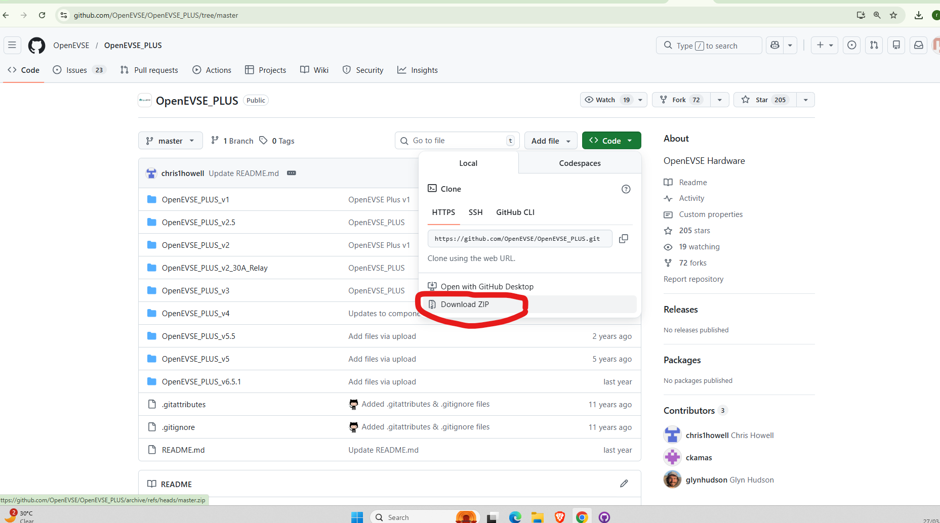

Can someone share OpenEVSE schematic. I can not open the schematic in Kicad. The pcb board is loading but the schematic sheet is empty. If someone could share a pdf version it would be helpful.
What I am doing : Downloading the zip, opening latest version and importing the sch file in kicad.
If this is not the right way pls guide me.

Openevse hardware uses Eagle CAD. If your just viewing the schematic it’s easier to to view the pdf.
Thank you. Why is 6.5.1 schematic pdf not available. Is it because it is still in designing phase?
It looks like the schematic is available, but it’s in Eagle CAD format. You could try opening a github issue to request a pdf, but you should be able to run a free trial version of Eagle CAD.

KiCad (not threatening to charge you) is able to import EagleCAD files.

Kicad imports that 6.5 schematic more or less fine, but have to recheck traces and layers.
