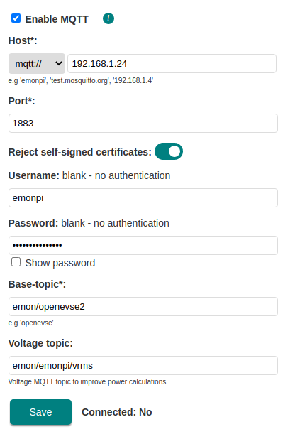

So, I got my new ESP32 WIFI today and like any crazy nerd. I just had to install it and give it a whirl. Got it connected to WIFI no problem, got it to connect to EmonCMS with no issue. Sadly though, connecting to MQTT is not working. I’m not sure what is wrong. There are some new options that weren’t in the old WIFI firmware and I’m not sure if that might be the issue or not. Here is a copy of my config.
When I click save I get this error.
@glyn.hudson
I realize I could just be screwing up the settings as well, but I went back and reused the settings I had before. So, something has changed.
Go figure. I did some more troubleshooting on it and now it’s working. Sigh…

Well, just when I think it’s all good, it’s not. So, I just had a hard drive failure on my EmonCMS and of course I failed to backup. So, rebuilding everything. I noticed when I loaded up the new emonsd and got logged in that one of my OpenEVSE’s connected just fine over MQTT and the other did not.
OpenEVSE1
OpenEVSE2
I just find it odd, same settings, no changes made and one connects and the other won’t.
I assume you have powered down the unit that does not connect.
I had the same issue with a new OpenEVSE installation. Isolated the unit for a few minutes. When I switched back on it connected.
Does Debug serial log give any information?

I haven’t tried that yet. I figure you are referring to the OpenEVSE unit. Still seems strange that one connected and the other did not. Might be a bug there with a process getting hung up on disconnect.
