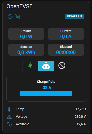

I’ve made a custom HA card for OpenEVSE integration.
You first need to install a beta version of the OpenEVSE integration
You can install the card over HACS by clicking here:
Or install it manually by following README instructions:

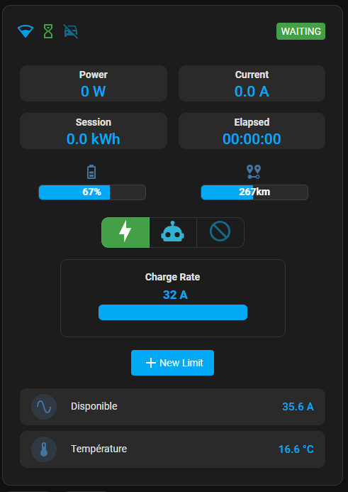

Card is working well but how can I change the colours, background etc?
So far I can only see how to set a theme for the dashboard view, but I have 3 cards on the view and want to be able to set different colours for each.
I would also like to be able to align the Name text to the right for one of them.
Any of the above possible?
it uses HA themes’ color. You still can use cardmod to change them per card then.
