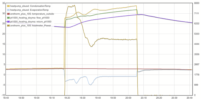

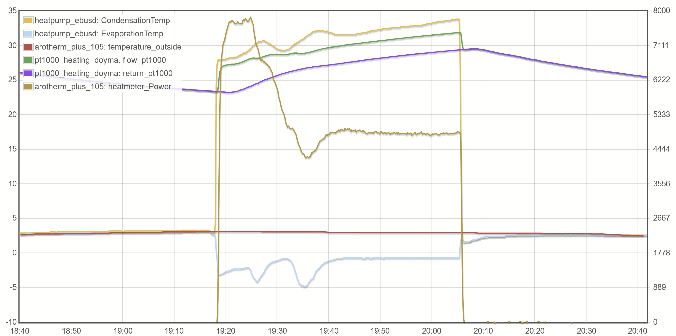

Some people have monitoring where they can see the actual evaporation/condensation temperatures (e.g. Vaillant ebus, unsure about other manufacturers) - I think it would be great to allow using those measurements for the Carnot efficiency calculation instead of the fixed offsets. This could be simply two feeds that if specified are used for the Carnot efficiency calculation, if they are left blank, the default offsets are used. For example, I’m getting this:
With the usual Vaillant sensor shenanigans, I shifted evaporation/condensation temperatures by -0.5K and +1K so they collapse to the same temperature (=outside temperature) between cycles. As can be seen there’s quite some transient behaviour in the beginning. Condensation goes toward +2K of flow temperature as the cycle stabilizes, the evaporation temperature is around 3.7K lower than ambient.
