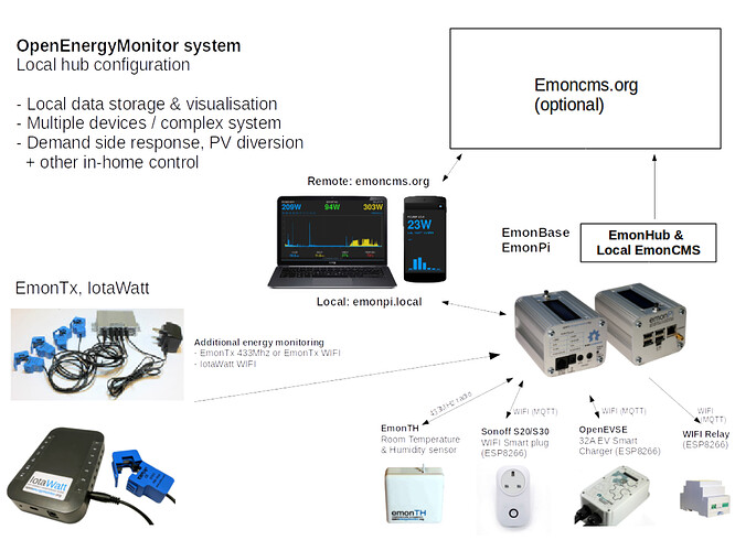

Glyn and I then gave a short presentation of where we see the core OpenEnergyMonitor system going. We see there being two key configurations that we would like to support:
  1. The local hub configuration
  2. Lightweight local & remote data logging
The local hub system comes into its own where a setup consisting of a number of different sensor nodes and potentially control nodes are required, e.g: EmonTH temperature and humidity nodes in each room, Household, solar, sub-circuit electricity monitoring (EmonTx WIFI or RFM, IotaWatt) heat pump or heating system heat monitoring.
@glyn.hudson has been working on integrating solar pv monitoring with the OpenEVSE electric vehicle charge controller using the mosquito MQTT broker on the EmonPi/EmonBase. I have been working on Sonoff S20 smart plug scheduling for the EnergyLocal project, local decision making and coordination provided by an in-home hub is needed to provide a resilient system for situations where the internet connection goes down.
Another key benefit of the in-home hub configuration is local data storage and visualisation (which may become a more important benefit as remote server costs are factored in, see emoncms.org billing and scale).
A local hub, such as the EmonBase/EmonPi, runs a full emoncms stack locally as well as tools such as OpenHAB and NodeRed, which can be used for control applications. A hub may integrate with a complete mixture of devices/equipment including smart meter interfaces, inverters, heat meters etc.
