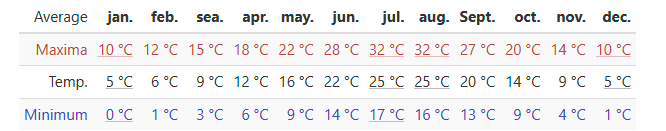

Hey,
I would say we have shorter and warmer winters than the UK, yes. We also usually have a bigger difference between day and night, which allows a bit of tinkering:
Above is average data these past years.
I have the HW in re-heat mode, at 50ÂșC and with a hysteresis of 20 degrees. It does HW twice or 3 times a day, depending. I played at the start with schedules etc but it is too much of a hassle.

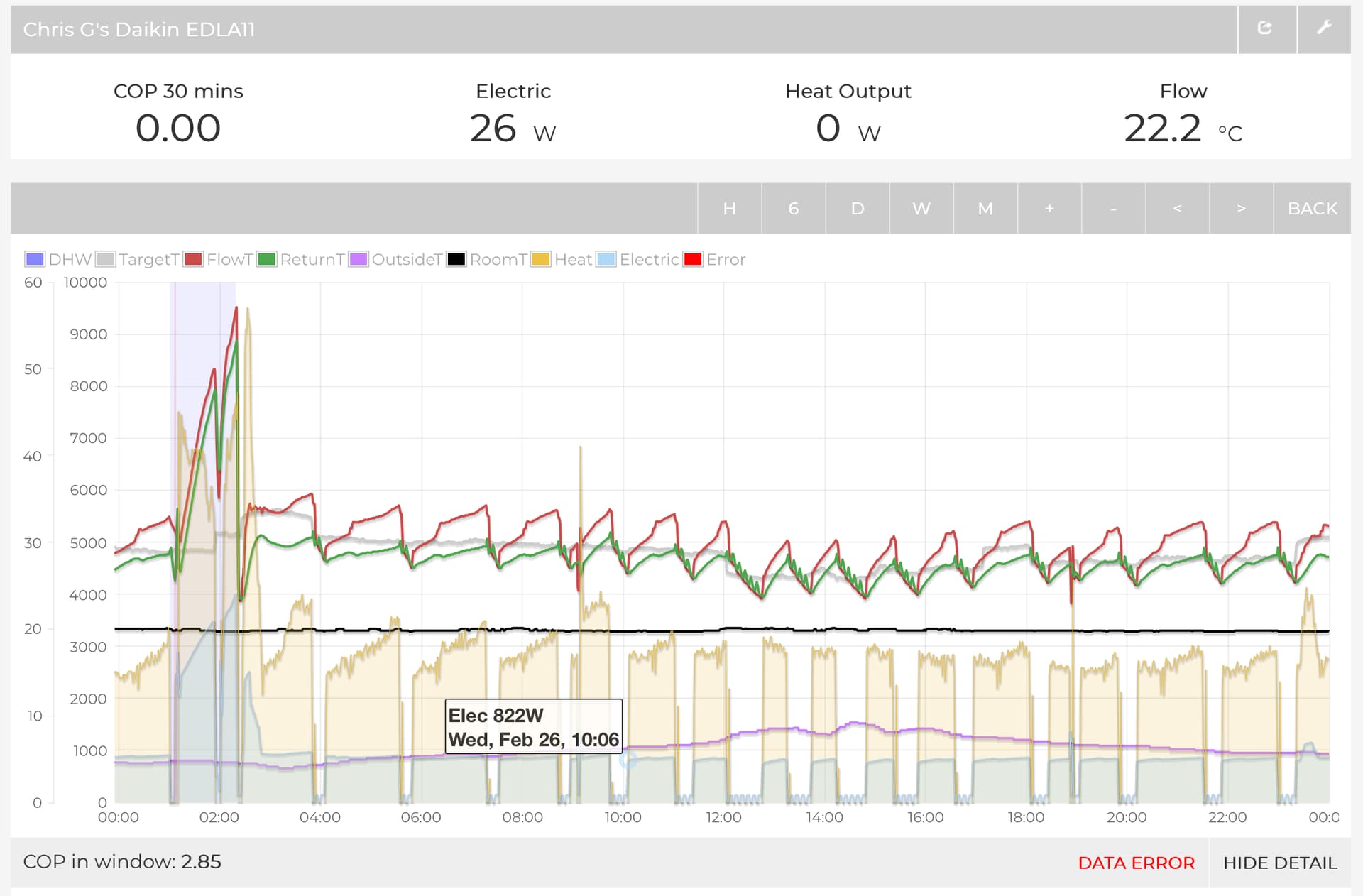

I agree that you shouldn’t have to do anything, your HP should just be plug and play, period.
The theory is great, and if that was the control system in use then it probably would work great, exactly as you say.
Unfortunately that isn’t how Daikin implement their control system. As RWT rises above target the heat pump compressor modulates lower and lower, eventually when it can’t module any lower and RWT still rises then the heat pump compressor cuts off, so far so good. It then waits for the RWT to drop a few degrees, but nowhere near as many as 10 (and I think a minimum fixed time of 4-5 mins). Then, and here’s the problem, it decides that the RWT is now too cold and needs to be heated up. But instead of coming back on at minimum modulation (after all it only cut out a few mins ago because it couldn’t modulate low enough) instead it decides that the water temp is too low, needs heating, and sets about doing it as quickly as possible, heading towards maximum compressor power within the first minute or two of operation. This obviously massively overshoots the desired temperature, the compressor cuts out, and the cycle repeats.
What you end up with is the ASHP running for a couple of mins, at high power, followed by a few minutes off. It can easily cycle 6 or 7 times an hour. During this time all control over average LWT is lost and you end up with a different average heating output to what it was just before it dropped below minimum continuous running, alongside the efficiency loss of rapid cycling. This happens when outside temperature is relatively high, therefore house heat loss relatively low. A fairly small absolute variance in the heat being delivered to the house can now have quite a big effect on internal temperature.
Changing to use Madoka modulation (and ignoring the target LWT modulation this brings) fundamentally changes the compressor control algorithm. The compressor comes back on more gently than full power in a cycling scenario, but it still ramps towards around 50% power rather than the minimum power that would be far more appropriate under the circumstances.
I know that there are many more variables in the control algorithm we don’t have visibility of and running a compressor probably isn’t as simple as just turning back on at minimum power but the Daikin control seems woefully simplistic once it enters into required cycling.

I have ours in LWT mode and it does cycle because it’s oversized massively. But, it doesn’t come on full pelt after the compressor stops for a short while. Here’s an example day from Feb this year:
After a defrost, yes it goes a bit nuts, but that’s a whole other issue.
