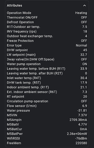

Looking at inputs on the screenshot, you appear to have a lot more than me.
I have the emonscms HP, do you have a different version or paid for more feeds?
My electrical input power is coming from a Shelly CT clamp on the heat pump electrical feed.
Which goes via Home assistant, where I also collect data from ESPAltherma.
So I created feeds for the Home assistant data I wanted to see in emoncms/heat pump monitor.
I could for example, add feeds for my solar inverter or just about any other sensor I want to visualise in emoncms.
If you’re using the standard OEM Heat Pump monitoring equipment, those are the feeds it provides. Many people are using non-OEM instrumentation I.e. ESPAltherma, a microcontroller wired into the HP, or a similar device wired into the MMI interface feed P1/P2. These provide lots of internal HP data from its own sensors. You could use both OEM and one of those if you liked.
