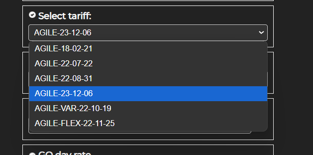

Unfortunately, without touching anything, it has suddenly stopped showing the agile tariff information. To be precise at 10:59 01/01/2025.
It seems to be doing everything else correctly.
Any ideas what is going on?

Is it working again now? I see this right now on mine:
Hi Trystan,
Not it’s still not working, I’ve got this:

Which specific tariff have you selected?
I see that AGILE-FLEX-22-11-25 and AGILE-VAR-22-10-19 feeds have not updated since 7 days ago.
I’ve got AGILE-VAR-22-11-25 selected. Has this now expired?
If I chose another tariff the line reappears.
Yes, it seems that Octopus is no longer publishing prices for that tariff, and it’s likely that you have been migrated onto a later one. Login to your account and check which tariff you’re actually on now.
This is the one I’m now on. @TrystanLea - can you add this to the app? (Posted this on another thread, but realise this one is more relavant!)
AGILE-24-10-01
Yes sure, will get this added

Support for this now added :+1:
Hi Trystan,
I still can’t see it in the App list…
Is this on emoncms.org or a private instance?
If not the public website, you’ll need to update the App module. Check Admin → Components.
This is on the public emoncms.org
Apologies it’s now on emoncms.org as well
