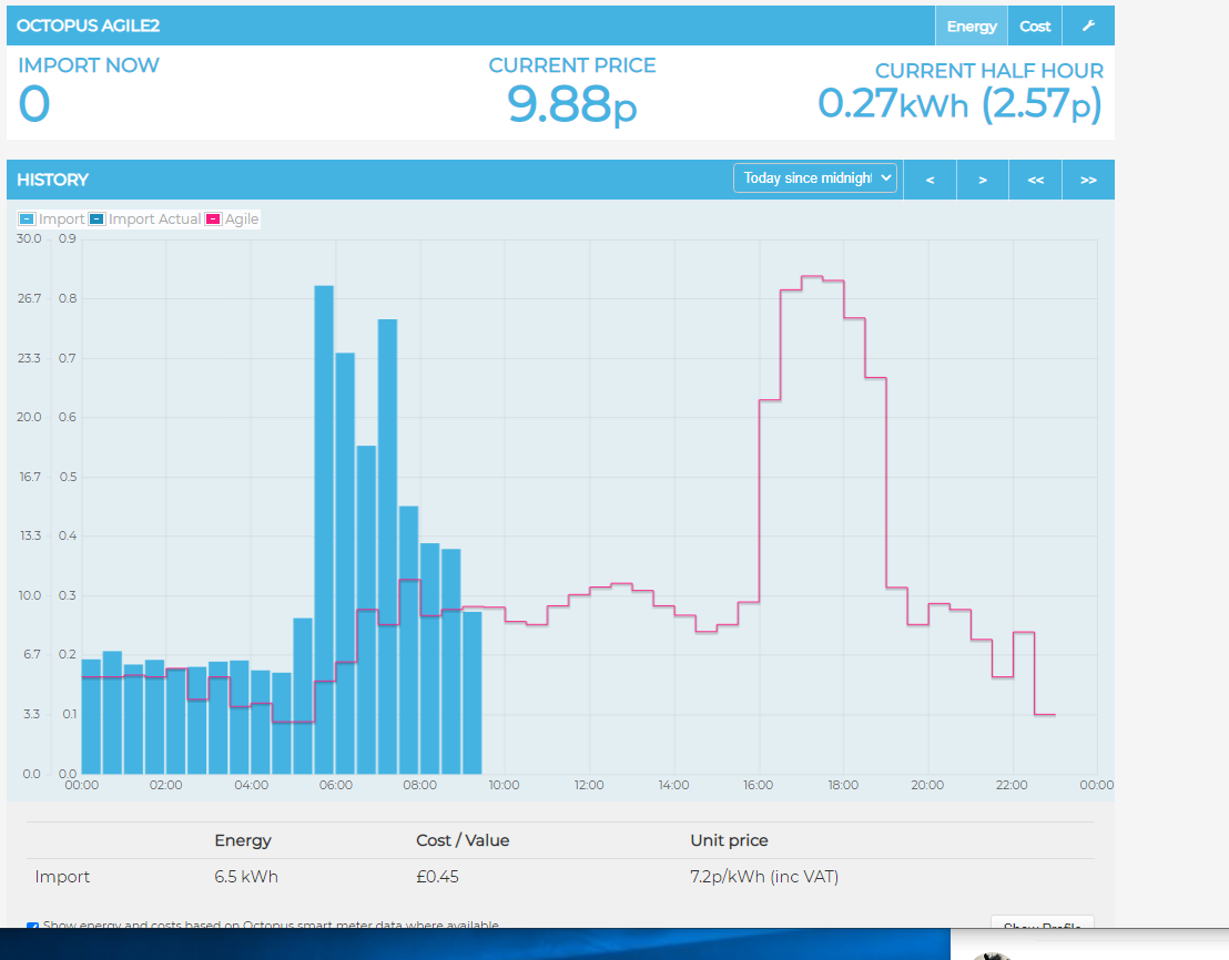

@TrystanLea - I have just invested in a QHD monitor and the Agile graphs do not adjust correctly.
Seems there is no maximum height for the chart, it just uses a % of the available area and always hides the bit at the bottom therefore. The width seems to be fixed as well.
Could you also investigate a means of exporting the half hour totals as CSV please?

Could you fix the graph scaling? On UHD monitors the graph is terrible (fills the page) and you always have to scroll to get the detail at the bottom.
