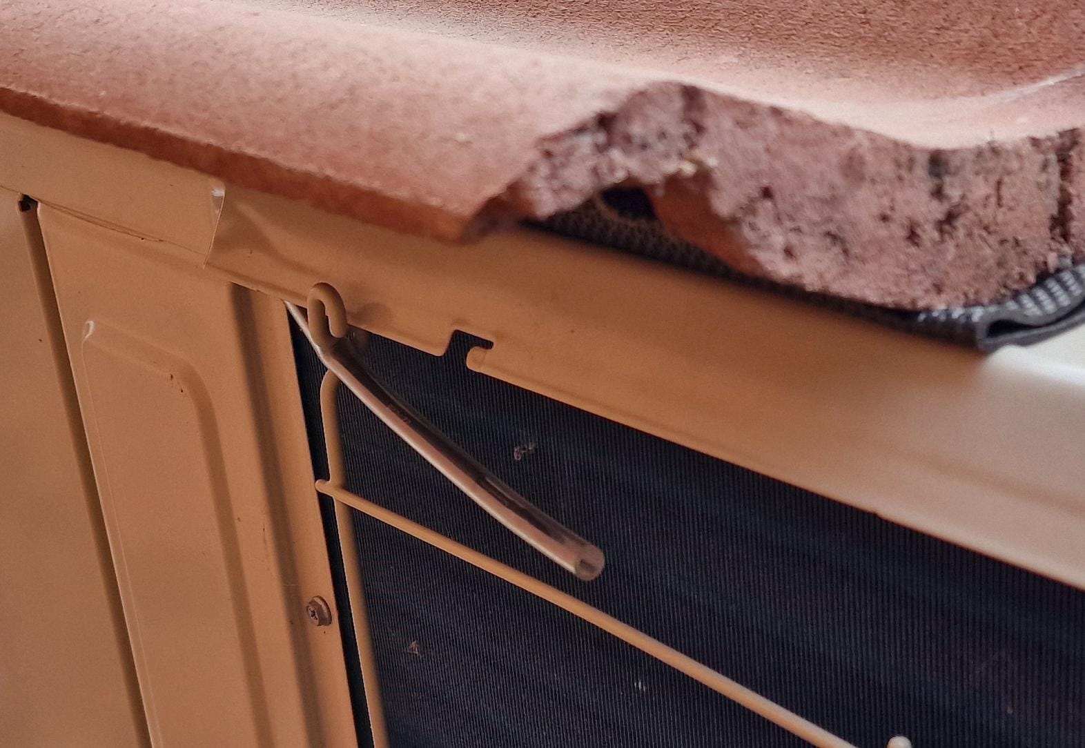

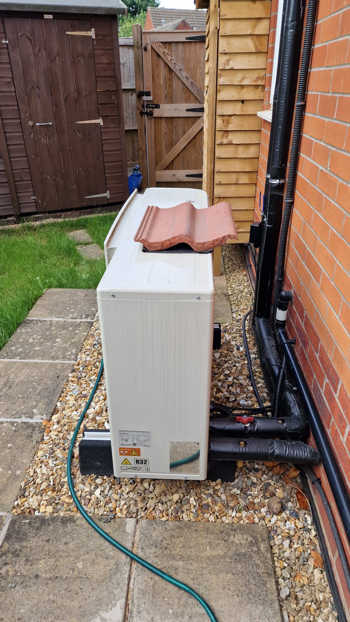

I have a Daikin EDLA 4kw. It sits against the west wall of my house, and there’s a remote thermostat on the north wall out of the sun. I can confirm that if the unit decides it’s too hot, it’ll refuse to run the DHW cycle. More insanely, even though my unit is set to use the remote sensor to determine the external temperature (and does for weather compensation), it’s the sensor on the unit itself that’s used to determine whether it’s too warm to run. I think the cutoff was about 30°C, but I can’t be sure. The sensor on the unit is on the back in a plastic tube, and at certain points of the day during the summer last year it was in direct sunshine, and way hotter than the ambient air temperature. I sat a roof tile over it to give it some shade, and hey presto, hot water. Madness.
